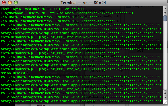

I have been trying terminal commands on the .trashes file on my external drive, along with the trash on my mac
when i try to rm -rf the backups.backupdb without the date i get this
rm: /Volumes/TimeMachineDrive/.Trashes/501/Backups.backupdb/ClayMacbook/2008-03-11-215622.inProgress/3F469799-2098-4F5A-A586-83600F477060/Macintosh HD/Users/claysandefur/Documents: Permission denied
everything it tries to delete it says permission denied. Note that this is not the only thing that came back when i typed the command in, i just copied
one of them.
i get the same thing with -rfv.
When i try to rm -rfv on the 501 file in .trashes (where all of those files are located. I get the same stuff, Permission denied on each file terminal tries to delete.

the last attachment is the permission denied stuff.

prefix rm -rf with sudo. It will remove the permission denied errors you keep getting, and will delete the items forever.
Also, the dots symbolize the folder itself and the folder one level up from the current folder. The single . symbolizes the very folder youre in, two dots (..) symbolize the folder the current folder is in.

Yes you did answer my questions. We found the real location of the bad files, they were hiding, as expected, in /Volumes/TimeMachineDrive/.Trashes/
Try sudo rm -rfv /Volumes/TimeMachineDrive/.Trashes/
It will prompt you for your administrator's password, then run the command as root. I've never met a file that a sudo'd rm couldn't remove. Good luck! 🙂
Thanks guys
The nightmare is over. Last night i sudo rm the 501 folder in my hidden .Trashes folder on my drive. They are gone from my drive, and from my trash. And now i feel right about how much space stuff is taking up on my external drive.
