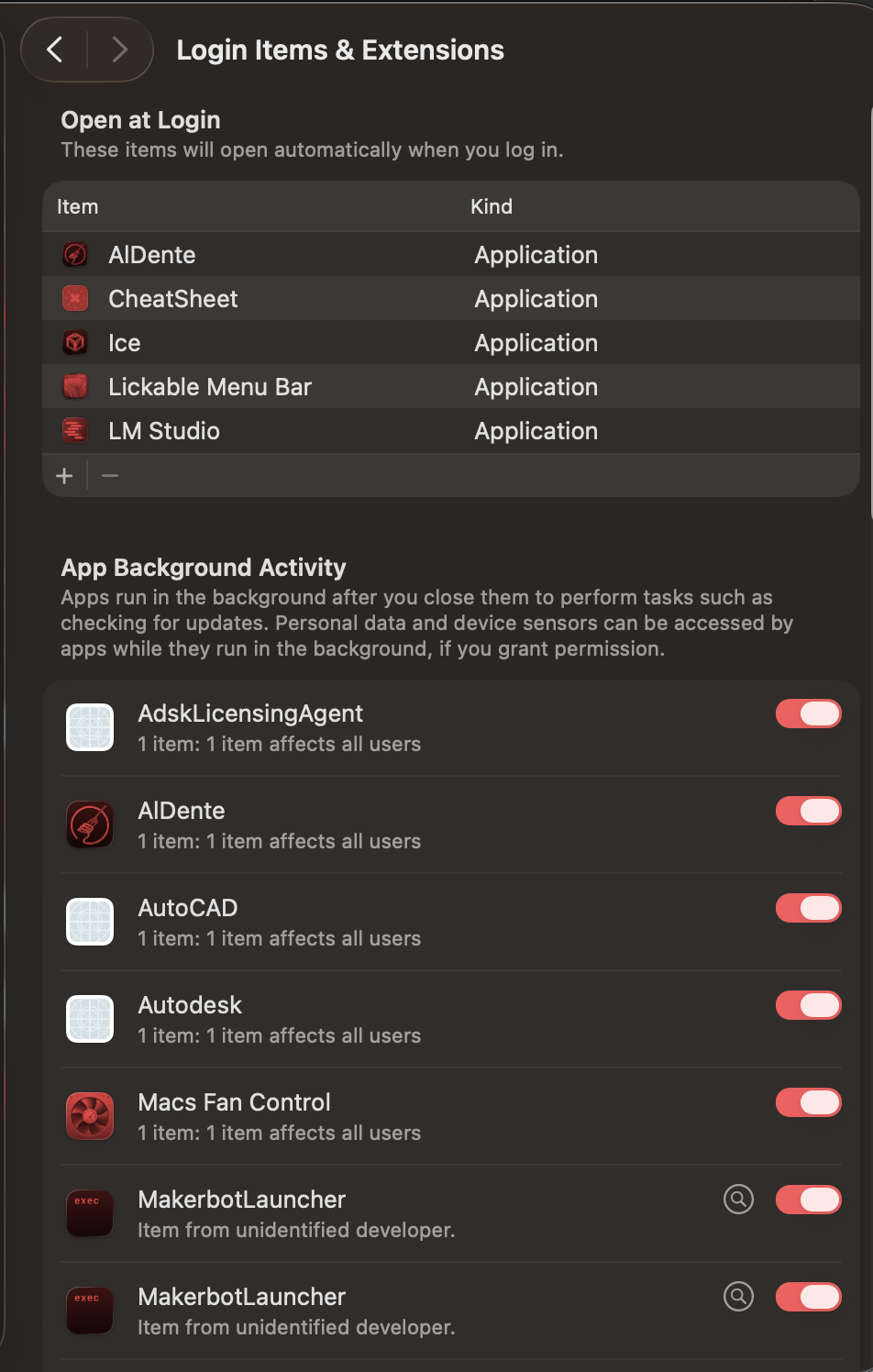

Did you check for any login items that are supposed to open or run at startup? If so, turn them off. Go to System Settings > General > Login Items and Extensions.
it look like this:
use the minus button to eliminate them all.
Here’s a link to the Apple support guide on removing login items and resolving startup problems:
