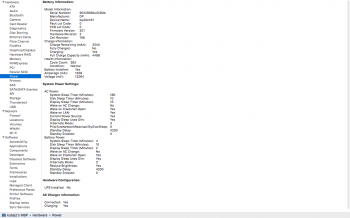

Here's my battery status if it went down again

Going from 100% to 65% suddenly suggests other trouble, though, and so does the message you got that the battery is failing. However, your screenshot shows the battery to be healthy. Bad charger connections can accelerate the decline of a battery.
