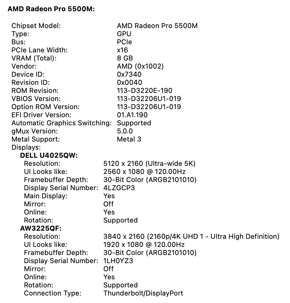

Yes, they both support it.
And strangely, my 2019 Intel MacBook Pro with Radeon Pro 5500M graphics supports both displays at >60 Hz just fine at the same time.
When at "native resolution / 2x Retina", I can get 120 Hz on both:

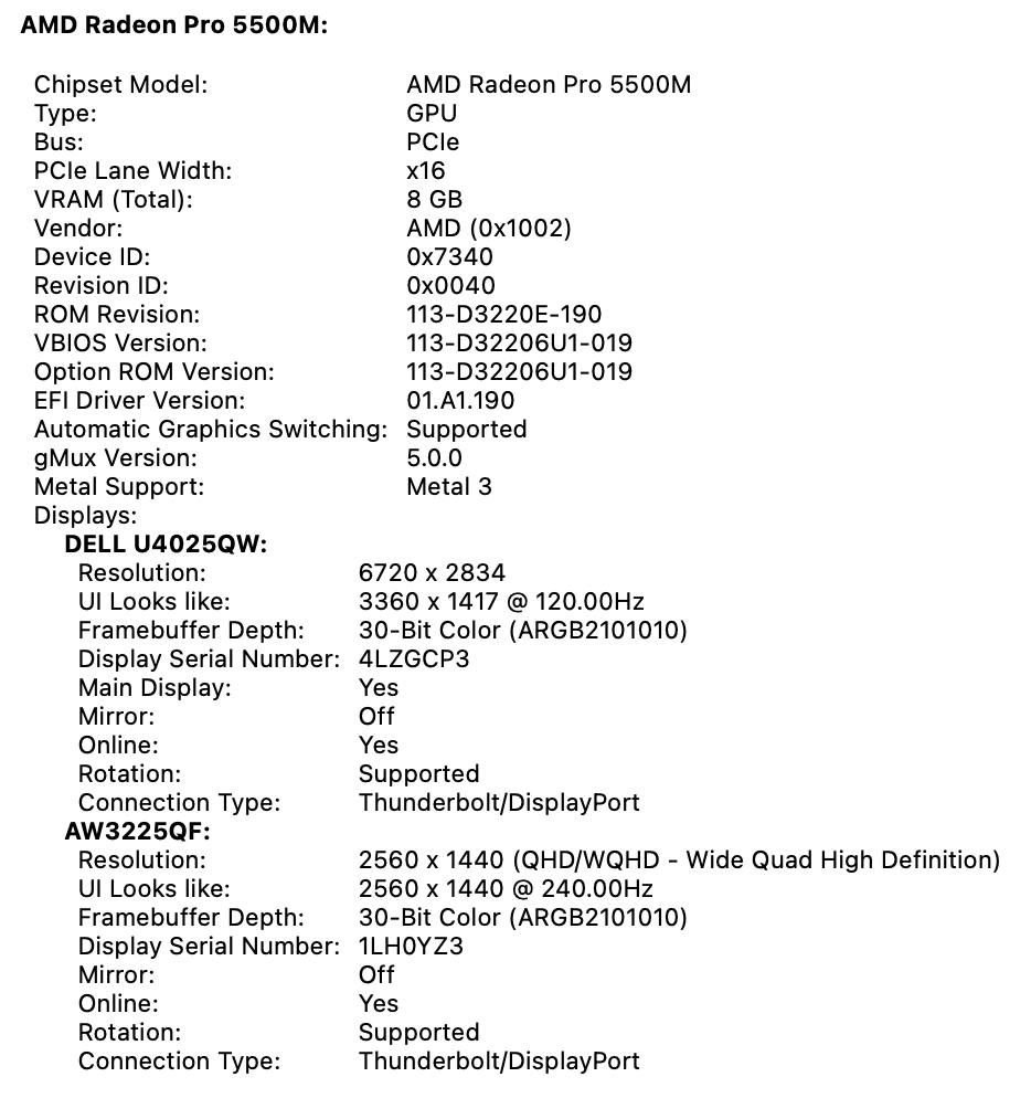

When I switch the 4K AW3225QF to "low-resolution" 1440p, it can do 240 Hz (I also switched the 5K ultra wide to a retina 'looks like' similar🙂

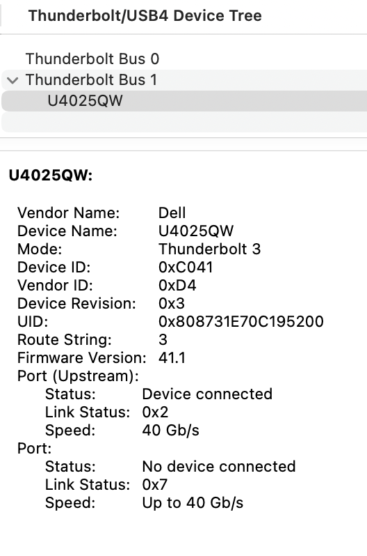

And yes, the 5K is connected via Thunderbolt, same as when it is plugged in to my Apple Silicon Studio:
