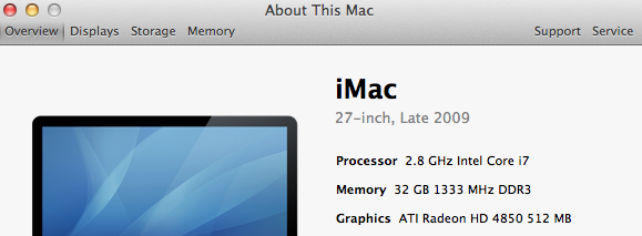

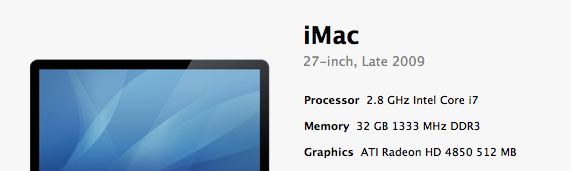

Yes, 32GB works just fine in a 2009 27" Quad i7. Will even run at 1333MHz instead of 1066MHz.

(I cut off the screen capture to leave out my serial number.)

Wow, that's exactly what I was looking for! I think the reason I was asking was because I couldn't find any 8GB 1067MHz SODIMMs so I was wondering if I could get the 8GB 1333MHz SODIMMs to work in my 2009 27" iMac. What configuration is are the SODIMMs? i.e. what gigabit chips or arrangement, if that matters?
I know people have been doing that with the 2010 and later model iMacs. But, this is the first nice confirmation I've seen for a late 2009 iMac with 32 GB of RAM. Thanks!

It identifies the memory modules properly at 1.33 GHz, that doesn't mean they're actually running that fast (they're not).
Just like with every other computer in history, you can run faster RAM of the same type, but it'll run at the same speed as the memory controller.

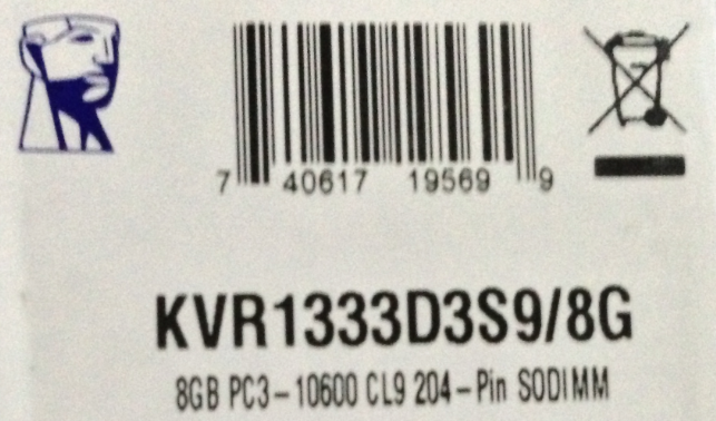

You can consider using Kingston RAM
Hi

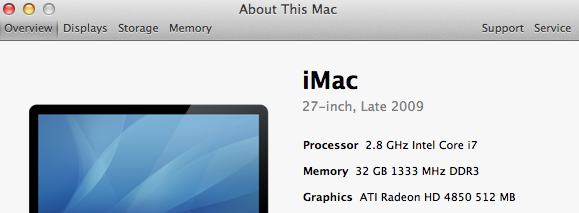

I am running on the following Kingston RAM at 1333mhz , tested with Rember app , 100% error free .
