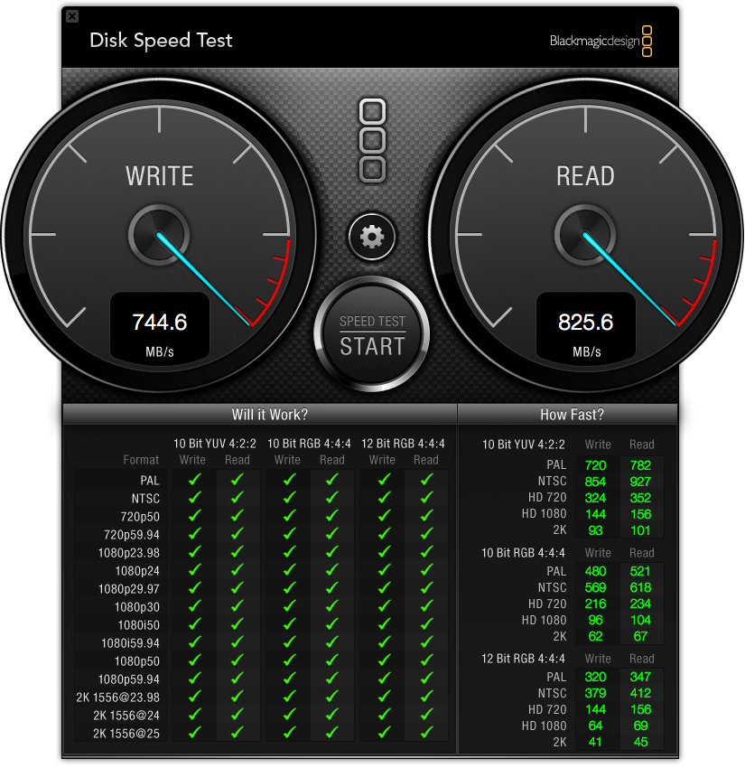

Although I am running a fusion drive now, I had very good results running a raid0 pair of Samsung 830 pros in my 2011 server. I dont see how reliability is a problem with modern ssd's combined with time machine backups and an off site clone.
I will say the biggest problem i had was that OSX did not pass trim commands to raided ssd's. I built my raid pair using a third party application called Softraid... which is expensive to buy but allows you to to build volumes with the demo, so that you have a trim enabled raid pair even after the demo times out.
I will say it was a strange experience dealing with the issue of trim in a raid volume. At the time people ignored it or said it couldnt be handled, so it was a pain to find the Softraid program. I would be interested to know if Mavericks handles trim to raid natively now, but even so Softraid was a pretty good disk utility suite.

Is that image you attached the performance you saw with your RAID 0 setup?

yes, that is my 2011 mini server (quad 2.0) with the raided pair of Samsung 830 pros. I went back in and changed it to a fusion drive with a 256 Samsung 840 Evo and a 1tb hd. I get similar performance and size on my MacbookPro as the raided pair so the Mini is back to being more of a server these days.
