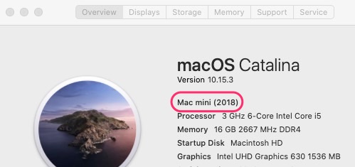

The so-called "New" Mac mini with a price adjustment for double the storage for the base prices was announced available on March 18. I purchased a "New" Mac mini from the Apple online store on March 22 that was delivered March 30.
"About This Mac" shows "Mac mini (2018)".
If you choose to believe articles on the internet written by people that are trying to make money with getting people to read their "click bait" titled articles then enjoy.
I actually have a "New" Mac mini and there is nothing showing 2020.

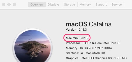

That's a defect in the OS.
