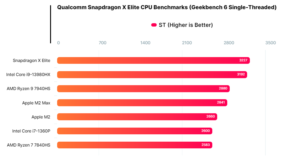

Yesterday, Qualcomm announced the Snapdragon X Elite SoC to compete with Apple's upcoming M3 processors.
In their presentation they had this slide:
Qualcomm is claiming their new SoC has has a Geekbench single core score of 3227. Now compare that with the estimates that I had previously generated:
SoC​
Geekbench Single Core Score​
M33333
M3 Pro3398
M3 Max3457
M3 Ultra3482
The M3 Geekbench single core scores are 3-8% higher than that of Qualcomm's SoC.
I would expect the M3 processors to be at least as fast as Qualcomm's chip, but more likely, slightly faster, which the generated data shows.
Again i would take that chart slighty different for the final product
Because when i bought windows 10/11 on arm always, but every time the event charts were off by at least by 14-16%
So i would not be surprised if an surface or dell laptop will have in GB6 even 3000 score
But bottom line i think there is no chance that M3 family to score less than 3100
The most probable scenario is that the pro and max version will come before the base version. If what we get is any close to expectations, the M3 base is going to be more powerful in non-crazy-multicore and non-high-gpu related tasks compared to M2 pro, which would mean that the (more expensive) M2 pro models would be pointless to keep selling right now. Moreover, I remember reading that M3 pro/max have been actually ahead in the production/testing phase than base M3 [citation missing right now though]. And in any case, the difference between base and pro versions in performance has almost only been about core count and throttling in sustained load based on presence of fans, and in M2 versions some really tiny overclocking and power management between different versions. In single core performance there is almost no difference really.

Meanwhile the Snapdragon X Elite GPU is only doing 4.6 TFlops or 1/3rd of the M2 Max at 13.6 TFlops.
They aren't targeted at the same market anyway. It's a long way ahead for Windows applications until they offer a native Aarch64 port as well.

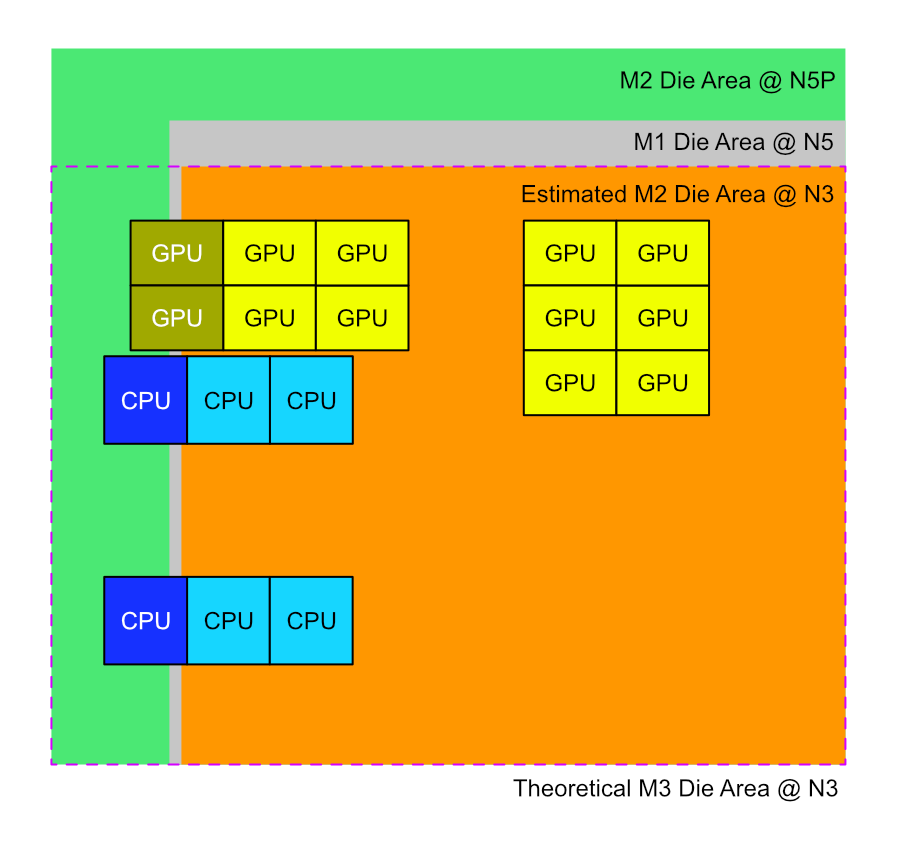

Now, is it possible that the M3 Max could have 12P+4E? That would mean the M3 would have 6P+4E.
Here is a block diagram showing the relative die areas between the M1, M2 and the M2 if it was scaled down using the N3 process:
Based on the diagram, 2 CPU P-cores and 2 GPU cores could be added if you allow the theoretical M3 die to have about the same width as the M2 die.
The consequence of the M3 Max having 4 additional P-cores means that it would be in i9-13900KS/M2 Ultra territory in terms of multi-core performance, which feels a bit ridiculous considering the M2 Max is currently 20% slower then the M1 Ultra.
However, Intel's upcoming Meteor Lake will have up to 6 P-cores, so who knows, maybe the 12P+4E prediction will be correct.
