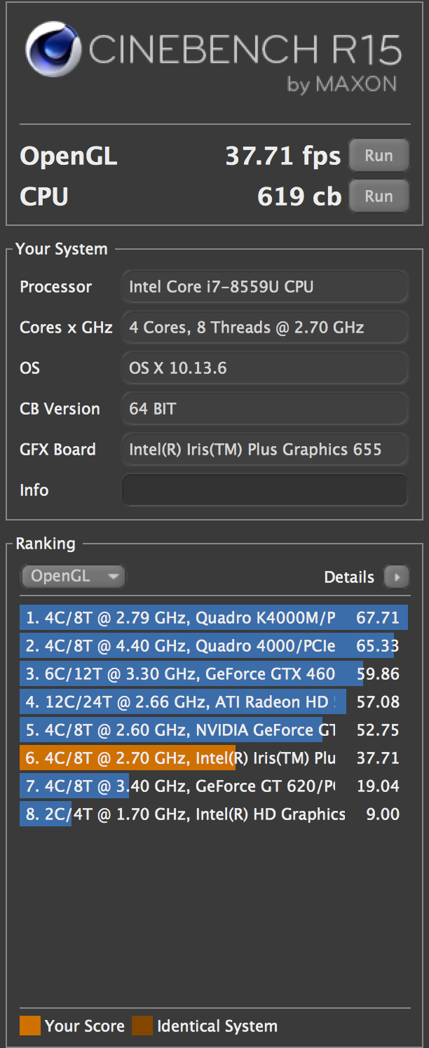

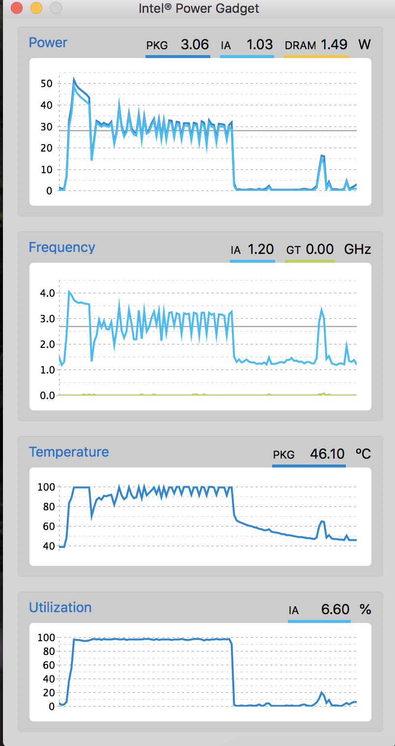

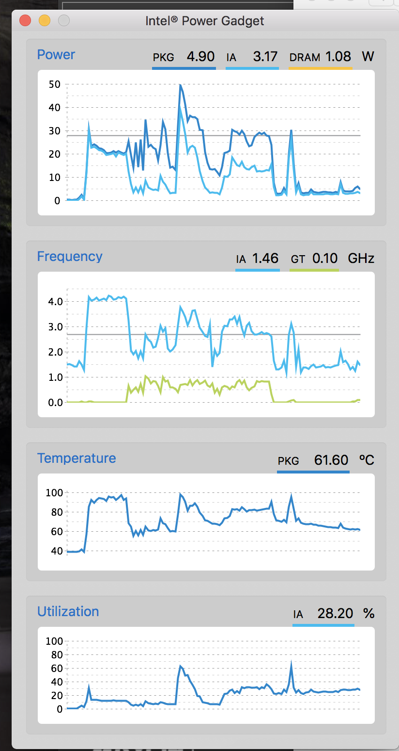

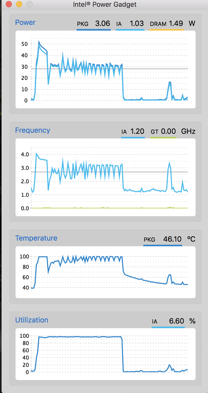

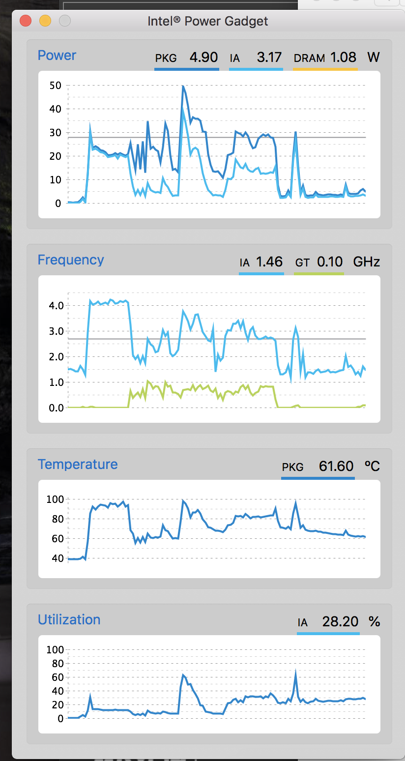

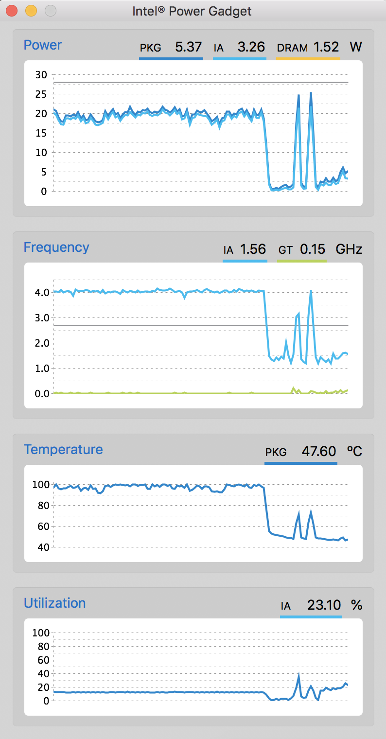

OK! Here's my results for the i7 13" MBP.
OpenGL score of 37.71 FPS
CPU score of 619
I'm not sure how to run single core? Don't see an option for it.
Enclosed is my Intel Power Gadget info during those tests as well. Briefly turbo clocked to max speed, then it looks like during the CPU test I still averaged a little over 3GHz across the entire test, so still above base clock speed. Pretty encouraging results honestly. The system did get to about 100 C internally, but never felt too hot on the outside and cooled very rapidly once the fans kicked in.
EDIT: figured out how to set to single thread, scored 168. Interestingly, for that test my CPU frequency sat at a consistent 4 ghz, with power draw between 20-25. The fans did kick in, but it looks like for single core tasks the CPU can hold its turbo speed, so it's the multicore stuff that heats it up too much.

Thanks mikethebigo for doing theses tests. Though it is somewhat encouraging that the i7 beat the i5 in each test it is still disappointing overall. Comparing your IPG i7 graph with the i5, it is clear the i7 is throttling more. The standard cpu score increase was less than 2% over the i5. Not only that, but the Dell XPS 13" which is using a slower 15W processor still beat the i7 (639). I Would love to know how much increasing the fans would help the i7. If you're willing, you can download the fan control application, and set the fans to max and redo the tests. I have a feeling the cpu score would improve quite nicely. Thanks again.

Honestly under load I don't know why the i7 would throttle any more than the i5. They are identical processors other than the GPU being slightly clocked higher and it having a tiny bit more L3 cache. Neither processor is hitting sustained maximum turbo speeds, so they should sit right at the same average together. I did look at another post that showed their i5 performance and it did seem to fluctuate right around the same average (around 3GHz). Could you maybe link to what you're looking at that looks better?
I will try to do it again with the fans a bit later.

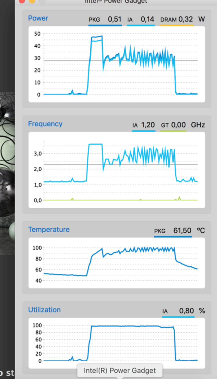

When I say throttle, I'm talking in reference to the Base clock speed. The i5 is 2.3 GHz and the i7 is 2.7GHz. The i5 can maintain it's base clock speed under load (actually even higher) while the i7 struggles to maintain it's base clock speed. Essentially, both the i7 and i5 are running at the same speed under load, even though the i7 should be 0.4 GHz faster. Here is the graph from notebookcheck. Notice how the frequency of the i5 stays above the base clock speed of 2.3GHz. Your i7 graph shows the frequency constantly dipping below the base clock speed of 2.7GHz. As it stands right now, spending the extra money for the i7 is a waste when it comes to workloads that max out the processors; but there is value in terms of the iGPU, single core tasks, and burst speeds. With the fans on max, I'm hoping the i7 graph will show speeds above the base clock.
Yeah so basically they're showing same performance under load, instead of the i7 being a little faster under load which you would expect without thermal issues. But, like you said, the i7 will burst faster than the i5, and will show a few more FPS in synthetic graphic benchmarks lol.
