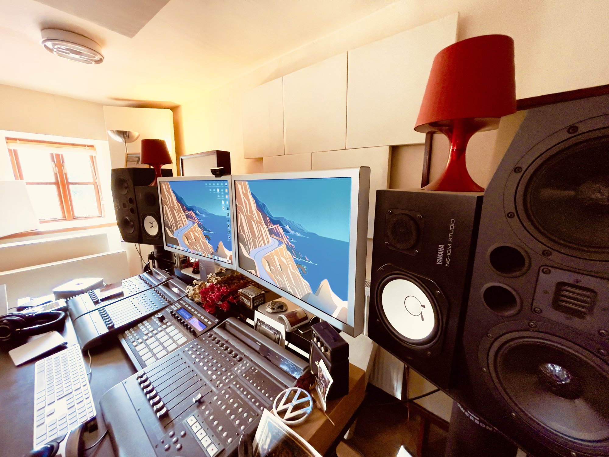

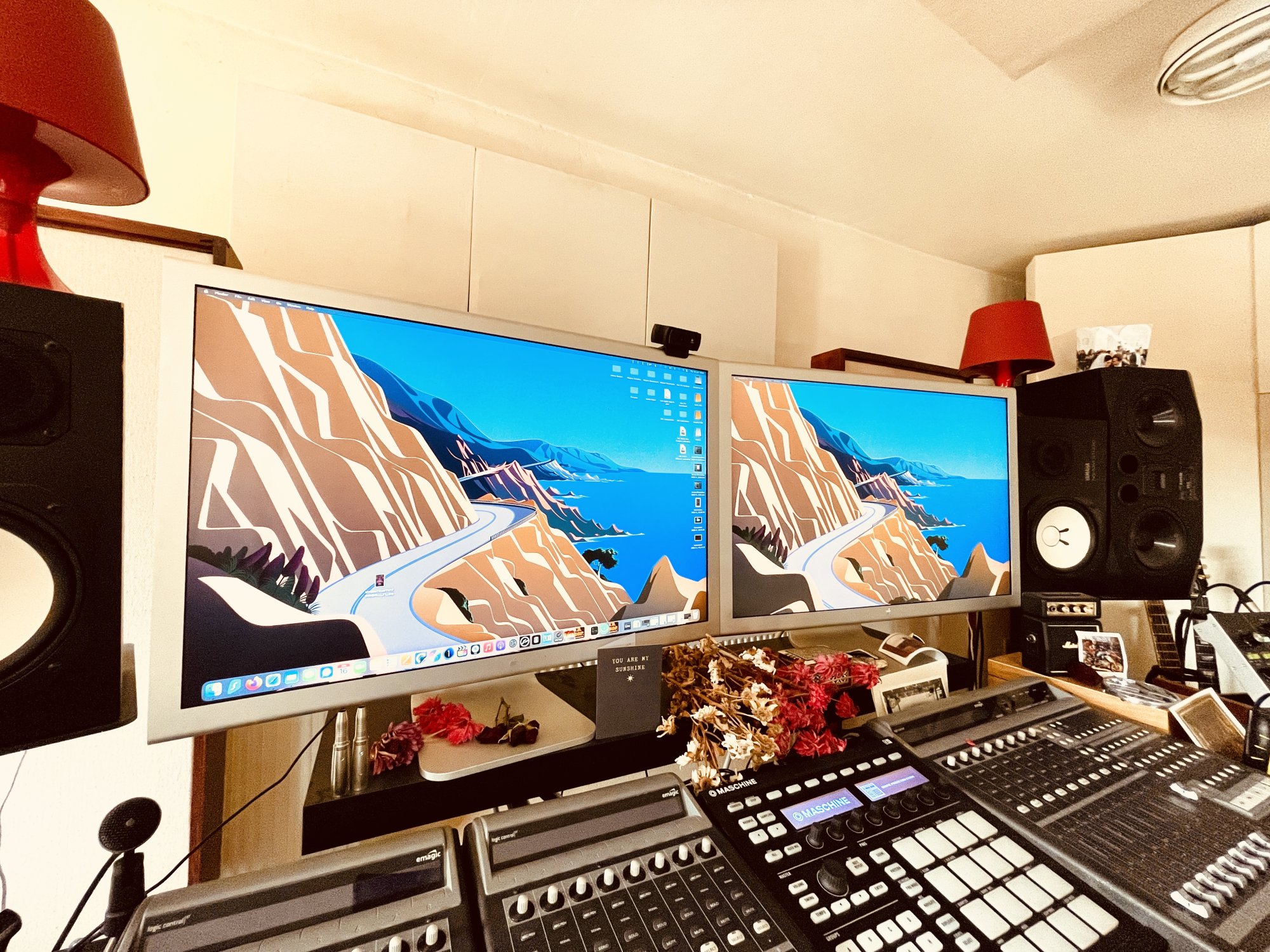

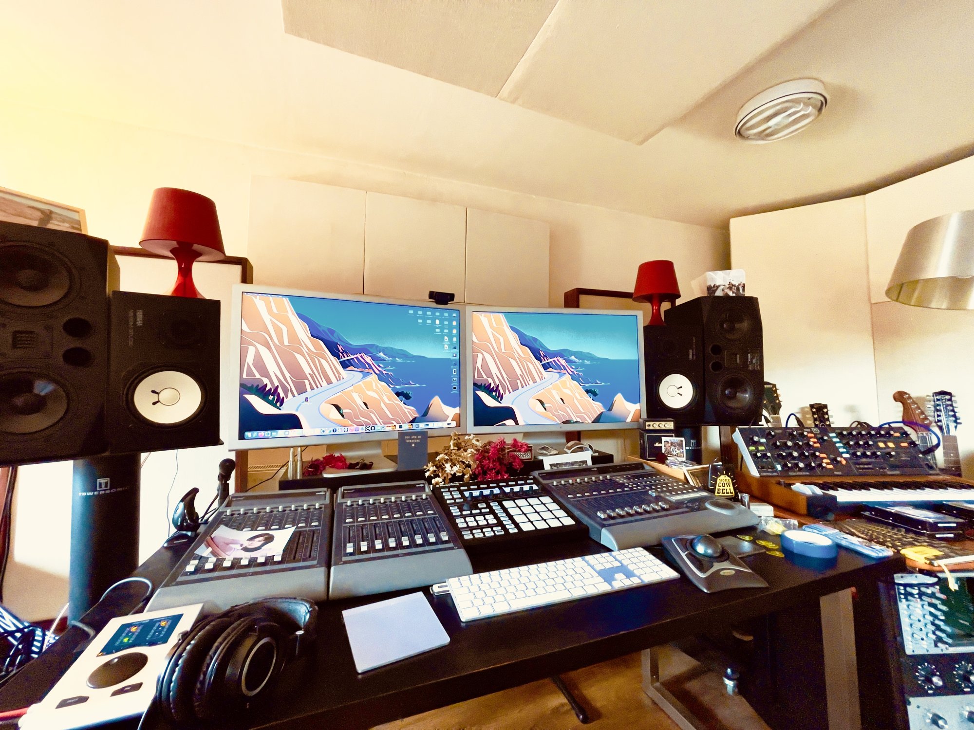

After a rocky start, I'm using the CableCreation adaptor on my second monitor, seemingly without issue. I haven't noticed any tearing or dancing pixels on dark shades.
I had a lot of initial problems when the USB was connected, and then using MonitorControl seemingly made macOS throw a fit and both monitors were running at 1024 res until I powered everything off and turned the switch off at the mains...
Having only 2 USB-A ports on the Studio is a bit annoying as they're now both being taken up by the ACDs. I think plugging them into a hub can be an issue, but I'm going to experiment more with that.
I'm still having lots of issues with brightness controls (MonitorControl) app. Sometimes it simply doesn't boot up on launch, and won't launch on multiple restarts.
I will be using my old Syder4 to calibrate them with DisplayCAL, but for now I've brought over my old Mojave calibrations. One of them is very orange/yellow, so needs a heavy calibration to appear white, and loses a fair bit of brightness (needs to be run on max).
Anyway, will report back soon...

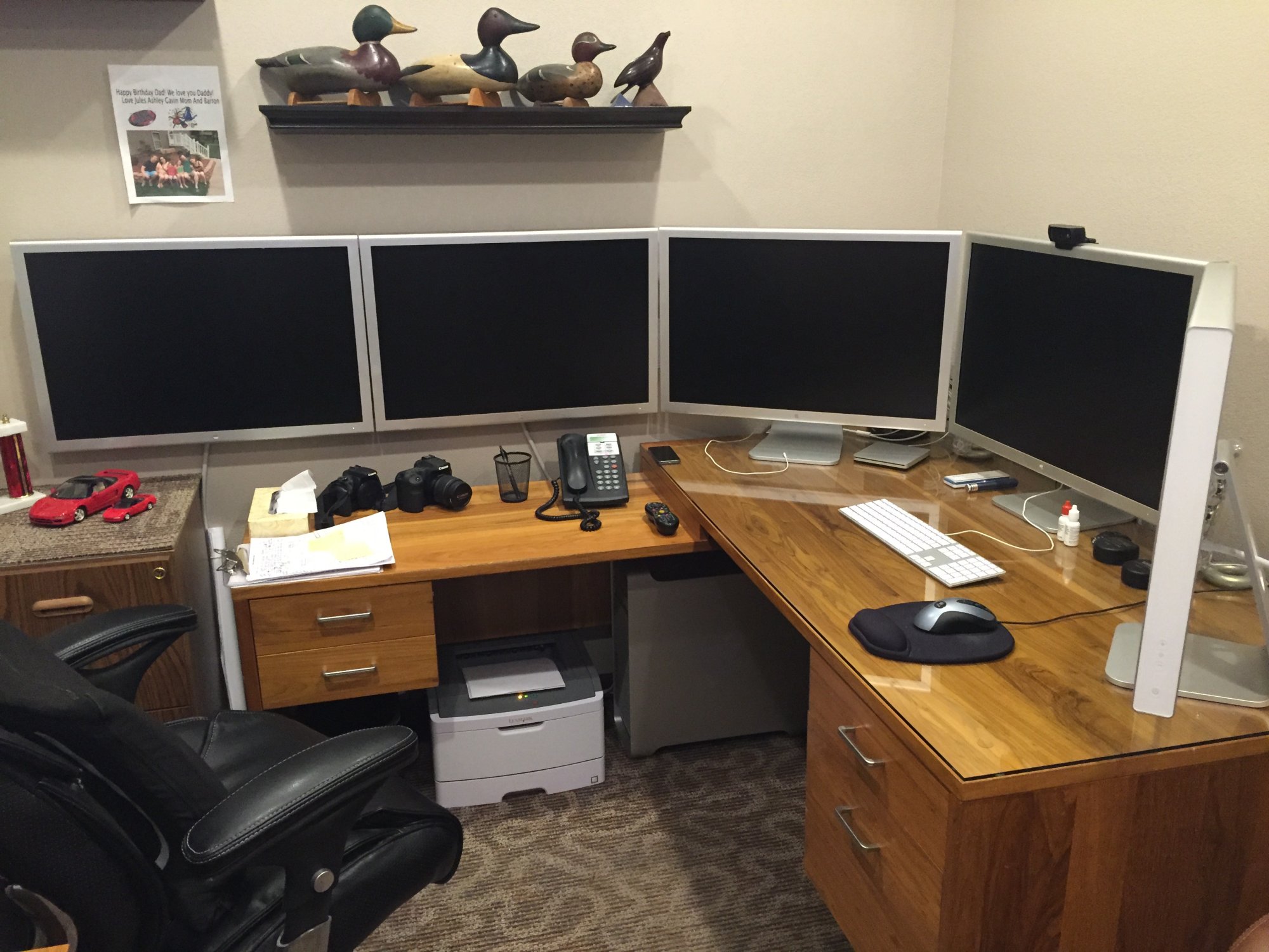

Yes a lot of work. I just threw all 5 of my ACD 30" away as I was tired of the amount of heat they were putting out and just wanted newer stuff...Ended up with an XDR Pro display for my main, and 3 x Apple Studio Displays (height/tilt) on the sides. Way better and waaaaaaay cooler in my office.

It was kind of sad to throw them away. They treated me very well for over 10 years. I just didn't want the hassle of trying to get rid of them. They were in perfect shape cosmetically just like all my stuff. ADC is just old hat and was time to get a new setup.
Below is the new vs old setup.
