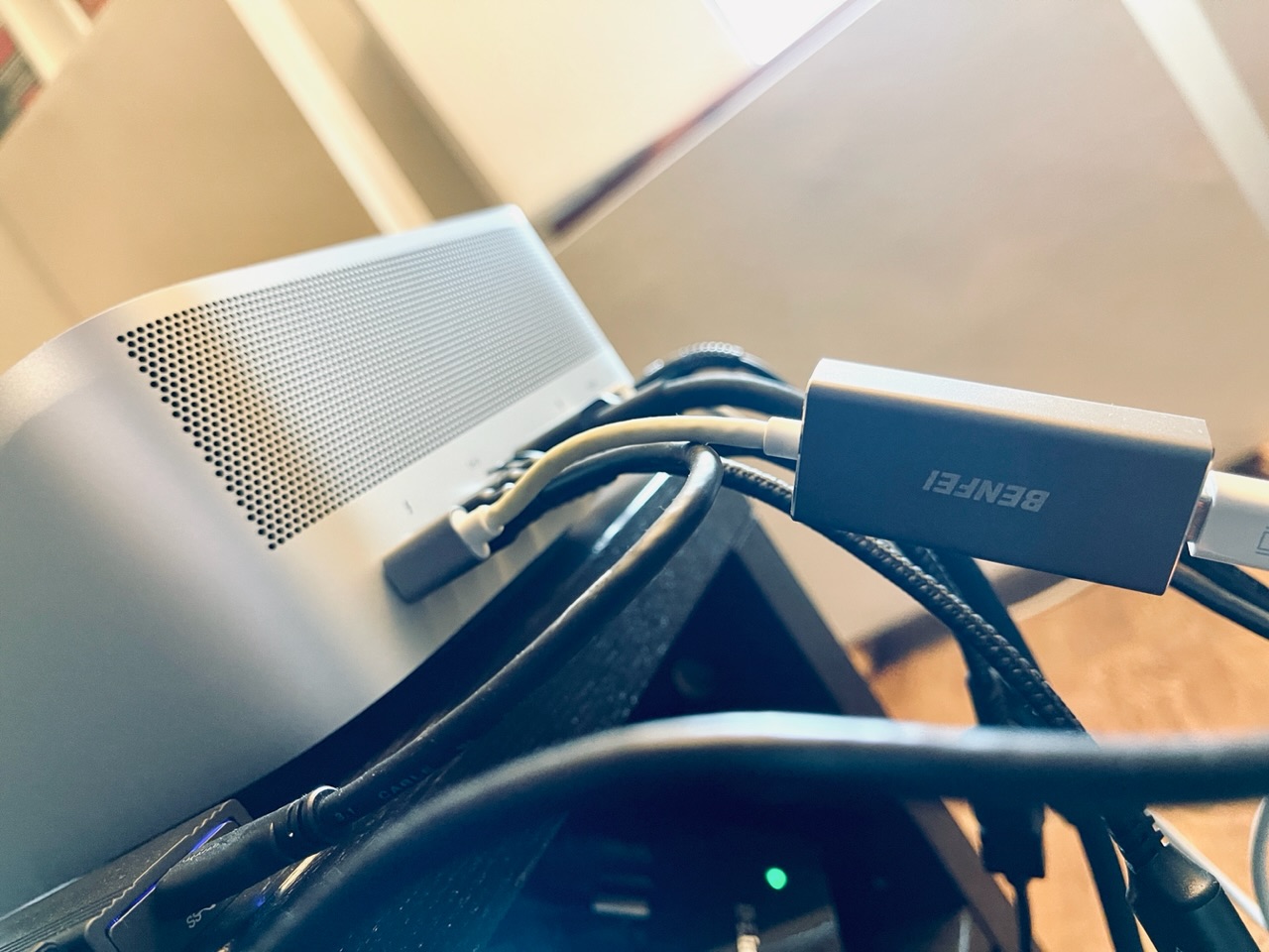

I tried a variety of adaptors, the only ones that worked were an old BENFEI mini DP to USB-C one that you can't seem to buy anymore (pictured - used with the Apple DVI to mDP adaptor) and in the UK there's this one which worked but I sent it back as I only use one monitor now: https://www.amazon.co.uk/gp/product/B085HH1LQW/ref=ppx_yo_dt_b_asin_title_o04_s00?ie=UTF8&psc=1
It looks like a UK version of the Club3D one and isn't available any more...
