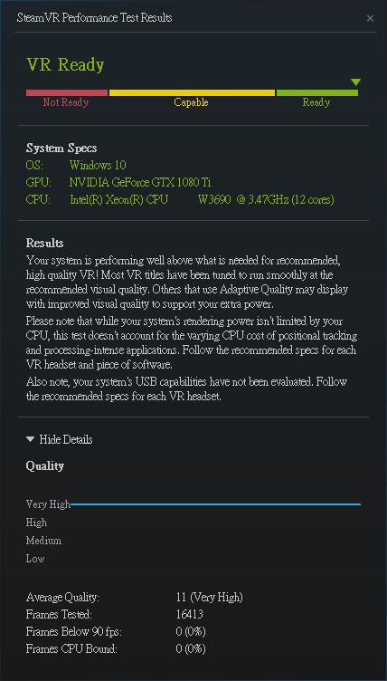

The specs of the Mac Pro are high enough to support a Rift. Has anyone tried to run a Rift in bootcamp?
If the steam VR test is accurate, then the cMP should be good enough for Rift.

Running Oculus well and perfect with no stutter on
mac pro 2009 with W5590, Nvidia GTX 1060 on Win 10, PCIE USB 3.0 and Mac Pro USB 2.0 with 3 sensors.
