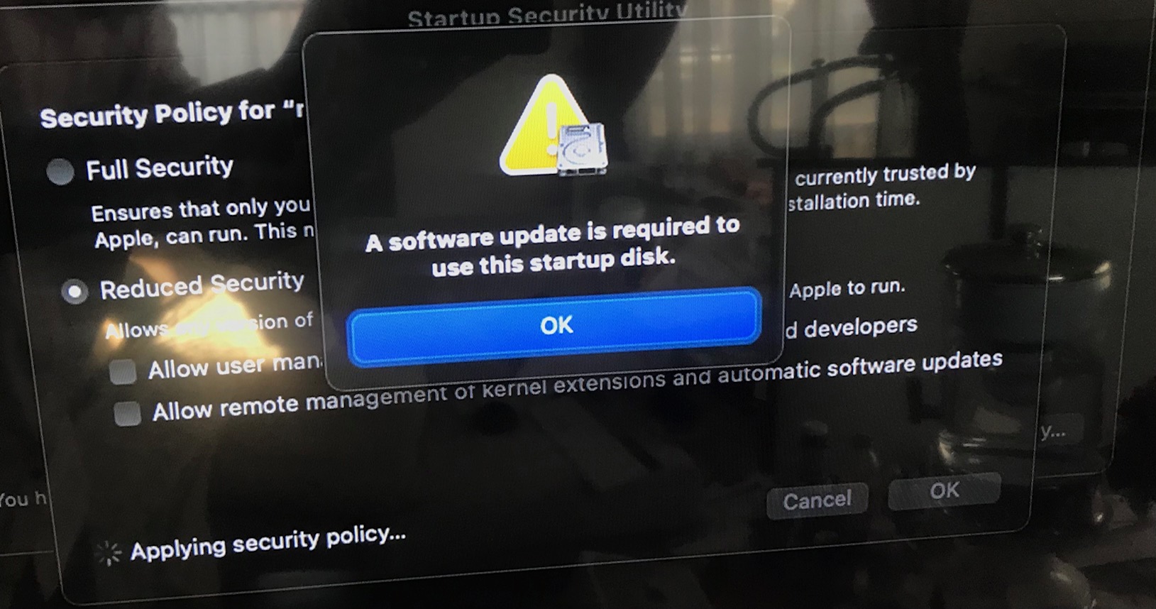

Hi, I bought the new Mac Mini M1 and would like to use it with a external 1TB SSD. I recently bought a 2018-2019 Mac Mini and was using my external SSD just fine with it, but now with the M1 it is having all kinds of connectivity issues. I thought I would just plug it in the M1 and it would work, since it has the same OS version as the internal SSD, but it wouldn't let me. It said I needed to reinstall 11.01 all over again, so I tried, but it got halfway and then said there was an error and it stopped installing.
It then said I had the wrong version of macOS, even though the internal SSD had the same exact version (11.01).
So I formatted my SSD and reinstalled 11.01 onto it. Guess what, yep, you guessed it, it says I can't use it because it needs to be "updated" - even though it is the current version of macOS (11.01).
BTW, I tried the Startup Security Utility as shown here;
https://support.apple.com/en-us/HT208198
but there was no external drive option.
How can I get this M1 to boot into the external SSD?

Have you run software update recently?
I ask because there might be an update to Big Sur 11.1 which may upgrade your firmware as well.
In the screenshot you show are there only the two options visible? There is not a third option "No security"?
Maybe you need a firmware upgrade, if there is one.

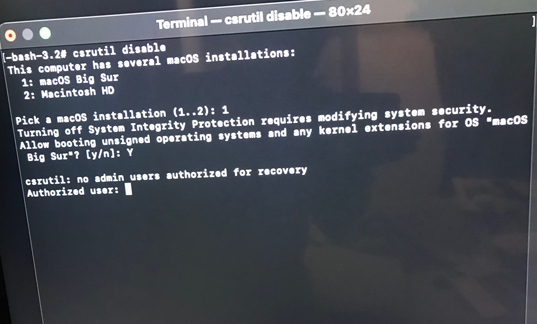

Upon further reading it seems you may have to disable SIP too using the terminal command
csrutil disable
This might give you the third option.
Though you need to check that this is necessary before you do it.
SIP would presumably need re-enabling afterwards with
csrutil enable

Yes, software update has been run and it says I have the latest version. In fact, ironically, the external drive has a newer build of 11.01 than the internal drive does (internal drive has build 20B29, external drive that was just installed has build 20B50).
There is no third option, and there is no section for external drives like the intel version had. Others on the Apple forum have reported the same thing.
Terminal will not allow us to run csrutil disable.
It won't let you disable SIP on a running system.
To disable SIP you need to boot to the recovery environment then choose Terminal from the Utilities menu
Type the command and press enter
Type "reboot" (no quotes) and press enter
System will reboot and then you can re-enter the Startup Security Utility again.
The new options should be there.

I have tried that but it won't let me run it because it is asking for a admin user. When I type in my admin name it says no user available.
That's curious! You don't get options? Or are you the only user/admin?
It doesn't ask for the password at all?
It first asks you which drive you want to apply it to. Then it reminds you what disabling the utility does. Then (sometimes) it asks you for your password. When I type it in it says the password was correct but disabling failed. I have tried this several times. Sometimes it asks for the admin name first. When you type it in it says 'unknown'.

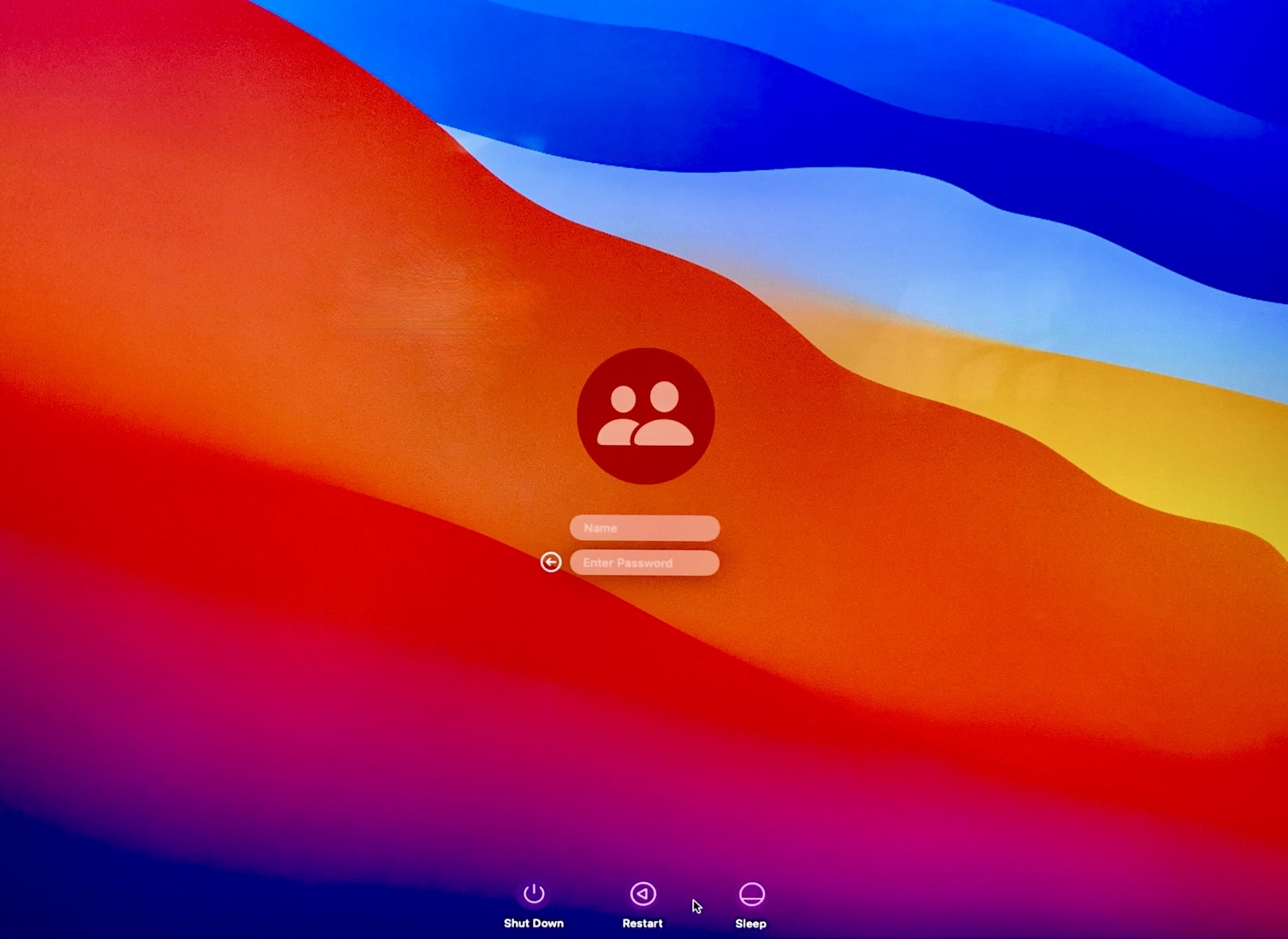

The installation of Big Sur isn't the issue. The issue is that once the drive boots up and loads into the desktop, it asks you to log in as the admin. The problem is that there is no admin assigned, so you're stuck at the desktop login page.
From what I've read there is a file called AppleSetupDone that if you can remove it the system will log you back into the Welcome page where you can set up the Admin account again, but I can't locate this file, so I can't remove it. Below is a screenshot of what it looks like. I have two bootable drives, one is a traditional drive, and one is a SSD, and they both come to this same screen;
