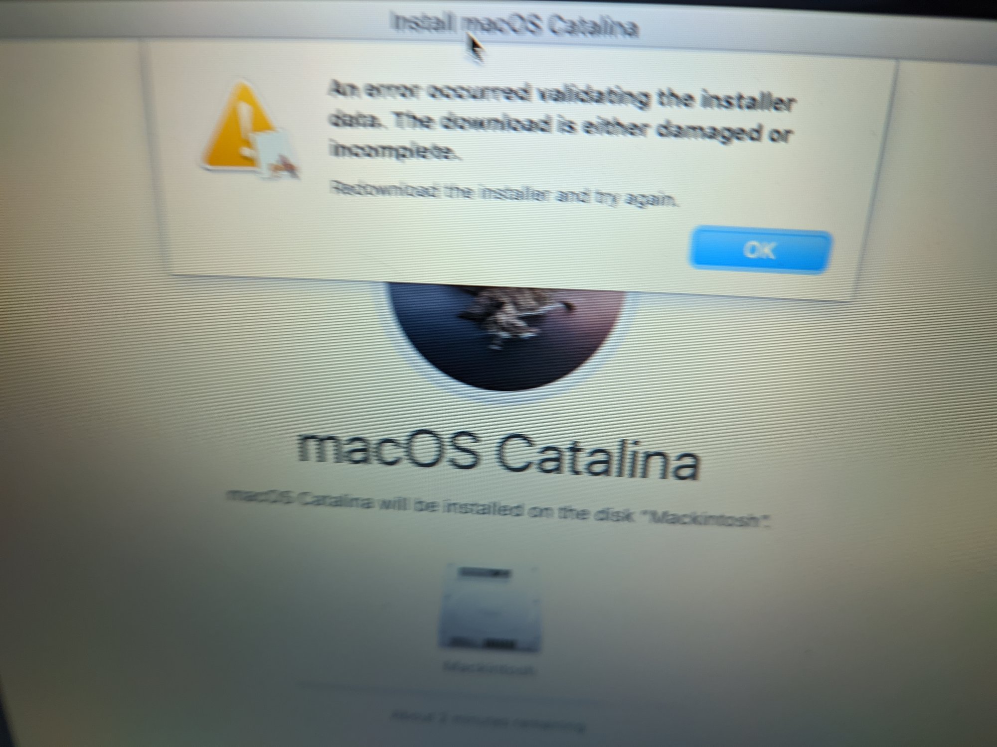

I have Macbook Air 13 Inch 2015. I have tried installing macos and it won't install.
I have installed macos on many of my friend's macbook airs and pros with 0 error.
What I've tried
1. Download the OS from here https://support.apple.com/en-us/HT201372 and follows the terminal script
2. Download from Mac Deploy and make bootable USB from their app and also make a bootable from terminal
3. Tried changing date from terminal.

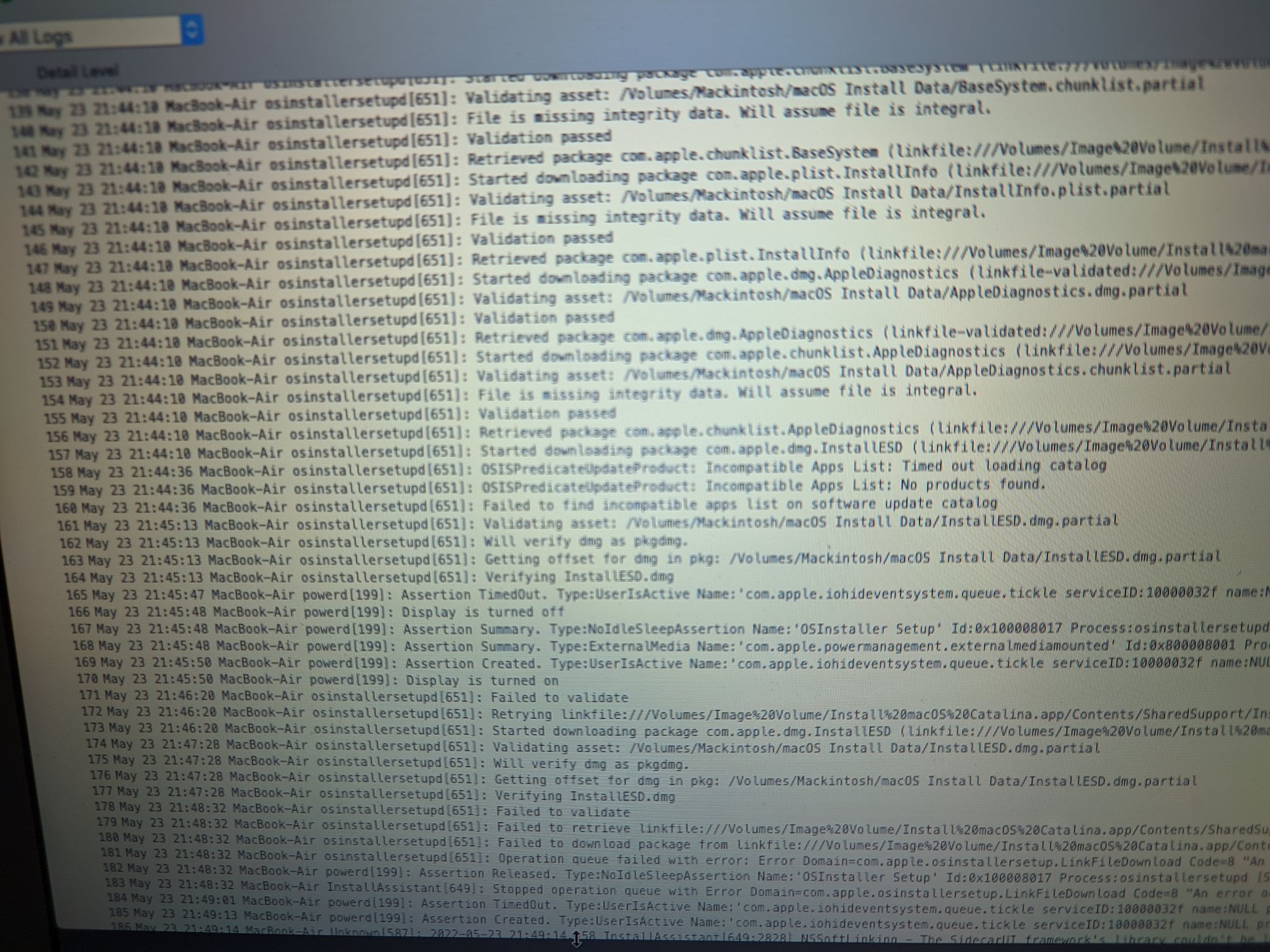

I have tried all these with Mojave, Catalina and Big Sur. I used the same Mojave I boot and that too did not work anymore. Apple diagnose 'D' says no error found.
I need some more suggestions of what I can try.

Do you get an error message of some kind when you try to install?
Please help. I also checked the sum from these and they are all same https://github.com/notpeter/apple-installer-checksums

Hey, you've probably thought of this but just in case...
Apple have a cunning "check" built into their macOS installers, each of which contain basically a "use-by" date. When running a macOS installer it will compare the system clock date with the date baked into the installer, and if the dates are too far apart then the installer will refuse to work with exactly the error shown in the first image of post #4.
To get around this when trying to run an older installer it is possible to boot into the installer, but then change the system clock date via terminal before proceeding with the installation.
My rule of thumb is I look at the "Modified Date" of the installer file, and generally aim for midday the following day, and then go:
1. Boot from installer
2. Open Terminal (from Utilities menu)
3. Type date into Terminal followed by today’s date in this format [month][day][hour][minute][year] eg for July 11, 2016, 2:15 that would be date 0711141516 then press enter.
4. Close Terminal
5. Run Installer
This has always solved the problem for me.

No macOS installer is affected by the expired date issue since Sierra. You should not need to change the system date at all. You can't boot to an NVME drive (as an internal drive) unless it has High Sierra or later installed, so the date is not an issue - it is a "red herring", at least for a system newer than Sierra
You are not correct on this. I've literally just had the error the OP reported when trying to install Mojave, and changing the date using the method I described solved the problem, and the install then succeeded without error.
I install Mojave probably twice a month on customer's Macs, even yesterday as a full wipe-and-restore on my own Mac. I have never had to reset the date for Mojave. Latest installer that sometimes needs that is Sierra.
You have anecdotal experience, but it's more likely that your Mojave installer was not up-to-date. I download most installers at least once per month. The common date issue was on El Capitan, and, in my own experience, the most recent download for the El Capitan installer does not currently have the date issue - at least in my own experience.
Don't take this wrong, as I do occasionally have macOS installer fails, and I sometimes will try the date change anyway -- but almost always, a quick NVRAM reset, then rebooting to whatever macOS installer usually gets an install working for me.
Like you, I am an IT professional and I regularly complete such work for customers, so I think the difference in our experiences may relate to the slightly different processes we use, but I can assure you my experience is not "anecdotal" but borne out by numerous data points.
I have the installer DMGs saved for future use, and use the createinstallmedia command within terminal to prepare a USB drive when necessary, that points to the saved DMGs. If you download the installers regularly, then they might be seen as "fresh", which might be why you don't experience the date issue, whereas I do. I cannot say for sure.
I can say however, with confidence, that you are incorrect when you said that "No macOS installer is affected by the expired date issue since Sierra. You should not need to change the system date at all."

I know it is an old post, but I just wanna say that this worked in my case. Tried to install HighSierra on A1534 and got message " damaged installation" or something like that and after changing date to 2017 everything worked great.
