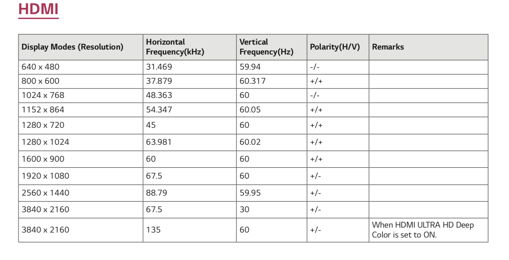

Find in your monitor settings something called "HDMI UHD colors" "HDMI Ultra deep colors" or something similar to that maybe even "HDMI HDR color". Its typically an option that is enabled/disabled on an HDMI port to port basis.
This setting is defaulted off for compatibility and only applies to HDMI. But basically 4k60hz w/ 10 bit color exceeds the default bandwidth limitations so you need to tell the monitor what the input is.
See if that helps.
EDIT: did some digging on LG's site, called it with the HDMI Ultra Deep Colors"! Lol....

Note the very last option. Once it detects it you shouldn't even need to set it, it will use the 60hz refresh rate. My Samsung TV was the same way "HDMI UHD Colors"

@cynics : I have looked for such an option in my monitor settings, but I did not find anything that would match. However, in my system information panel, I can see "Framebuffer Depth: 30-Bit Colour (ARGB2101010)", does that sound related?
[doublepost=1549977410][/doublepost]Edit : My bad, I have found it in the settings, and it is on. Looks like the monitor is not working when it is off.
[doublepost=1549977604][/doublepost]Edit 2 : while plugging/unplugging stuff and a few reboots, I have 60Hz now using the DP cable and a port on the left side, the bottom one. I am very confused but I will enjoy this moment having a monitor working smoothly. I am pretty sure it won't last 🙁
