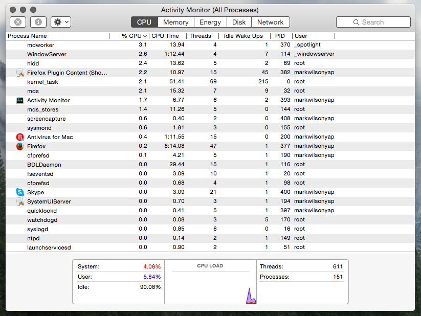

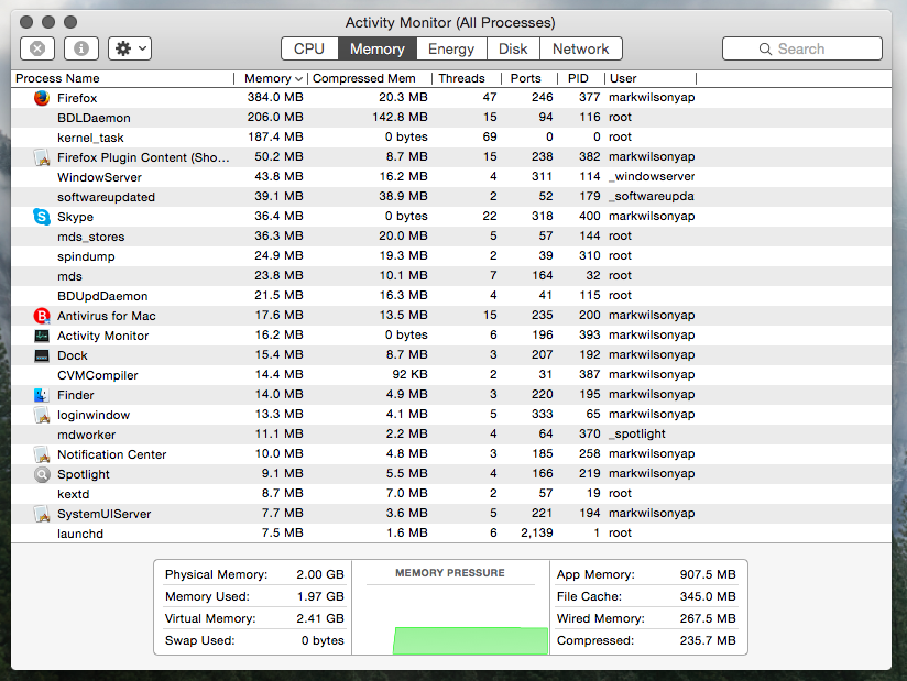

When you have Activity Monitor open, does it show one particular process hogging your CPU time. (Sort the columns by CPU%).
here are the shots. my fan is a bit noisy now and its hot on the left side of MBA.

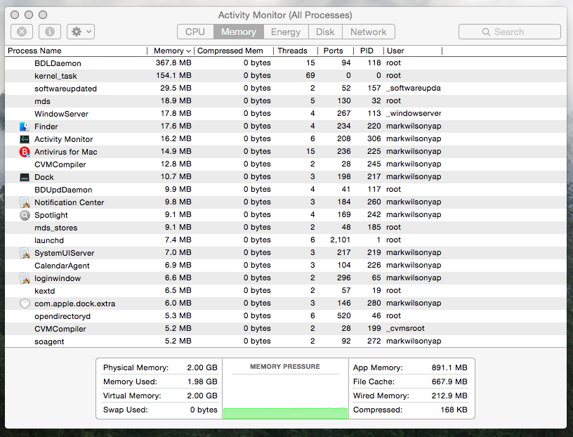

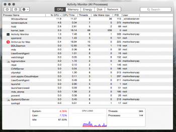

more recent activity.. before i opened any application just the activity monitor and my fans are screaming for air..
would love to hear your expert advise.

You might want uninstall Antivirus software you have installed, it's using quite a lot of RAM and processor time. If you regularly send files to Windows users then it might be worth it to keep using it but otherwise it won't give you any benefits as there is currently no viruses on OS X.
If that doesn't help next step is to install EtreCheck which collects diagnostic information about your Mac.

I'm using bitdefender as my antivirus. it keeps on updating on background. i tried to turn off the auto-pilot option. my mac does seems a bit faster and my mac does not heat up that much. going to observe this. also, i switched back to safari instead of firefox. I'm sure it eats more ram than safari.

Get rid of the antivirus all together. It is not necessary on OS X, and if you intend to send files to a Windows machine, let them deal with it. Generally they run antivirus software anyway, so it should be caught on their end. (I hate that logic, but you have to do what you can to make your machine pleasant to use.)
