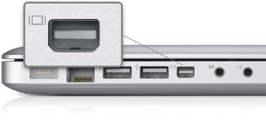

Hi all,
I just acquired a Macbook Pro 15" Mid 2015 model. I had a Dell U2515H monitor already. The cable provided from Dell is a DisplayPort to Mini DisplayPort. I was using this same cable with my Macbook Air late 2011 and it was working. I tried using the same cable with the Macbook Pro that I just bought and it doesn't work. I picked an old and only HDMI cable that I had plugged to my TV and that works fine.
I'm wondering why it is not working with the DisplayPort cable provided since it worked with the old Macbook Air. Doesn't this new Thunderbolt accept this type of cable? Because if not, I will have to buy another HDMI cable :-/
On another note I'm a bit worried that something might be wrong with the Thunderbolt ports? I got this refurbished Macbook Pro from Apple Store...
Thanks,
Ralph
MacBook Pro (Retina, 15-inch, Mid 2015), OS X El Capitan (10.11.2)
[doublepost=1452786735][/doublepost]Problem just solved!
As incredible as it sounds, I realised that I was plugging the mini DisplayPort cable side upside down into the Macbook Pro!
I thought those cables were designed to have a plug which prevents this kind of thing! :-(
I bet I was not the only one doing that.

If it was fitting into that keyed port upside down, it's because you were forcing it.

My brand new macbook Pro is one of the most expensive models. I just opened the box for the first time yesterday evening and was setting everything up. Believe me, I was being very careful. The cable was getting plugged into the port upside down like hot knife would go into butter. Maybe the plug of the cable was bad manufactured and slightly smaller than it should be? I don't know. I was really surprised that that would be possible. That is something that it can't happen with a HDMI cable or even USB.

That's entirely possible. I just tried to plug in my TB gigabit Ethernet adapter upside down and it doesn't fit.
Surprisingly, I've seen this before. I used to work at an AASP and we'd see cases where customers had plugged in a FireWire 400 cable upside down and fried part of their logic board. Maybe they had cheap cables that were just loose.

I too was able to plug a Dell-supplied mDP-to-DP cable upside down into my new 2015 15" MBP. I believe the connectors on the Dell cables are sloppy enough to allow this to happen.

- Just tried the same thing. My Dell mDP-DP will also fit in the hole upside down, easily. Unfortunate design.
