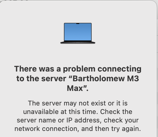

I have 2 Macs. SMB and file sharing turned on. Connection works one way, not the other:
Primary Mac can connect to backup Mac via Finder/Network;
Backup Mac CANNOT connect to primary Mac via Finder/Network.
On the primary Mac I open Finder/Network, see the backup Mac's name, double click, the first time it asked for user/password, and I was looking at its documents folder.
But on the backup Mac, I bring up Finder/Network, see the primary Mac's name in the list, I double click, it hangs on Connect for a long time, and then just says "Connection failed". I tried "Connect As..." and it failed. It shows this: (Bartholomew is the primary Mac):

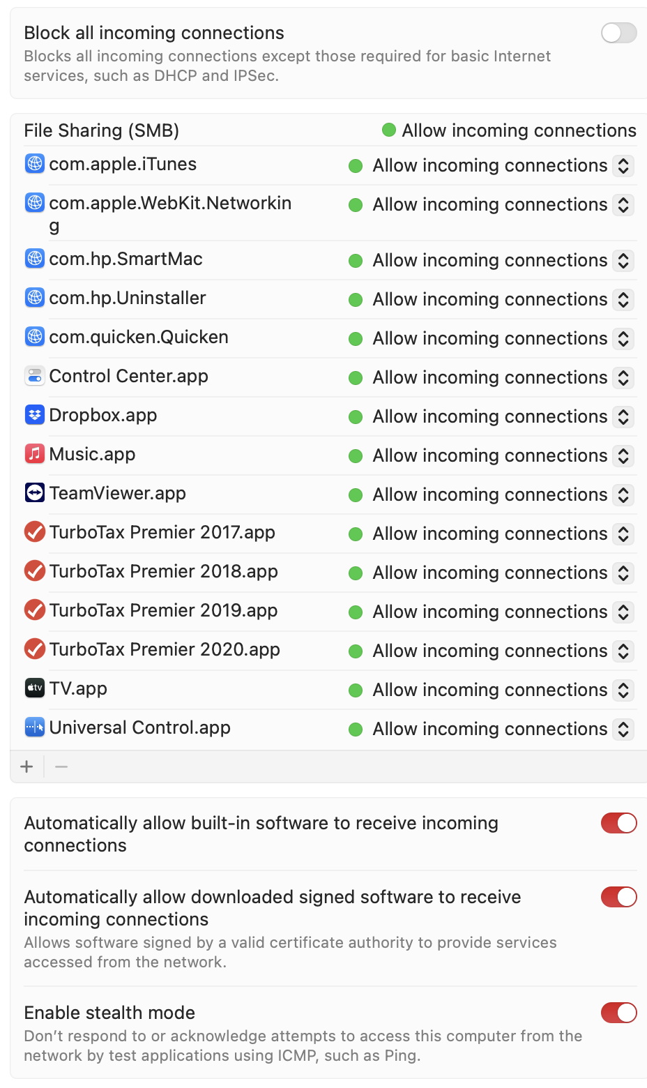

If the firewall is turned off on the primary Mac only, the backup Mac can connect to the primary Mac! I have not done anything with customizing the firewall. Here is what the details look like, it is identical to the backup Mac except for the TurboTax connection lines:
Macs are on the same network SSID, same Apple ID, I restarted both, no success. And, the backup Mac can connect to my wife's Windows PC via Finder/Network, no problem.
Why is Firewall preventing connections from the other Mac?

I just used the Feedback Assistant app to file a problem report - have you done that? Maybe some problems reports will get it fixed....Feedback Assistant is an app on your Mac. I said it was a Finder problem, connecting to other computers in the drop-downs. Here is me brief problem description:
I have an M2 and M3 MacBook Pro - from the M2 MacBook Pro, it cannot connect to the M3. It can connect to other Windows computers on the network. The M3 can always connect to the M2.
I have found 2 ways to fix this. By turning off the Firewall, it works permanently. Or, Turn off the File Sharing setting, reboot, turn on the file sharing setting, it will work - UNTIL THE NEXT RESTART on the M3 Mac.
