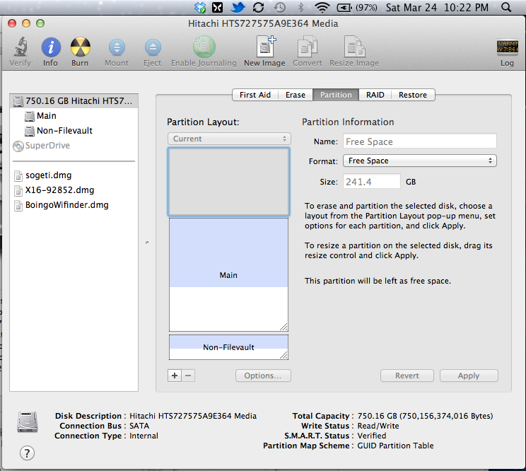

I think I'm on the same boat:
When I replaced my mid-2010 MacBook Pro's 320gb hard drive with a 750gb Hard Drive, I moved the contents of the original HD onto the new HD via Carbon Copy Cloner. Then I found out that if I wanted a recovery partition, I couldn't just move files back and forth, I had to install Lion first. So I added a new partition, installed Lion on it (and got the Recover Partition created that I wanted), and then moved all the contents over. Then I deleted the first partition and tried to merge the contents and couldn't because of the "Disk Utility cannot modify this disk because it contains CoreStorage physical volumes. Use command line diskutil instead."
So if I understand correctly, I need to just turn off filevault and then I should be able to merge the partition and the Free Space of the old partition.
Below is a screenshot of my partitions if it helps. There's another little slab of 650gb which I believe is the Recovery Partition. I have another 100gb area on the Hard Drive which will not have filevault on it.

The good news is Filevault is now turned off and I can resize. The bad news is that the Free Space is "above" the Main partition which means I can't just expand into it. I have to install Lion on that "first" partition, move the data over from this partition to that one, then delete this partition, and then merge this space over.
