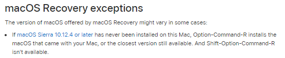

If you are booted to internet recovery (you booted with Option-Command-R), then that will usually offer you the system that your Mac originally shipped with. Sounds like that would be Lion for you.

Next, reboot in recovery mode but go with the option to install the latest compatible OS [Option/Alt, Command, R], not the Lion that came with the Mac. I think the problem I was having, like some of you, is that the BIOS was probably upgraded at some point and the recovery tool can't install the original OS. Since you cleared the PRAM, you'll have to enter your WiFi info along with other settings like timezone when you boot into recovery mode.

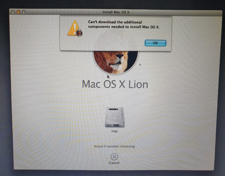

Hello Guys. I erased my drive to reinstall Lion on MacbookAir 2011, but it isnt working and I get the "cant download additional components" message. Tried the solution from Comment #40. It takes me into network recovery. I see the spinning globe. It then takes me into Max OSX Utilities. But the I do not see the option to download any OSX other than Lion. Please Help.
You said that you want to reinstall Lion. Then you said that internet recovery shows you only Lion (no other options)...
Isn't that what you want - Lion?
I am fine with downloading any macOS. Lion would not be a problem except that when I try to install it, I get the error in the title of the thread:
"Can’t download the additional components needed to install Mac OS X"
A screenshot is attached with the message.
So I thought that option in comment number 40 would work for me and I could get a macOS other than Lion. However, it does not. I suspect it is because I have never had any macOS on it higher than El Capitan, 10.11. I believe this is the case because of a paragraph I found on apple support website. (screenshot of that is also attached in the message)
Thus even doing command+option+R only take me to the download of Lion and nothing else.
Additionally, I have tried to use USB and Transmac, but the Startup Disk does not recognize anything and is blank. It does not see the empty mac disk nor the bootable USB disk when I plug it in.
I do not see any other option for me to get an OS now and my macbook air is reduced to paperweight.
Please Help if you have any ideas.

Your options are limited since you already erased your 2011 MBA and Internet Recovery only will install Lion.
Do you have another Mac that will boot so you can download macOS installer apps?
Is Lion the only macOS ever installed on the 2011 MBA?
Lion was the original macOS that shipped with your 2011 MBA and Internet Recovery should be able to successfully download and install Lion. Since it will not, I would recommend calling Apple support for help.

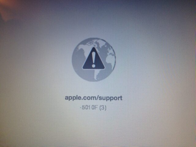

I’m having the same problem. I have a 2011 MacBook Pro. It’s trying to install Mac OS X Lion, after cleaning my computer because I want to sell it. I’ve tried the suggestions in post #40 and keep getting errors. I’ve gotten error 2002f and 5010f. Help please!
I have not experienced the errors you listed, but I googled the error numbers and found 2 suggestions that seemed relevant.
Error 2002f
I have had good luck with DNS 8.8.8.8.
Error 5010f
Error 2002f
Error 5010f
How do I set the dns to 8.8.8.8? I’m not very techy.
It has been 9 or 10 years since using Lion, but IIRC (If I Recall Correctly)...
From a bootable OS:
System Preferences>Network>Wi-Fi>Advanced... (button)>DNS section>DNS Servers +> type 8.8.8.8 and drag it to the top of the list then reboot.
Make sure the 8.8.8.8 is in the top of the list.
If no bootable OS then check/modify the DNS server preferences in your Router (you would have to reference your Router manual for instructions).
