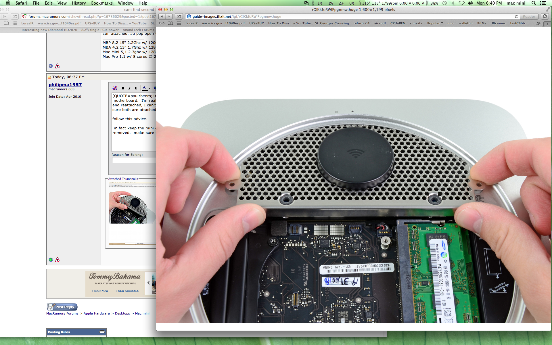

follow this advice.

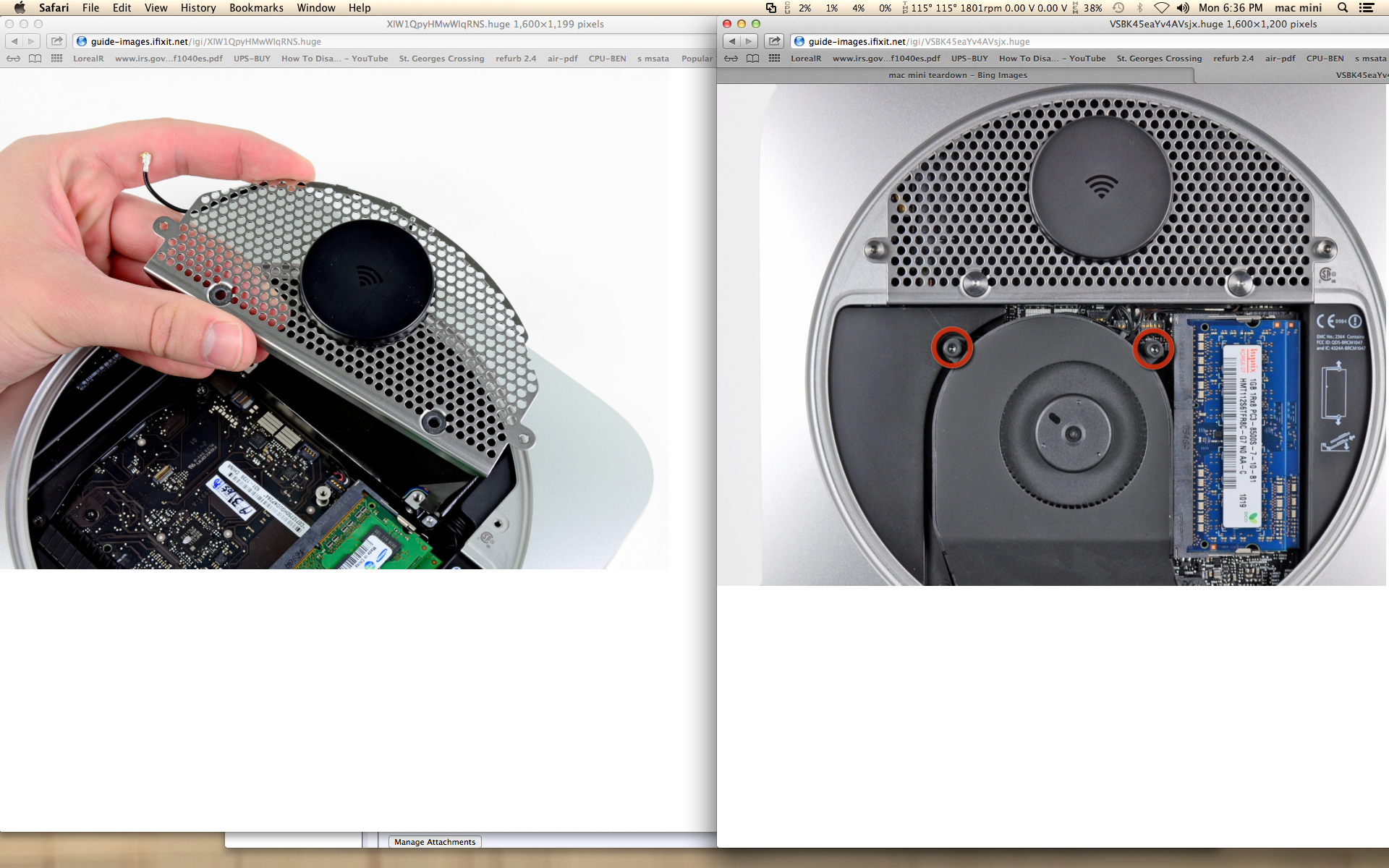

in fact keep the mini on its back with the black plate removed. boot the mini with the fan in but the grill removed. make sure you can see that both cables are attached.
look at the second shot see the left thumb. it is near one attached sata cable make sure both are snug. then boot with the fan attached and look for two drives.
