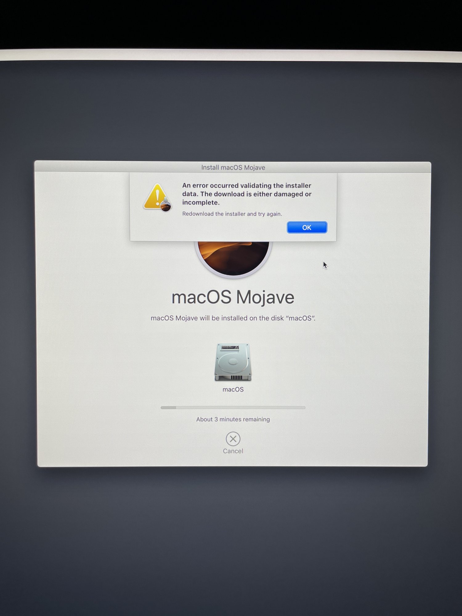

I’ve installed a Samsung 970 Evo Plus with the sintech adapter into my 2017 iMac 27” 5K.
was getting kernel panics (nvme fatal error) and so i decided to reinstall mojave. now that i’ve erased the nvme to reinstall, i’m pretty sure i have ruined my recovery partition and I’m having NO luck installing mojave at all using a USB installer made with terminal on a friends Mac.
yes, i’ve…
-updated the samsung firmware
-tried NVRAM reset, yada blah
-tried Recovery mode (goes straight to internet recovery and gives me the prohibit sign)
-erased the NVME multiple times with APFS format and GUID
pretty sure im absolutely F’d at this point.. no posts online and i don’t know what to do. please someone help me out because im about to give up and buy a new imac.

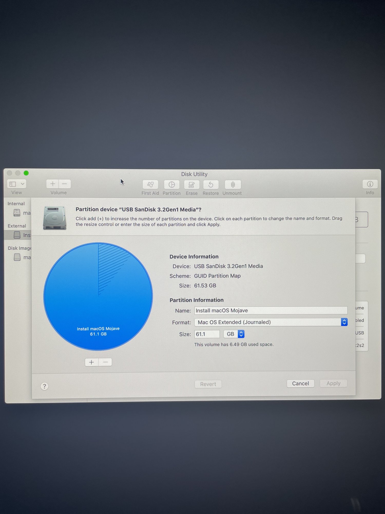

You might need to recreate your USB installer. Ensure you formatted it as Mac OS Extended (Journaled) with the GUID Partition Map Scheme. I had to do this with one I recently created when it refused to reinstall on my Dad's older Mac.
okay, i’ll try again with a different USB drive tommorow. were you getting a similar error message?
Yes the very same, and also with Mojave. The drive I was doing it on was formatted was Mac OS Extended (Journaled) but it had the Master Boot Record scheme. Reformatting it to that fixed it. Good luck and hope you get your machine back up!

hmm, seems setup correctly. i feel like something else is preventing it from progressing any further… but i guess it could be a bad flash drive still?
It could be a bad drive. Try a different one and see if that's still an issue. That also happened to me in another reinstall of Mojave some time back.
Did you download the .dmg installer directly from Apple or from another site? There was a bug in the past with these installers that had some kind of expiration date so many people were getting these errors. What about the computer that you used to create the installer? Which version of Mac OS does it have?
i downloaded it yesterday from the app-store on a 2020 iMac running Big Sur. it took like an hour to download so id hate to try it again for the same results… but no other option!
whats weird is.. before i removed my OS and i was having kernel panics, i tried downloading Mojave natively on my own appstore and i was getting a similar “could not verify update” error and the update file wouldn’t even appear in my applications folder.

tried the mojave patcher:
unfortunately it got hung up on a stagnant apple loading bar for a half hour not moving.. i gave up.
—i think the patcher works great for grabbing the update file nonetheless, so thank you 🙂
i also tried another flash drive with the mojave update and got the same ‘could not verify’ error.
the only thing that somewhat made progress was to delete the InstallInfo.plist file within the installer file; that made the loading bar go for a while! but got hung up on 2 minutes remaining for like.. 2 hours… and finally kernel panicked.
