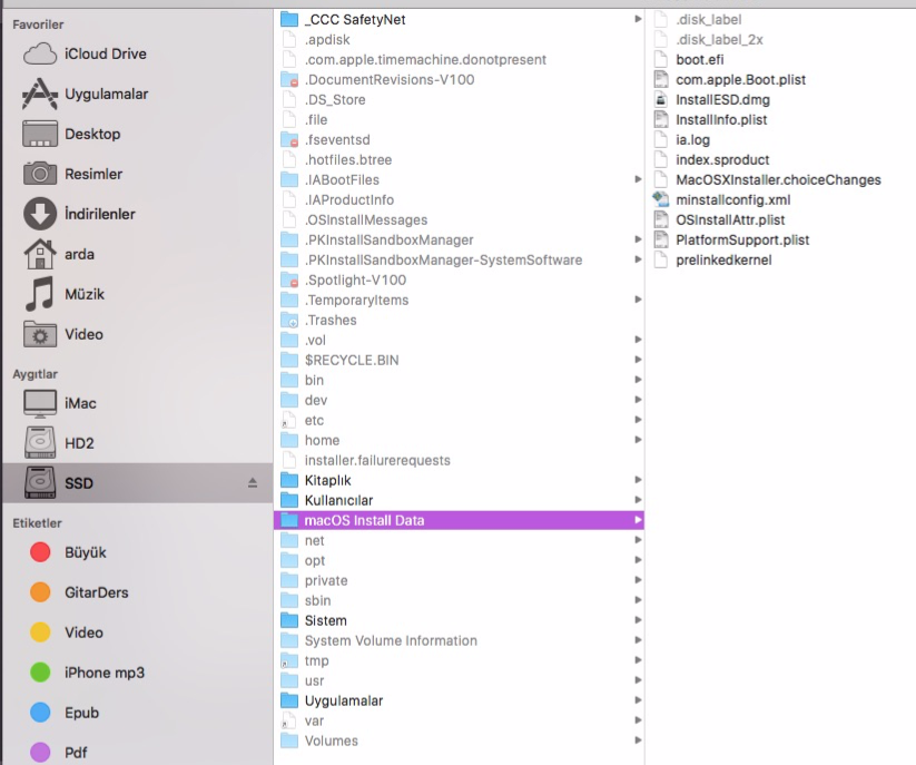

i did exactly the same but after restart imac stuck with prohibitory sign...
here is the ss of the ssd after stuck with prohibitory sign. (i boot the mac from internal hdd)
