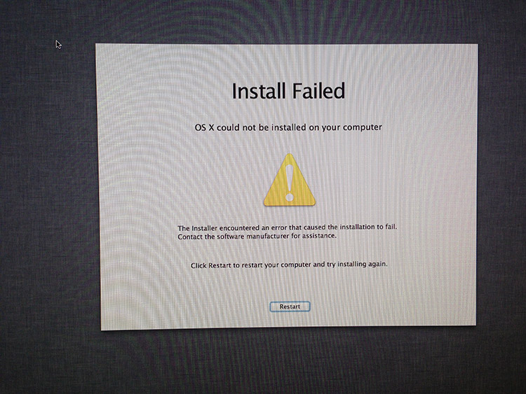

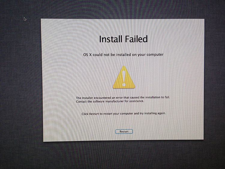

Ergh. So. It's not good.
I just woke up (couldn't sleep as I was worried about this), to find that the installation had failed.
It offered me a restart button, but when I did, it started the installer again - which failed again.
I went into disk utility (via the installer) and verified the slices AND the main raid stripe volume and all was green and OK. BUT if I still went and repaired the raid volume, it came up saying it could not be repaired/corrupted.
STRANGELY, ifI reboot into my old SSD and run disk utility repair on the RAID, it's all fine.
Out of interest - could it be because I have flashed my mac's firmware from a 4.1 to a 5.1? (is a 2009 model flashed to behave like a 2010 model).
I have uploaded a screen shot, along with an installer log I was able to find - maybe someone smarter than me me be able to see what the issue is?
Scott

UPDATE!!
Just got off the phone to Sonnet Tech.
He said that they also encountered the issue.
Instead - either use CCC to move the bootable OS to the RAID.
OR - connect both drives to the SATA2 backplane - do the RAID... and run the installer while they're connected to the native backplane. Once installed, move them to the PCI card.
Gonna try now!
UPDATE 2 - SUCCESS - I have done a fresh OSX install on the RAID while the 2 x samsungs were connected to my SATA2 backplane. Now going to power down and put the SSDs back onto the sonnet card
