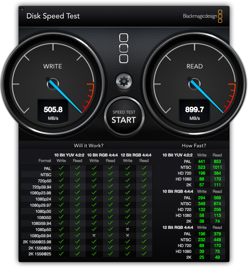

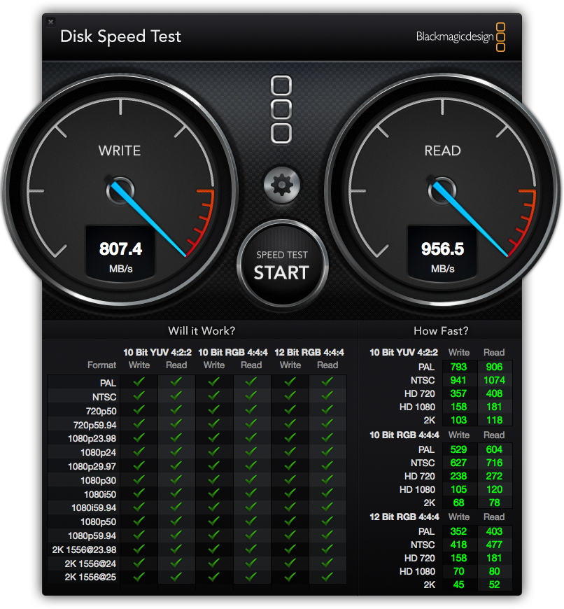

Here are my results with the Sonnet Tempo Pro running RAID-0 SSDs:
As you say ... it does scream! 🙂
(2012 Mac Pro 2.4 12core)
<<--- Left: Crucial M4 2 x 500GB SSD in RAID-0
--->> Right: Samsung 840 Pro 2 x 250GB SSD in RAID-0 (actually 1/2-500GB and 250GB ... other 1/2 is Windows)
