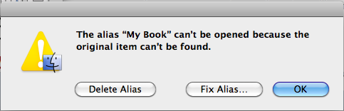

I jacked in my external drive and I get a alias message error. Not sure what to do. Does you have this problem with your external drive?

I have EXACTLY the same problem with my Western Digital My Book.
Although it would appear we're the only ones on the net with it - or at least the only ones to report.
I had a copy of the retail disk a week before release and the same problem persisted, ive just tried a new install again tonight from fresh in case something was corrupted in the process but no - as i booted up exactly the same thing.
Unfortunatly that makes it unusable for me as the my book is mounted wirelessly and logins in everytime i boot OS X with all my media files attached...
It must be a WD/MyBook/SL compatibility problem...
akutad - I poked around a bit and found the answer.
Download Path Finder 5. You'll be able to access your drive find - right click on it and chose get info.
In there you see "alias bit" untick this box and suddenly the drive will work perfectly with Snow Leopard.
Ive yet to try rebooting, mounting and unmounting etc but for now it works - its obviously not the answer if I have to do this ever time i reboot of course!
Hope it helps though.

dannys1 your pathfinder hack worked - thanks!!!.
However the drive (WD 2TB in RAID0) will still not mount if connected via firewire. USB sees the drive with the alias bit on.
What in snow leopard is causing this strange behavior ?? Will have to keep it connected via USB for now.
RE: Pathfinder fix. The drive shows up in disk utility but not in Pathfinder. The utility won't let me do anything to it, and pathfinder doesn't even see it.
It shows up in the disk utility when I connect it via USB, but that only seems willing to let me erase and re-format. It's giving me a number of reformatting options, anyone know which one I sould pick? Seems promising -- it's reporting the disk as unformatted.
