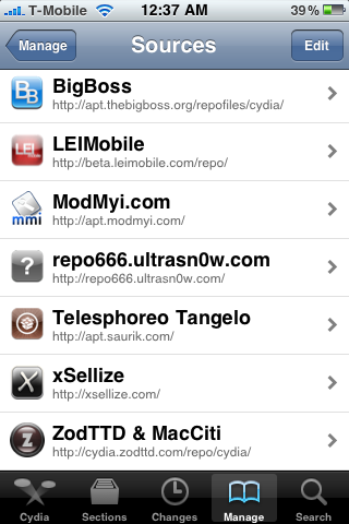

Not sure if you've found a solution or not, but I just had this problem resolved yesterday. You need you add the xsellize source to cydia and in it you will find the proper mms fix and tethering for t-mobile and at&t. This will create the correct apn codes and whatnot. I could always send, but got that same error when receiving; I thought I'd just have to sacrifice, but now I'm very pleased with how it's going!
I have an iPhone 3G on 3.1.3 with the iPad baseband. It works great now!
Hope this helps.

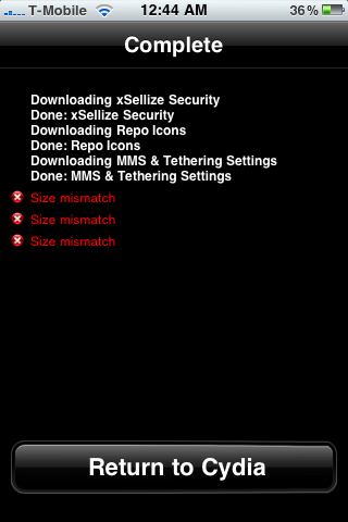

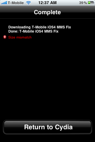

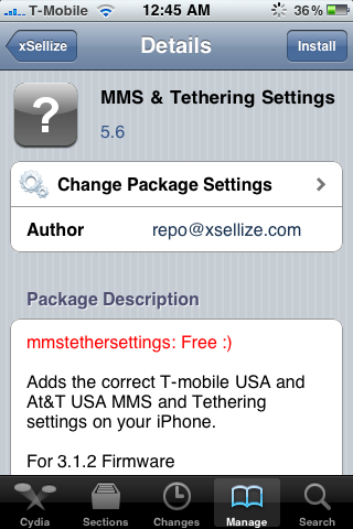

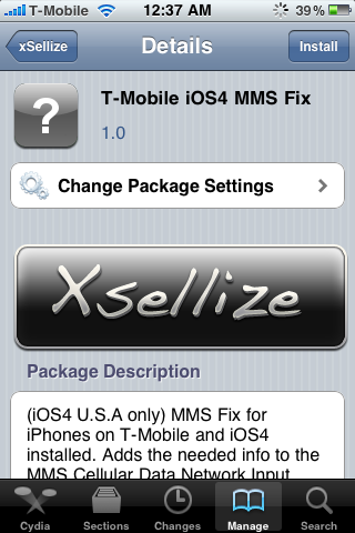

I downloaded the Xsellize Source to my jailbroken, unlocked to T-mobile iPhone 3gs (Currently on Version 4.0 (8A293) / Modem firmware 05. 13.04. I got size mismatch errors though when I Tried to install the T-mobile iOS4 MMS Fix. I even tried the MMS & Tethering Settings for 3.1.2 Firmware and got size mismatch errors there too. I got them on the NES Emulator I tried to install as well. Restarted the phone and tried again but got the same errors. Attached are some screenshots
I'm having the same issues. The other odd thing is that ANYTHING that I try to get from XSellize, gives me the same error message.
^ yep, I mentioned some of the other ones I tried which wouldn't work. I Wonder what else can be done so that my wife can send and receive MMS messages on her jailbroken/unlocked iPhone 3gs being used w/ t-mobile.
As I mentioned above go here:
