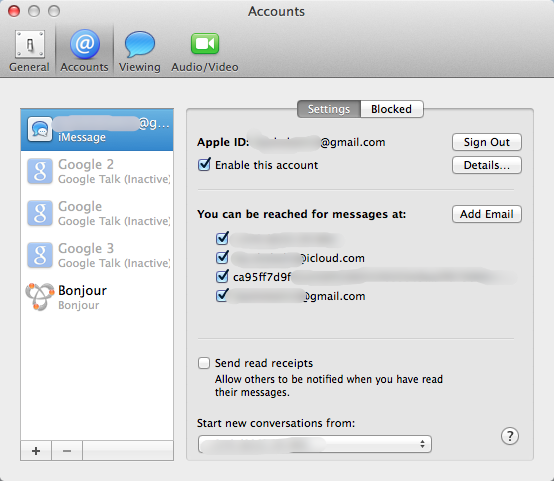

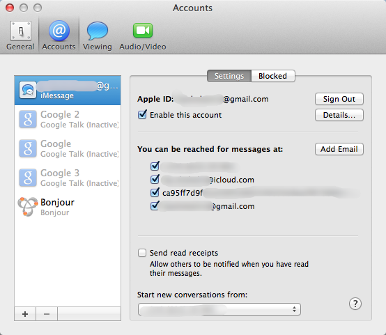

It is my iMessage on Mavericks:
Per the official Apple iCloud support requirements https://support.apple.com/en-us/118308, since 2023 at the latest, Mavericks is no longer a minimum. Try installing Legacy Proxy by Wowfunhappy Fixing Mavericks's Outdated HTTPS, and signing back in. It applies to FaceTime as well.

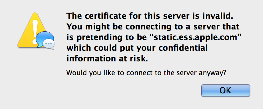

Hi. I've been using the Legacy Proxy by wowfunhappy for a while now, and it's had no impact. I do notice, however, that if I select "Create an Apple ID" within iMessage, I get this.
I don't know if it's related to my problem, I just thought I'd point it out.
Reactions: bousozoku
You better write in the Legacy Proxy thread or send a PM to Wowfunhappy. I might've not seen this error because I haven't signed out of iMessage.

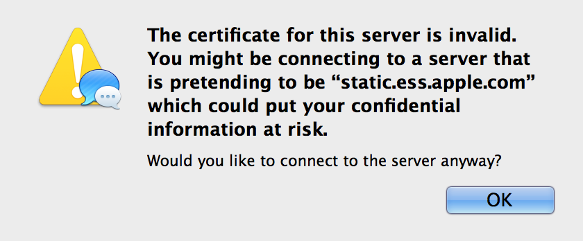

Well that's interesting!
Do any messages appear in console.app immediately before or after this message?
The text would appear to indicate an https problem. But as I have been saying in the other thread, my proxy does not modify iMessage traffic because Apple uses certificate pinning.
@f54da keeps reminding me we could bypass the certificate pinning if we wanted to, maybe this means we should.
But first, please, what appears in Console?

Thanks. Unfortunately this doesn't have the `SSLHandshake failed` I was hoping to see.
On the plus side, it sounds like iMessage has randomly started working again for some people?
