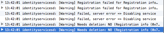

The suspected critical parts of the FT log look like this:
Code:
RTCReporting: environment release doesn't exist in storebag
FaceTime[6153]    [Warning] *** No call info found for participant: [IMHandle: <************@gmail.com:E:************@gmail.com:EN> (Person: <IMPerson> (Name: *************) ************* [08F5B50E-5658-4E12-ADF5-AD4767B2B543:ABPerson]) (Account: E:************@gmail.com] is waiting for others to join a video 1030 chat (0x6000001f5100)  (All: (
"<IMAVChatParticipantCallInfo: 0x60000014cce0>:state = 0, isFinished = 0, isBeingHandedOff = 0, callID = 0, state = 0, inviteNeedsDelivery = 0"
identityservicesd[222]    [Warning] Registration failed for Registration info (0x7fe109e11050): [Registered: NO] [Type: AppleID] [Device Name: (null)] [Service Type: FaceTime] [Env: (null)] [Main ID: ************@gmail.com] [Phone Number: ************@gmail.com] [AppleID: ************@gmail.com] [UserID: E:************@gmail.com] [C2K: NO] [Push Token: <ca60d431 f85f9e82 00c3aa2e 317d3b6d 42a49f37 b82b0721 e0bb8179 249841cc>] [Region ID: (null)] [Base Number: (null)] [URIs: (null)] [Candidates: (null)] [Auth Cert: 0x0] [Reg Cert: 0x0] [Profile ID: (null)] [Auth Token: (null)]  [Auth User ID: (null)] [Heartbeat Date: (null)]   (Error: 9)
kernel[0]    process FaceTime[15252] caught causing excessive wakeups. Observed wakeups rate (per sec): 177; Maximum permitted wakeups rate (per sec): 150; Observation period: 300 seconds; Task lifetime number of wakeups: 45012
"No call info", "null", "registration failed" with valid credentials in the log. Huh.

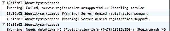

Decided to look through console and I'm getting "server denied registration support" errors so I assume there's nothing I can do here. Oh well, wasn't a very high priority thing to me but I'm disappointed it didn't work 🙁
If you are on 2FA, you don't need app-specific passwords. You want verification codes. Is your Mac on the list of trusted devices? Remove the troublemaker from trusted devices, one of which appears to be your Mac. Make sure your authentication is 2FA, and re-add the Mac and re-authenticate.

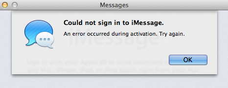

I think I might've tried too many times because now it just won't sign in no matter what. Just always getting the "error occurred during activation" message.

You must use the the process I posted on StackExchange. I know you say you already tried this; however, note that part of this process is do not attempt to sign into iMessage more than once per 30 minutes. That part is critical. Any attempts beyond your initial one within the 30 minute window will fail with "an error occurred during activation," no matter what.
Please correct me if I'm wrong, but I have a feeling you aren't waiting the full 30 minutes between iMessage sign in attempts. That would explain why you are seeing "an error occurred during activation," and why it worked once but not again.
If you are waiting 30 minutes but are still seeing "an error occurred during activation", honestly my first thought is to try waiting even longer, maybe a couple of hours.
In general, be careful to not to spam Apple's servers with sign in attempts.
Edit: Our posts crossed, I just saw your most recent reply. It sounds like you might have gotten your computer blacklisted by trying too many times. I would back off for a significant amount of time before trying again. You might eventually need to actually call Apple Support with that code to remove the blacklist. (But I would still wait at least a day.)
