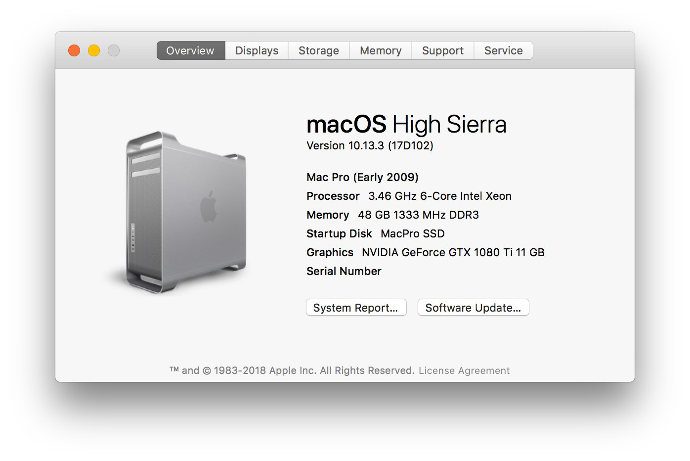

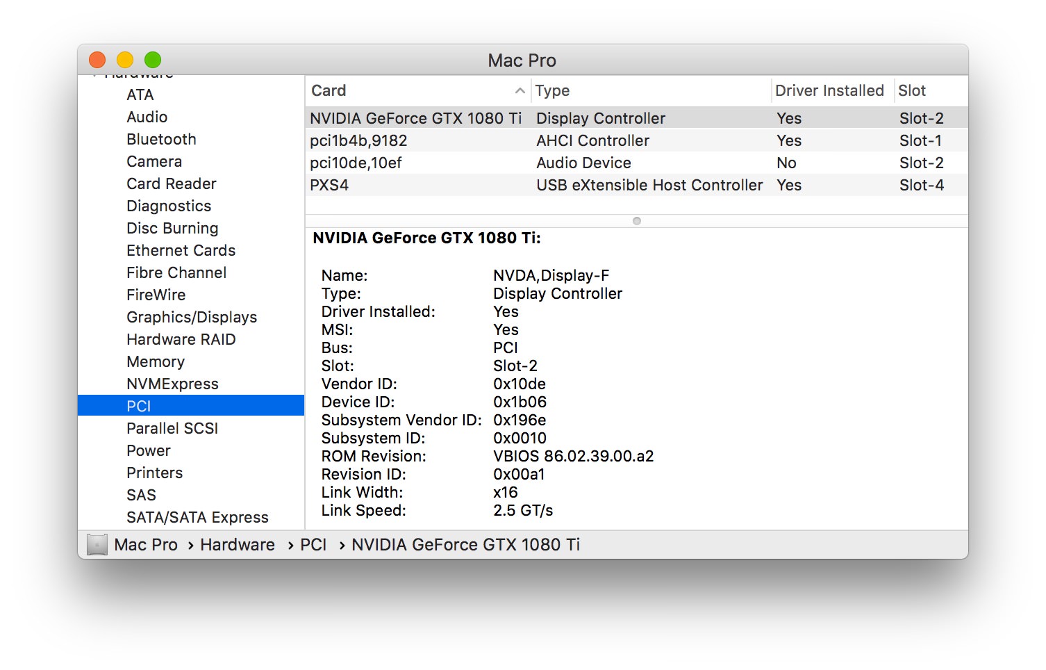

I can also confirm that the 387.10.10.10.25.158 driver works with my non-flashed reference 1080Ti in macOS build 17D102 (SIP enabled, GateKeeper disabled) on my cMP 2009 (flashed to 5,1).

And this is how I perform the macOS and web driver update.
