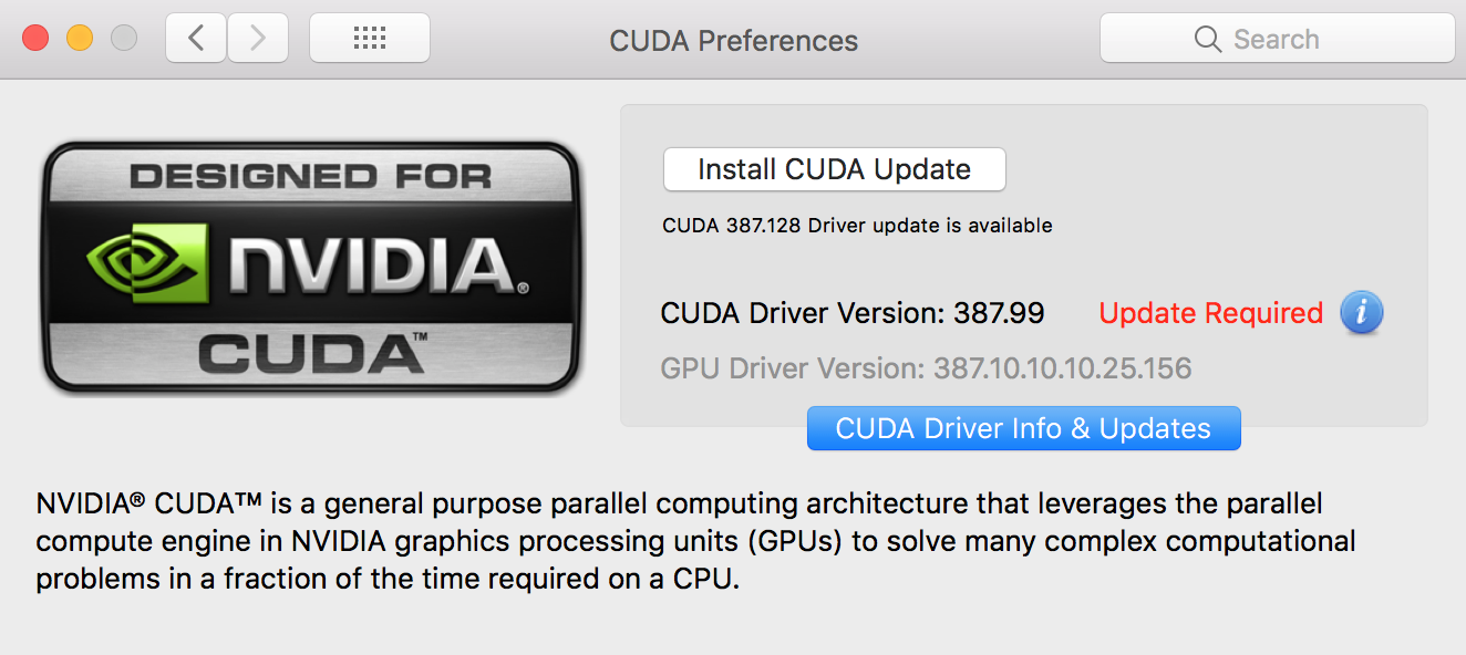

CUDA 387.128 driver is now available through the update in CUDA Preferences. Installer not yet available.
Note: Update requires a full system restart to register the update. Says update needed after the PrefPane is updated with 387.128 number, but full restart "fixes" this.
[doublepost=1516888628][/doublepost]Use caution with the 10.13.3 update with non-EFI NVIDIA GPUs on MacPro 5,1. Have your backup graphics card handy and be ready to swap to complete installation. Currently getting stuck with a white dot in the upper left corner with an occasional blink of a mouse cursor on top of it. Cannot get into machine remotely through usual methods at all.

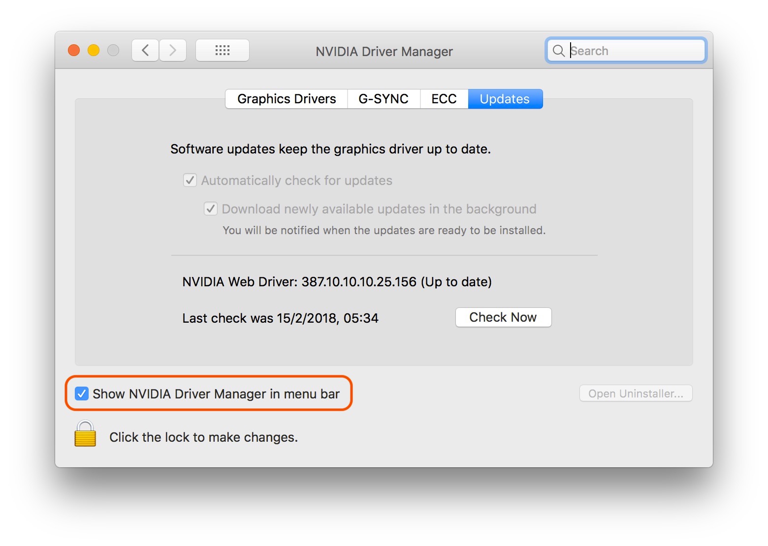

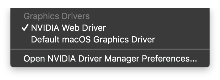

After successful driver installation (before restart). There should be two Nvidia logo on the menu bar. And one of them can be used to select the driver.
However, I believe you have to enable the menu bar Driver Manager.
If you keep the menu bar Driver Manager disabled, you should able to select the web driver by terminal command.
Code:
sudo nvram nvda_drv=1

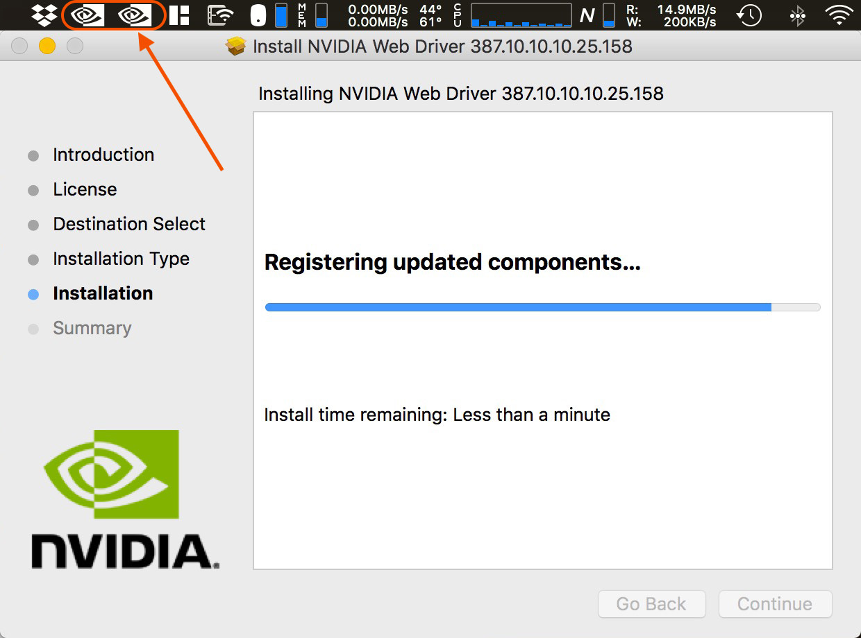

Just made a screen capture to show what you should see if you did it correctly.
What I did is
1) Download the latest web driver. For today's case, it's the version 158 driver. (keep it at the default "Downloads" folder)
2) Rename the newly downloaded driver to NV.pkg
3) Open Terminal
4) Enter "pkgutil --expand ~/Downloads/NV.pkg ~/Downloads/WebDriver"
5) There will be a folder called "WebDriver" inside your "Downloads" folder now
6) Inside that folder, there will be a file call "Distribution"
7) Open this file with TextEdit
8) Search "17D102" (or whatever the web driver builded for)
9) Replace it with your current OS built number (in my case, 17D47)
10) Save the file
11) Back to terminal
12) Enter "pkgutil --flatten ~/Downloads/WebDriver ~/Downloads/WebDriver-fixed.pkg"
13) Enter "sudo softwareupdate -I --all --verbose"
14) Wait, until terminal shows "You have installed one or more updates that requires that you restart your
computer. Please restart immediately." DO NOT RESTART!!!
15) Go back to "Downloads" folder, double click "WebDriver-fixed.pkg"
16) Let it install, "allow" it if required (or let it continue if there is any pop up). DO NOT LET IT RESTART!!!
17) You should see there are 2 Nvidia logo on the menu bar
18) One of them should be selectable, and shows that you are with the web driver.
19) Select Apple driver, and then select web driver again (in other words, recycle it).
20) In terminal, enter "sudo nvram nvda_drv=1" (to back up the web driver selection)
21) Now you can let the web driver installer to restart your Mac
For today's 17D102, my Mac require about 7 min for this "restart". So, be patient. I still highly recommend you have a remote control (or VNC) setup as a backup way to confirm if the OS update is completed (In case the web driver is not working). But as long as you have SIP enabled, this update should be fairly straight forward. The Nvidia card should work on this 1st restart straight away.
