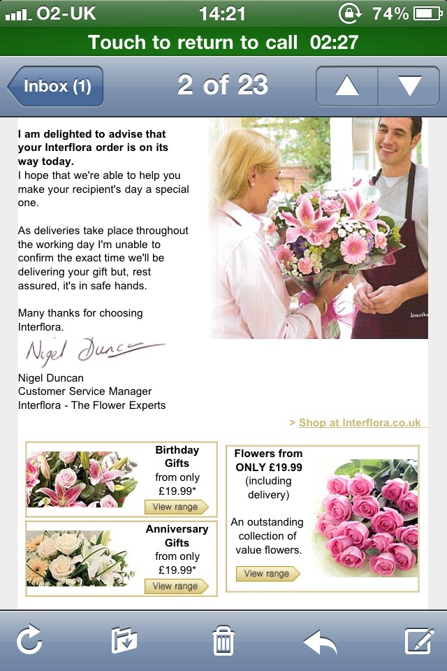

I have an iPhone 4 on the O2 network and was making a phone call today.
At the same time, I had to keep a web page open and viewable on screen(so that I could refer to an order number for some flowers!).
However, once the web page was displayed and the phone call actually connected, my iPhone showed up a message displaying 'data connections not possible whilst making this call' (it was an 0845 number - if that makes any difference?!)
If you check out the screen shot - you'll notice that I have the phone call active but NO data connection??!
I thought the iPhone 4 COULD do both of these at the same time?? Or am I missing something?!

The Iphone 4 can do, how it works though is you must be able to use 3G as 2G can not handle voice and data I believe.
I have no problems doing both.
If it was on an edge network then it can't do voice and data at the same time but on 3G it can handle it. To my experience anyway.
Works with AT&T, no problem.
Doesn't work with Verizon model. Weak.
Is O2 GSM? Should work then.
Of course, assuming you are using 3G network.
You have to have a 3G or wifi connection to do voice and data at the sometime. If you have a GPRS or edge connection you can't do both.

I am guessing you are on O2's GPRS or EDGE network.
You can only do voice and data at the same time if you are on a 3G network.
