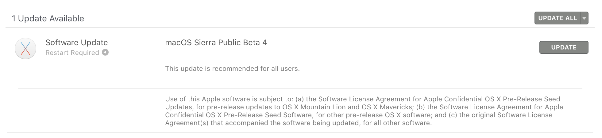

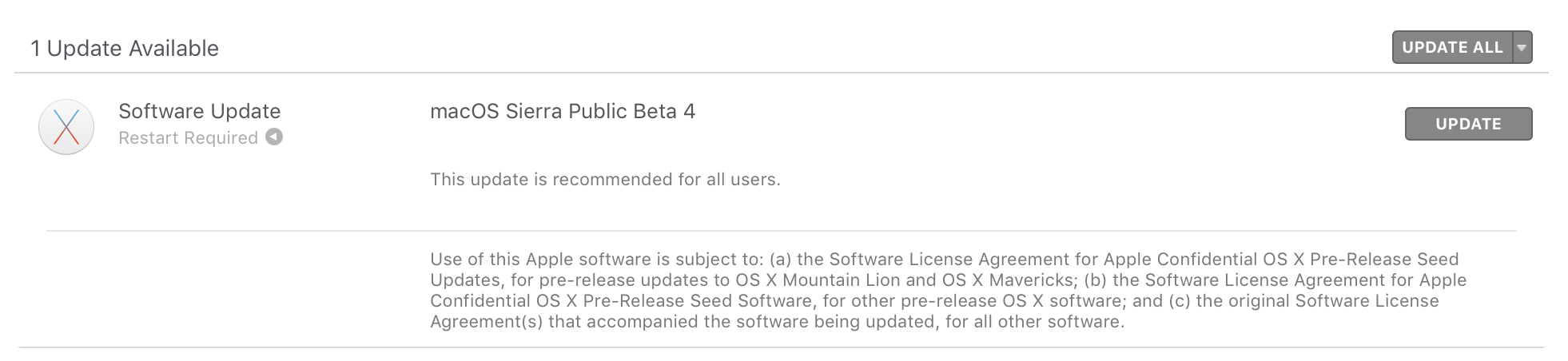

Anyone having problems updating to Sierra PB4?
Running a late 2013 rMBP, currently on Sierra PB3 (build 16A270f). No problems with PB3, but the updater in the App Store does absolutely nothing. One update is showing, but clicking the update buttons does... nothing. I get the "Some updates need to finish downloading before they are installed" dialog box, but there is no progress bar.
The Apple menu shows the "one update" lozenge next to the App Store... item.
Restarting makes no difference.
I kinda don't want to be stuck on PB3!

Same thing happened to me but in my case a restart fixed the issue. Working in beta 4 now.
@zen. Guessing maybe, just maybe, you clicked update, then didn't see any change, so *bang* you reboot and rinse and repeat that a few times?
It wouldn't surprise me if Apple had some sort of a back off mechanism built into their system for people that keep killing their App Store downloads out of impatience.
Have you tried leaving it alone for a few hours, after a fresh reboot, with App Store running? (no touchy!) 😉

If you have trouble getting the update via the mac app store you can get it via direct links instead. They can be found in apple's developer forums.
Boot once in safe mode, then normal mode.
If App Store remains problematic then quit, and instead use Terminal to run the following command. Be prepared to enter your admin password:
sudo softwareupdate -i -a
Thanks to everyone for the advice. I was about to try the terminal trick, when suddenly my Mac said it wanted to restart to install... so it did. It seems to have downloaded the update with no progress bar or any other indication that it was doing it, so now I am on PB4.

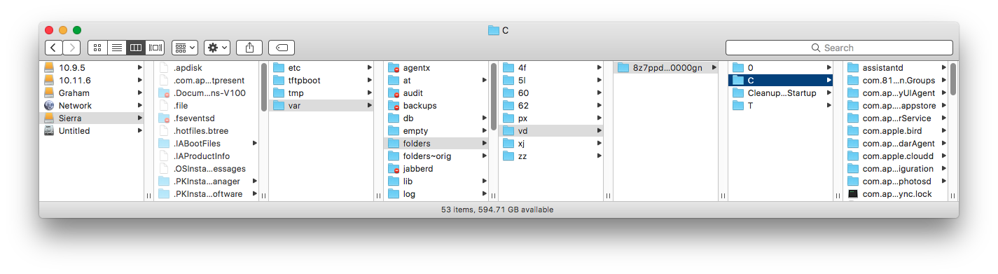

/private/var/folders/zz/zyxvpxvq6csfxvn_n00000s0000068/C/
The path to that type of private cache directory includes personalisation.
To direct a person to their own private cache:
  1. launch Terminal
  2. enter the following command
cd $TMPDIR ; open ../C

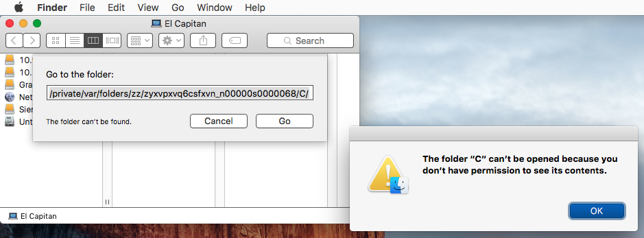

Well, funny enough, I wasn't the one to source it, yet all of us were able to find it in our tree (it's not the temp dir variable). That's a different path.
… all of us were able to find it in our tree …
Its presence is sometimes irrelevant.

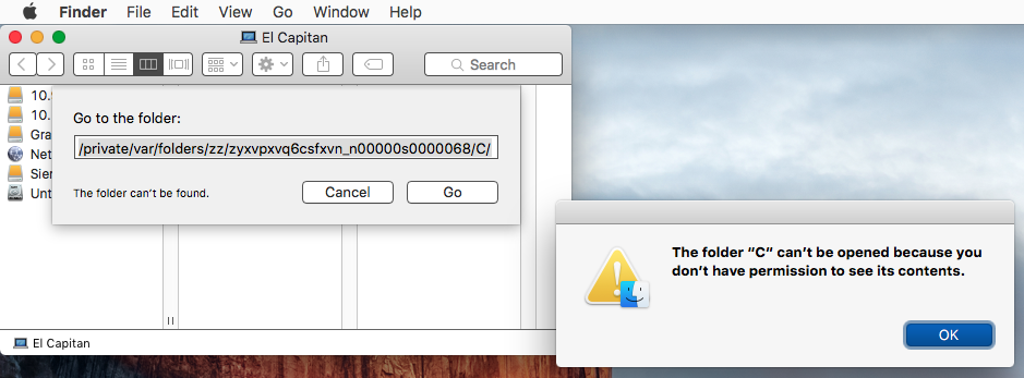

Not everyone shares that one cache directory. For example, with the account that was created during a first run of the operating system:
… (it's not the temp dir variable). …
If you ran the command, you might have realised that it opens a cache directory (not a temporary directory). This may make things clearer:
cd $TMPDIR ; cd ../C ; open .
Well, it's helped a lot of people identify if they got the update or not showing up in their App Store (over on the "unsupported Macs" thread, this has helped a lot of people identify when they can use to the tool to patch the update).
Maybe it's only consistently there on Sierra beta installations? (which is what we're looking at).
$TMPDIR - so, you're saying this environment variable isn't for the temp directory? Ok.....
Your 3 line script provides a directory which doesn't have a com.apple.SoftwareUpdate directory, so how would this be relevant to helping people finding out if they're getting the update or not?

Neither a script, nor three lines. With respect – and I appreciate that not everyone will be comfortable at the command line – @fischersd, if you do not already realise such things, then you'll not (yet) understand how the one-liners in my earlier posts will reliably open the required cache directory.
I have been working with such directories for years; much of that time was spent on AppleSeed projects for Mac OS X.
Here's a Sierra example that shows the wrongness:

Whether you call it a script or a batch, the semicolon is the new line indicator, separating your code (no matter how simple that code is).
Yes, I'm quite comfortable at the command line - I've been in IT a little over a couple of decades and playing with various OS's a lot longer.
So, that last example, you're just trying to demonstrate that you don't have the permissions to view the directory? (what's your point?)
Reactions: grahamperrin
What UID number do you get from the string of commands in my previous post?
what's your point?
The aim is to reliably open the required cache directory, in a user-friendly app – Finder.
With Finder, it should be easy to see and browse folders such as softwareupdated.
Specifying zyxvpxvq6csfxvn_n00000s0000068 within a path is not suitably reliable.

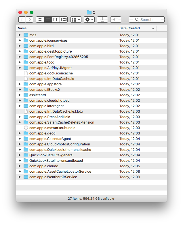

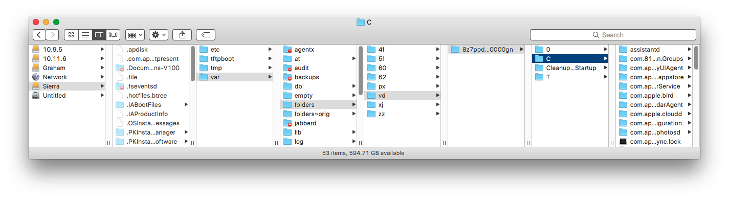

The reason for my first post beginning with the direction to use safe mode was:
  • it's the most user-friendly way to clear cached data that may be troublesome to App Store.
Documentation from Apple
There are hints such as OS X El Capitan: safe mode – and Mac OS X: How to troubleshoot a software issue - Apple Support gives suitable prominence to safe mode (including a link to HT201262 (formerly HT1455) – but unless I'm missing something, there's no good detailed overview from Apple.

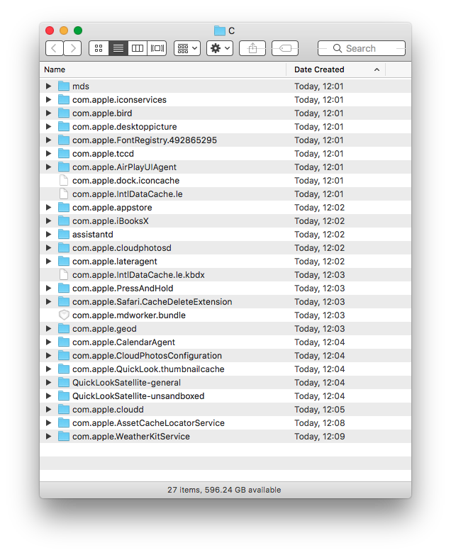

A user-specific cache folder, before and after a safe boot
