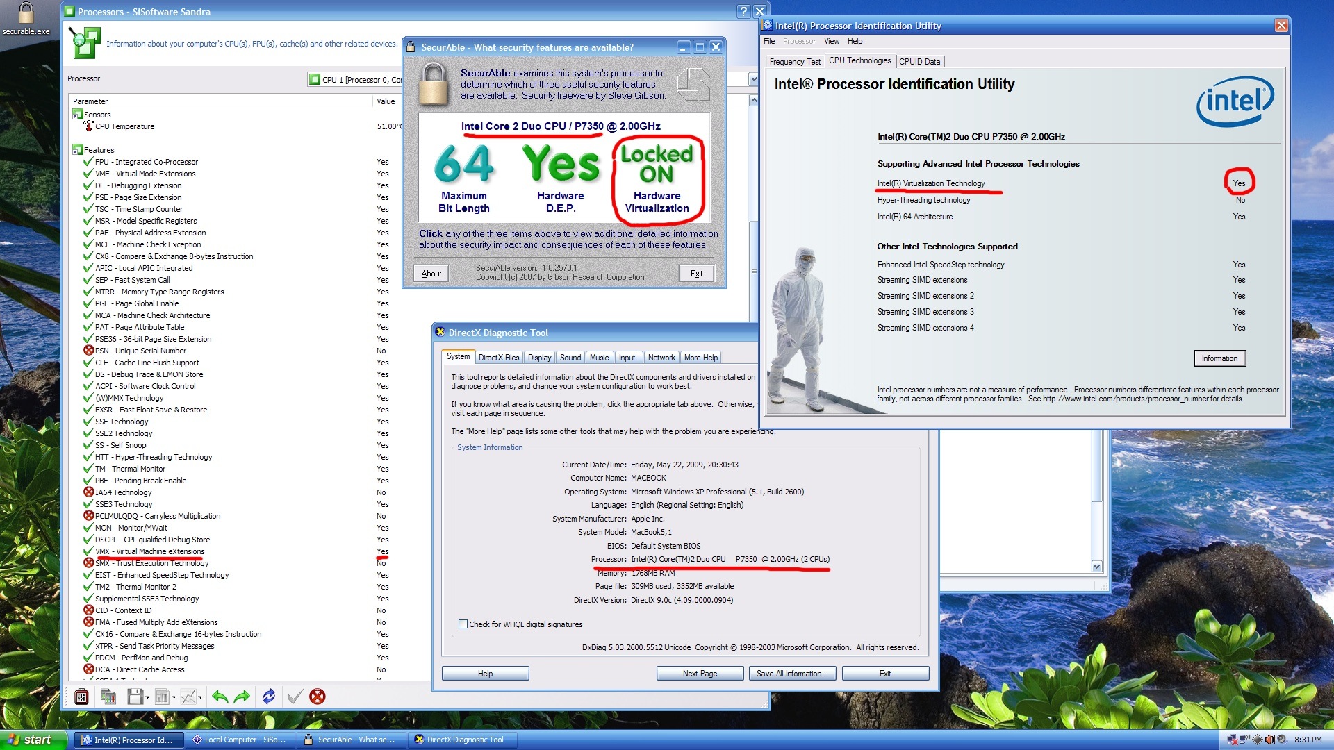

rofl I'll post a screen shot later tonight.

I wonder why the P7350 keeps reporting VT support then. In before screenshots.
I love it when people tell you "NO! YOU'RE WRONG! YOU DID NOT SEE WHAT YOU SAW!"
There Click Me, if you can't trust magazine and other sites, at least trust Intel, they know, they made the CPU.

Photoshopping screenshots. Right 🙄
All I did was underline the parts to show that you're wrong.

Okay you've got a number of things going against you.
First, you have no denial from Intel that the processor supports it.
Second, you have Intel's OWN software confirming that it DOES support it.
Third, you have two pieces of very highly respected software also confirming that support.
Fourth, you have a blog post showing OS X confirming the support as well as that user running software in OS X that REQUIRES VT/VMX support. It would NOT be possible for that user to run 64-bit Windows in a virtual machine without VT/VMX support.
Fifth, you can go to Ars forums and others where other users with 2GHz UniBody and white nvidia MacBooks also run the same software I did confirming the chips support.
So are you still going to say "no"?
Edit: I'm not saying that all P7350s support VT/VMX. It's obvious they don't. This is one of those features where its up to the OEM to support it. In fact, theres a thread over at Ars where an actual Intel employee posts talking about how its up to OEMs to enable support for features on the hardware they build. There are other posters in that thread also discussing how they've had BIOS updates from their system manufacturers disable features like VT/VMX on certain processors that previously had support.
But in this case, the P7350 in the unibody and plastic MacBook DOES support hardware virtualization.
Keep in mind that the Core Duos were not supposed to support the technology either. Obviously they don't support 64-bit technology. Intel and Apple both claimed it was disabled on the Core Duo Macs. But then Parallels came out and showed that it WAS supported.
