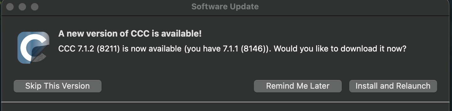

I am getting but when I click "Install and Relaunch" the update fails with "Update Error! An error occurred while trying to download the file. Please try again later." Had the update been canceled?
