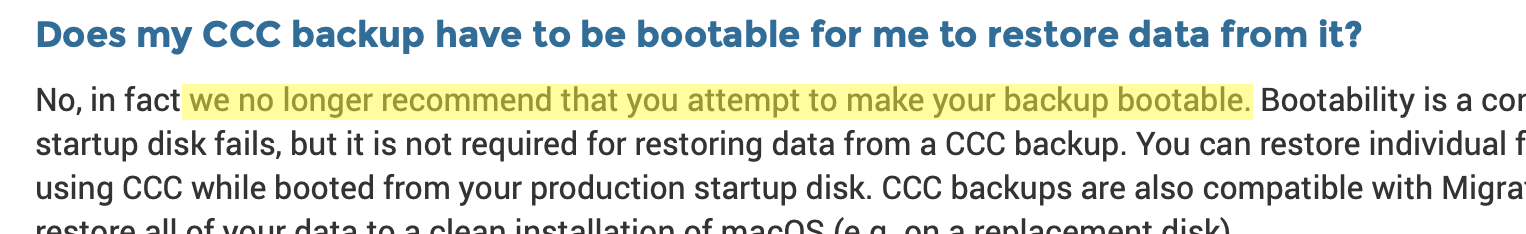

But you do need to ask yourself what purpose you're hoping to achieve by making a bootable clone. There is no good reason to clone the system. Your clone only needs to backup your personal data for protection. Apple has protected the system enough that it cannot become corrupted nor modified in any way whatsoever. Bootable clones are becoming a thing of the past. Even the maker of CCC explains:

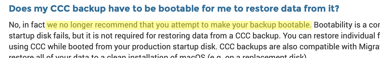

Not to be argumentative, but..... I think you need to re-read the FAQ. It is saying that in order to have a useable backup, it does not have to be bootable. It does not say that you shouldn't create a bootable clone. In my case, the clone is not my backup. I do my backup as Bombich recommends.
