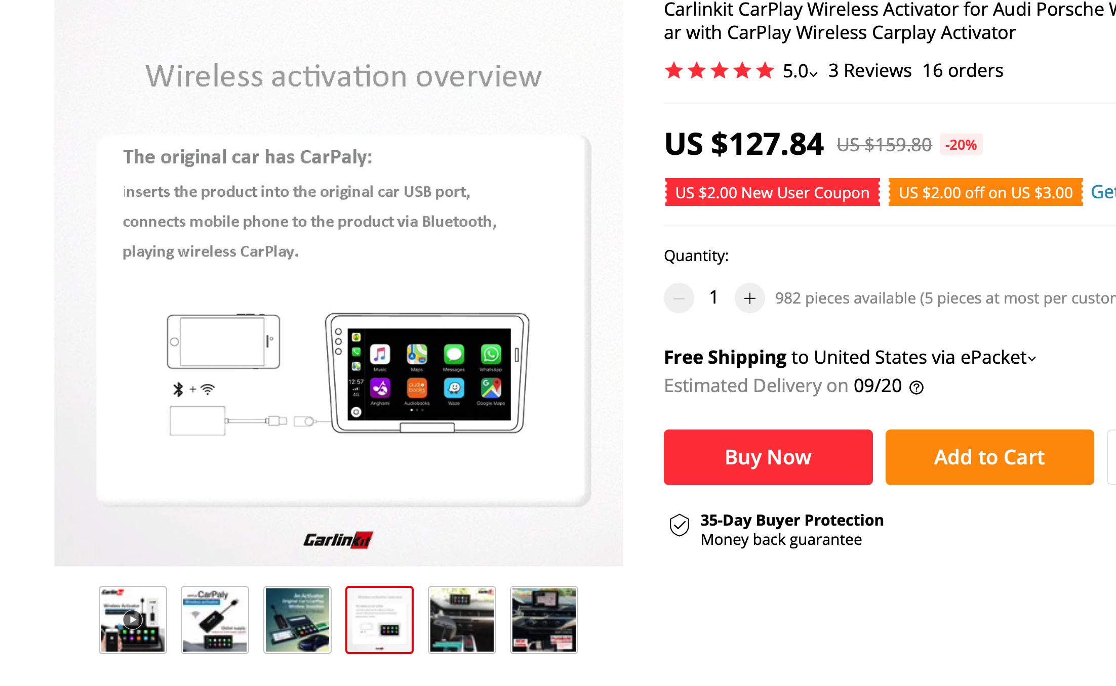

Hard to work out what it is, if it converts one of these 3rd party Android units to allow CarPlay, or if it allows wireless CarPlay I'm not 100%. There's a few of these about to get CarPlay on a non-CarPlay unit, ie Android unit.
Looks like this and says specifically for Android head unit only.
£28.53 25% Off | Car Link Dongle Link Dongle Universal Auto Link Dongle Navigation Player USB Dongle For Apple Android CarPlay

That looks more like it! Wireless activator even sounds what it needs to do.
Yes let me know please!

I wonder how it works, asked but didn't answer. Apparently you connect to the dongle via Bluetooth. I just wonder if Apple could stop it easily on an iOS updates. Can't imagine audio manufacturers will be to happy if this works.
If not works as expected, I wonder if others can do it and maybe bring price down? This is only one I've heard about, anyone else found any others?
Don't think BT will have enough bandwidth, otherwise Apple would have used BT. It would make sense if the dongle uses Wi-Fi.
It says to connect the dongle to your iPhone via BT though.
I've asked numerous question, like how to connect, does it lag etc but no reply
They probably gave you bad info. BT to for setup and wi-fi for CarPlay make more sense.
Reactions: MrMister111
Ah I see the icons now, maybe they just meant the initial connection from iPhone to they dongle is BT then thanks.

From what I read in several different listings - there are many on Amazon for what looks like the same product - this was made to connect an Android phone to a "display" meant for Androids and this "connector" would allow you to use it with an iPhone. Perhaps if someone could test my "understanding" of the connector on a car that actually connects to Android phones? (Yeah, I know - wrong forums.) It also said in some of the descriptions that it would not currently work with iOS 13.

I purchased the Carlinkit wireless activator for my Audi A4 with Factory wired carplay. Basically it is a WiFi to USB adaptor that uses Bluetooth to initiate the wireless CarPlay. I purchased it as the A4 comes with a wireless charging pad, but you still have to plug in for CarPlay. I paid around $126 for it. It does work, with a few caveats. Firstly, the text that initially appears when your phone is connecting is in chinese. Luckily my better half translated it for me. Secondly, the audio is scratchy for the first 10-20 seconds; then it works as you would expect. Also, on the Audi, the dash display shows “unknown“ for the track and artist (but the CarPlay display on the center display works just like wired CarPlay). Lastly, it was a bit of a pain to purchase. I had not used Alibaba to buy anything before, and it really was setup to be a business buying these things in bulk, not a one-off like me.
All-in-all, it was worth it; but I can only verify it working on an Audi (even though they mention other makes & models). Just don’t expect much in the way of good documentation. I was able to talk to the seller through WhatsApp, and they have been good so far with support, firmware, etc., but it is a very manual process.
