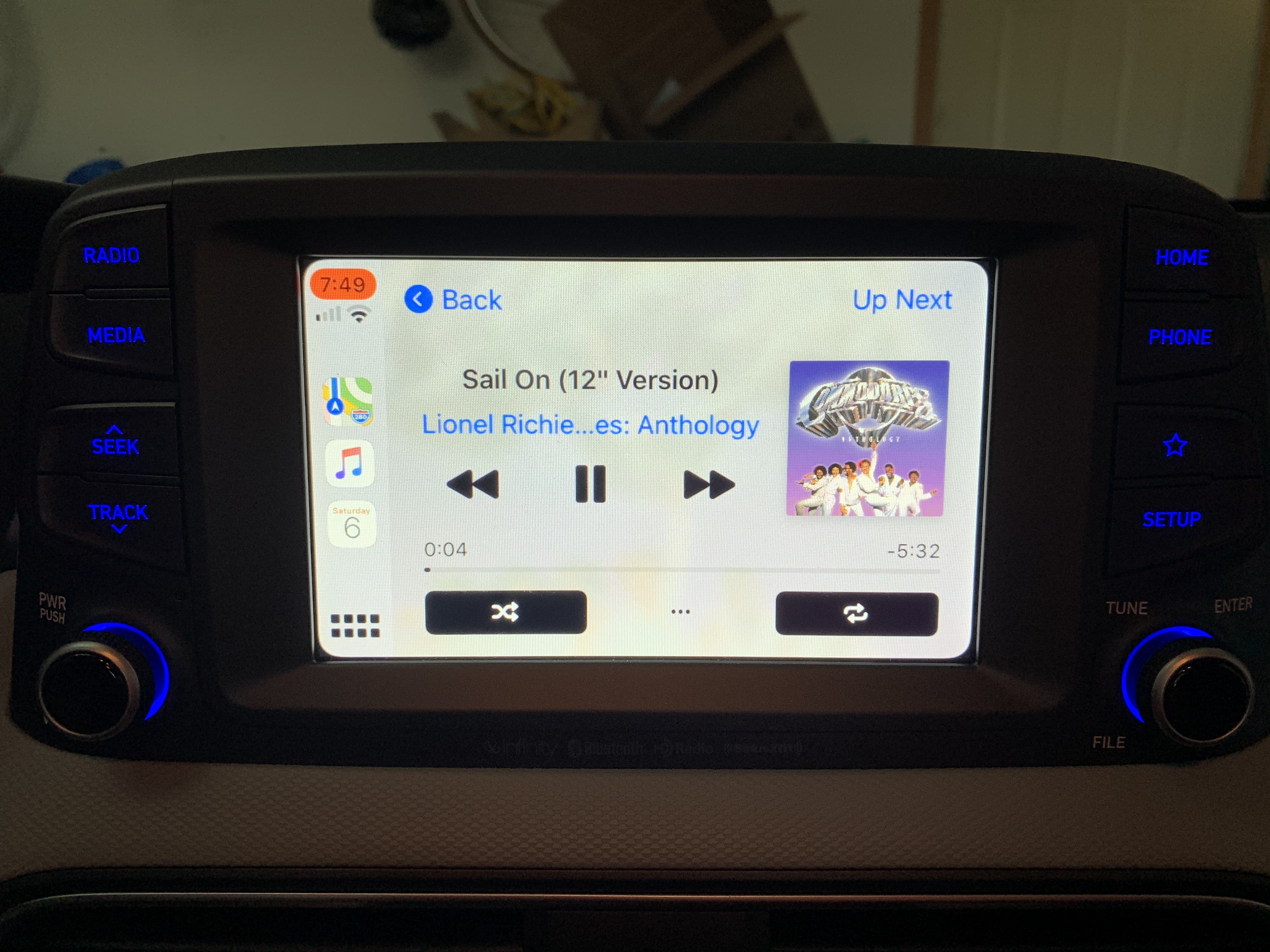

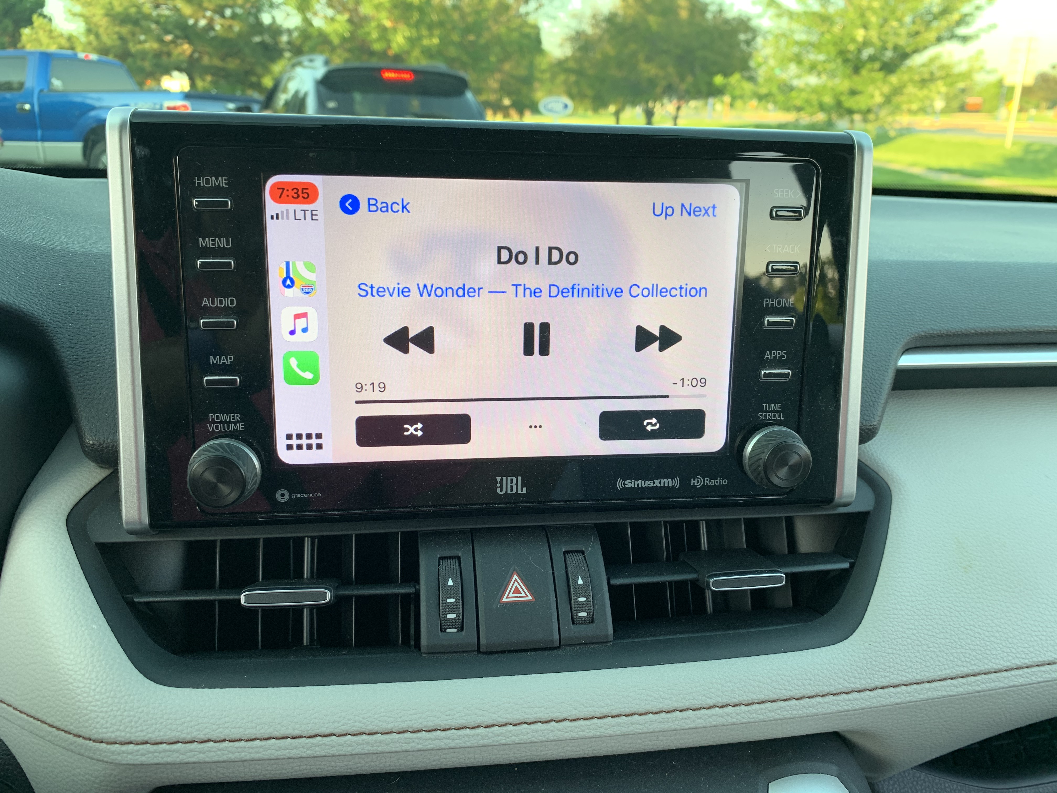

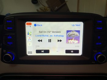

I'm finding CarPlay to be inconsistent. In beta 2 the new album art style with the blurred image in the background with a full color tile to the right of the title worked in both my 2019 RAV4 with an 8" screen and my 2019 Hyundai Kona with a 7" screen. Now in beta 3 the full color title to the right of the title doesn't show in my RAV4 - it's back to the usual blurred art in the background. The Kona screen, however does show the full color tile tile, despite being a smaller screen.
