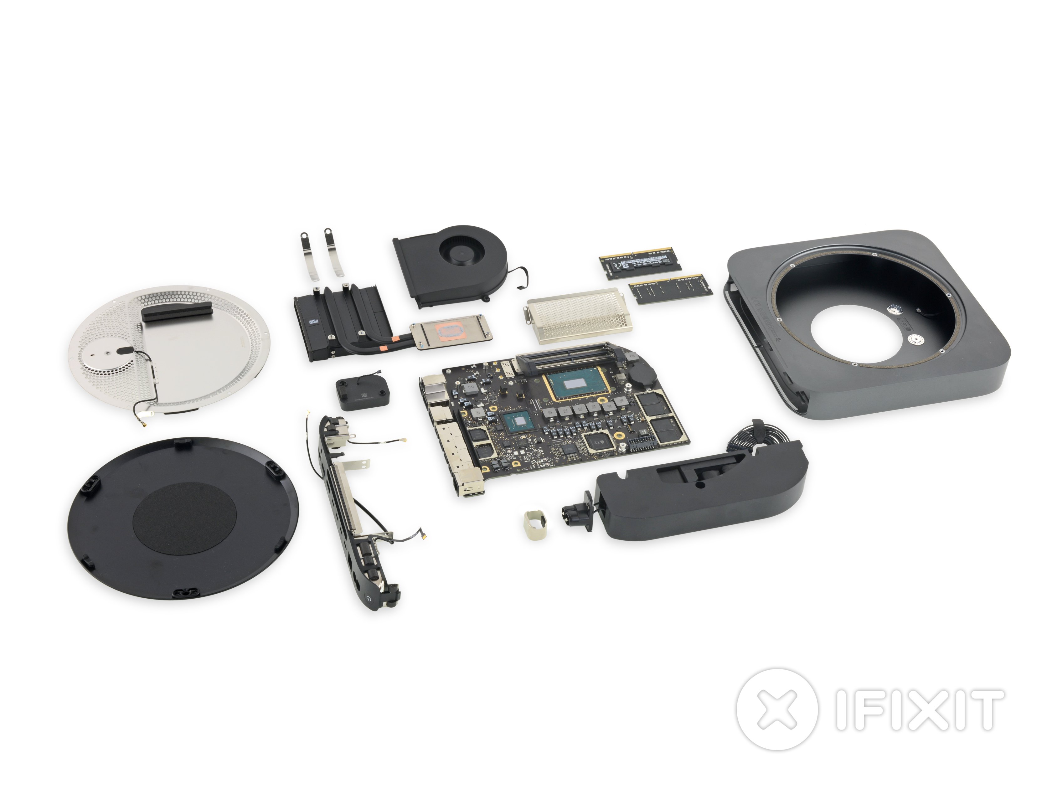

iFixIt teardown shows the mac mini has a MegaChips MCDP2920A4 DisplayPort 1.4 to HDMI 2.0 converter to make the HDMI port function:
I bet this is the firmware that is being updated. Anyone try contacting MegaChips? They are in San Jose:
Apple TV 4K uses same chip - curious if the displays that don't work on 2018 mac mini also fail on Apple TV 4K.
