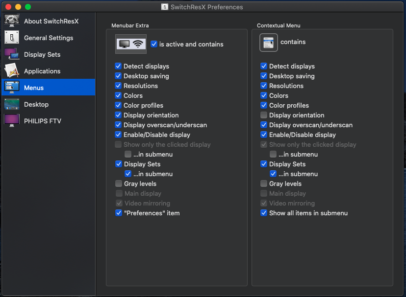

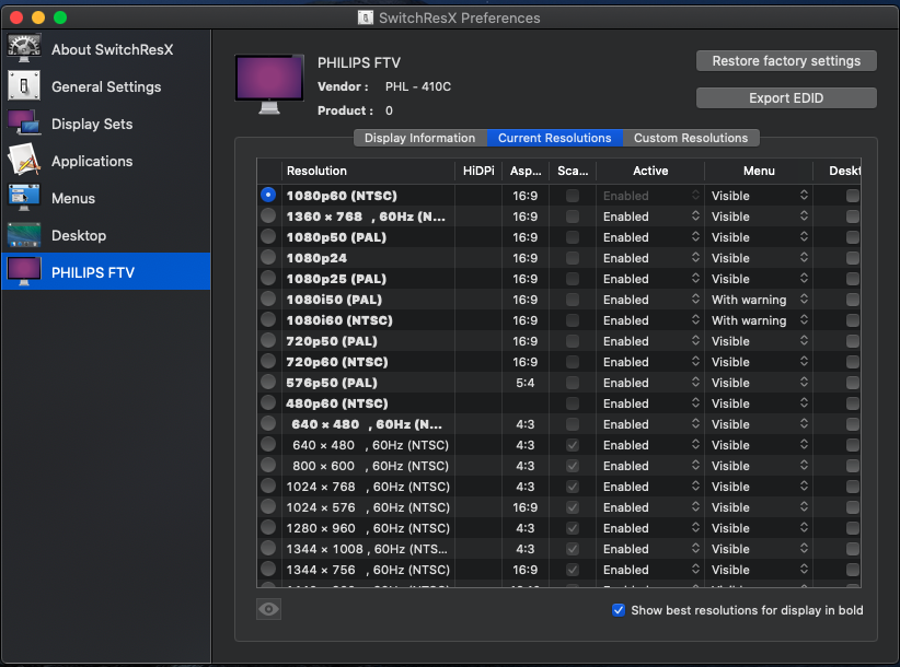

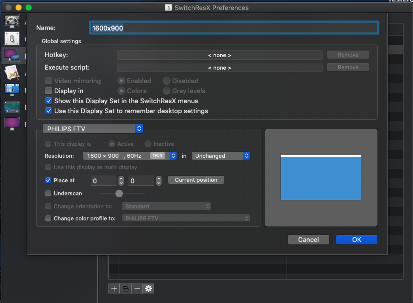

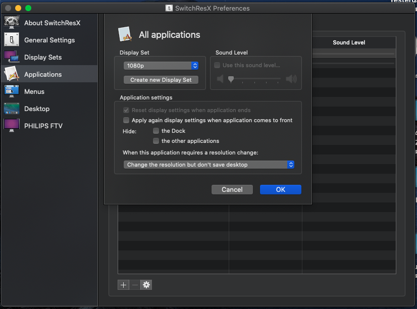

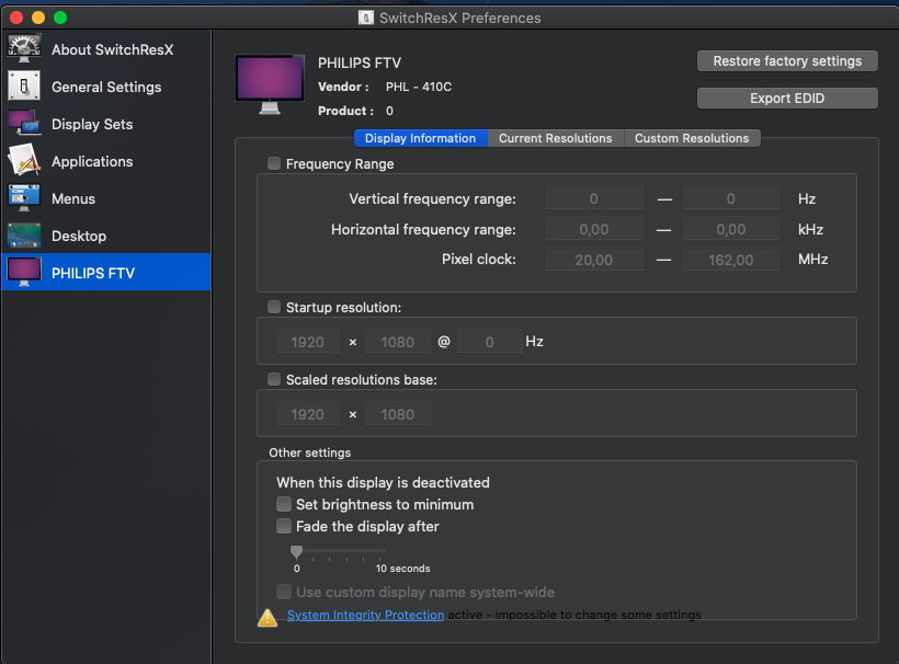

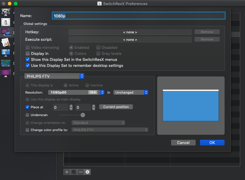

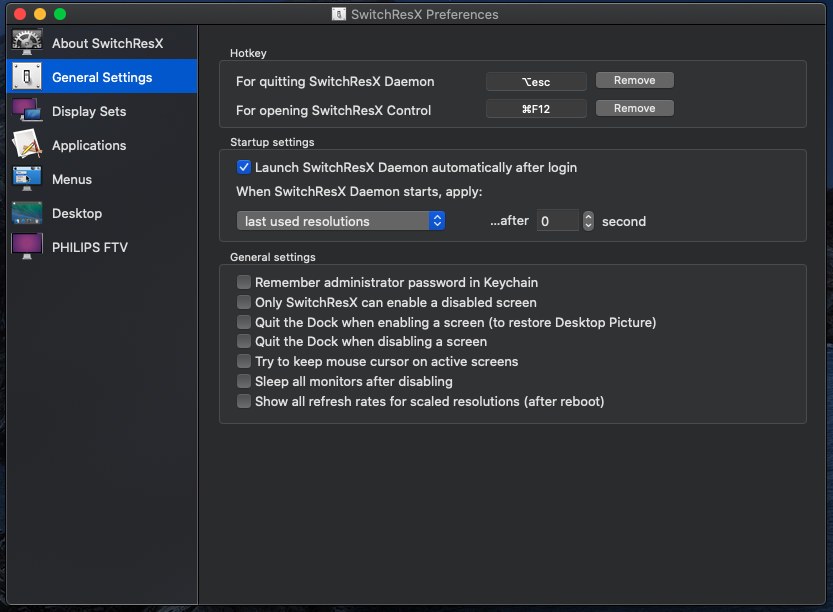

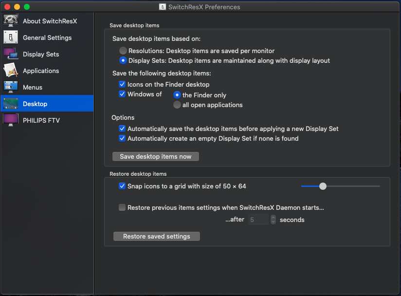

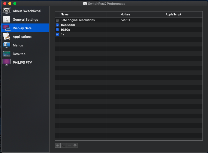

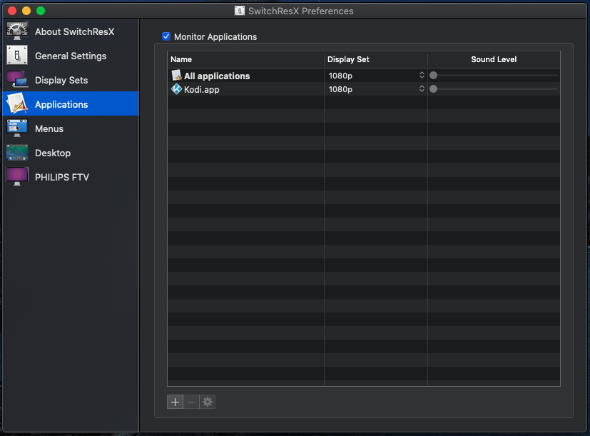

THIS WORKED FOR ME!
I used SwitchResX in my Mac Mini (Late 2012) + a 47-inch Philipps TV with an HDMI - HDMI cable.
I'm running MacOS Catalina 10.15.3 and I since this app worked for me I think it may work for others experiencing the same issue as well.
It dind't work out-of-the-box, but it did after changing the settings in the app and finally it got it working.
I hope it helps!
Reactions: Synchro3
