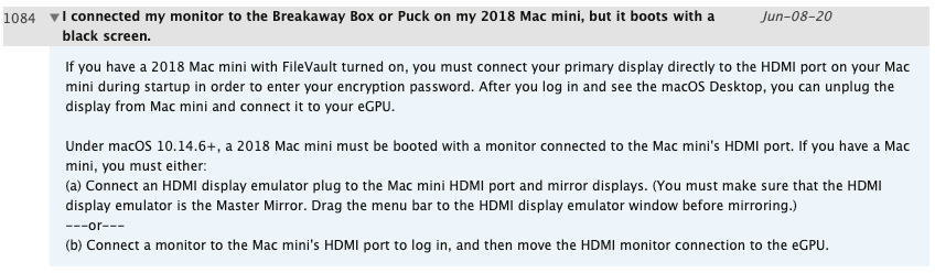

Sadly friends, the issue still persists. But Big Sur is pretty sweet, otherwise! Attached is a copy of my silentknight readings showing EFI, firmware... etc has not really changed.
