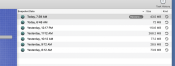

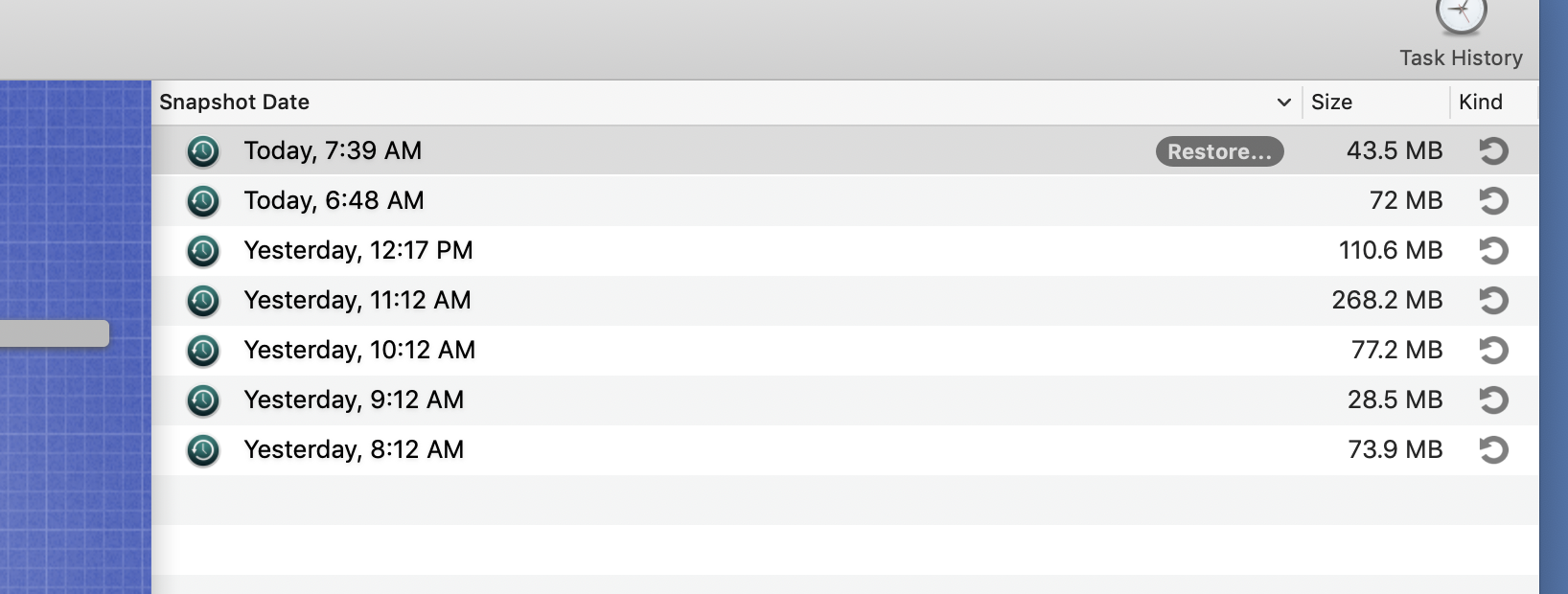

I too was confused by all this when CCC rolled out the snapshot support.
I finally convinced myself what was going on by doing some testing.
You can see the TM snapshots here in CCC. Then run this command in Terminal to delete the TM snapshots. Then check in CCC again and you will see they are all gone. So it seems pretty clear these snapshots CCC is showing are just the TM snapshots and not something CCC is creating on the source drive.

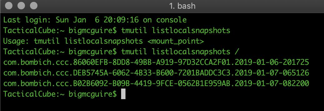

Oh hey, check this out. So I turned on CCC snapshots, I manually wiped out TM snapshots like you mentioned --- and it shows this:
Is this new with CCC ? Almost looks like they're identical TM snapshots, but with the CCC name.
Hmmm... so it does look like CCC may be creating its own snapshots? Confusing.
Yeah, I was confused by this also. I contacted Bombich and he confirmed that CCC will indeed create snapshots on the source drive unless you turn them off in preferences. I also have the CCC SafetyNet on. Thanks for the terminal command, it removes both the TM and CCC snapshots.
