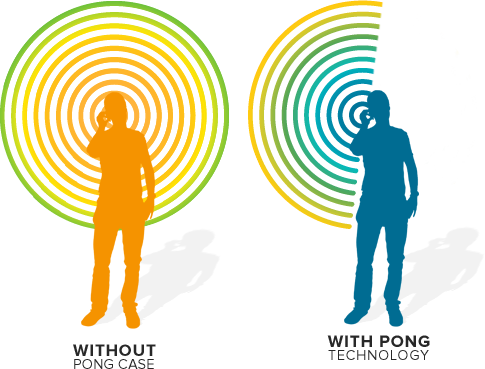

Thanks for your two cents. Any further opinions on their Pong Case? Do you think it doesn't work or it doesn't matter?
http://www.pongcase.com/technology.html
arn
SAR is heavily (HEAVILY) dependent on how close the phone is to the body tissue. So when SAR is measured they have to put the phone right on this mannequin head filled with a "body-like" liquid, and then they measure the E-field, which then becomes your SAR number.
If you move the phone away by about 2mm, you get a huge SAR reduction. The pong case works because the case itself adds some gap to the actual measuring mannequin. Any case that has some front side buffer would do the same thing, pong has no technology that actually does anything. So, if you have an otter box case and measured the SAR, it would be lower than the iPhone by itself, even though that wasn't even their intent. Probalby lower than the pong case too, just because its thicker.

Interesting, it seems pong has the same parent company as Reach79. Looks like same tech.
attachment.php
This is likely exactly what this could do if it were designed correctly. Now picture that the cell tower is to the "right" of the people, now only the person without the case will get any signal.
Now the cell tower is on the "left", and the person with the case will see "better" signal then the person without it.
Now you are in a car driving and can't just turn your head to maximize signal.
Seems like a bad idea.
That being said, if it were correctly designed it would need to be curved and this isn't...
