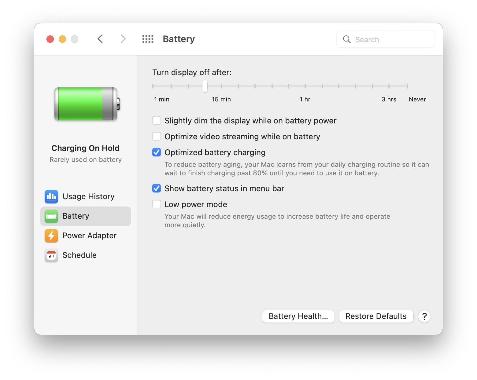

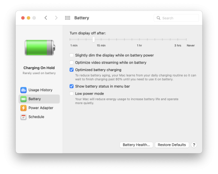

Like others said, it will be fine.
If you are leaving it plugged in like that a lot, it is a good idea to turn on Optimize battery charging so the battery is not sitting at 100% all the time.
If you are leaving it plugged in like that a lot, it is a good idea to turn on Optimize battery charging to the battery is not sitting at 100% all the time.
Does that actually work? So that it will actually stay at 80% charge level, and so that it will also return to it after you occasionally use it as a laptop on battery?

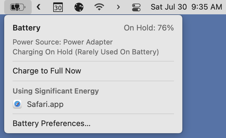

It works for me. Here is a screenshot I just took.
What I have noticed is if you use it on battery it resets the charging algorithm and charges back to 100% for a few days. Then it seems to realize you are not running on battery and allows the charge to drift down to around 80% again.
So if you are say using it on battery every two days, it will keep it up at 100%
I have never tested this, so I don't know what it would do.
I didn't know that was a thing.
