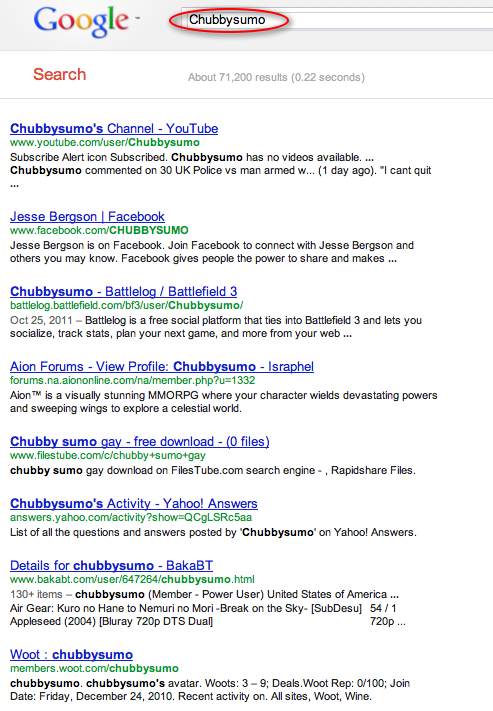

Ii look forward to adding another site under my name(considering getting it trademarked because I have used it for so long).
While you busy yourself with "adding another site under your name" or getting trademarks, many of us in this forum are more concerned with educating and helping those who come here with questions or problems. To that end we debunk myths, challenge falsehoods and correct misinformation, so those who are new to Macs won't be misled.

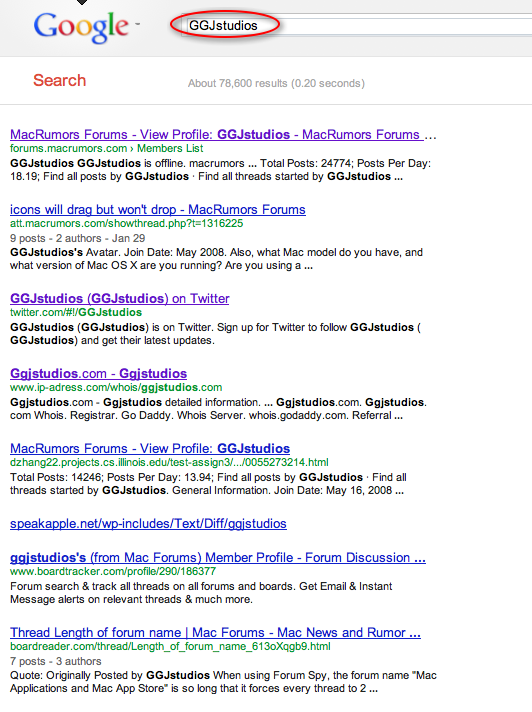

look around the internets, and you can find me(you really dont have to look to far or hard, just never had a macrumor account).
I put zero credence in internet visibility, but did a couple searches on a whim. I post them without commentary.
