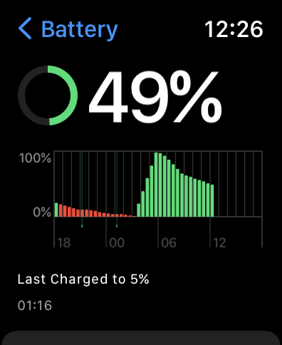

Last night and this morning i had a weird situation with charging my S7. Around 9:30pm last night the watch was at 10% took off my S4 off the charger and put the S7 to charge. Woke up during the night around 12;40am to place my phone on the charger next to the watch (Belkin 3 in 1) and to my surprise the watch was down to 3% after 3 hours on the charger, the watch never charged. Took it off the charger and placed it back and then it start charging. At 5am the time i usually wake up the watch was still not at 100%. This have never happened to me before on the S4.
There's definitely a charging problem with the S7. at first i was septic with all the people complaining. But now i see there's clearly a problem

I had the same issue last night. Woke up around 6:30 AM (for my nightly walk to the bathroom LOL) and noticed when I tapped my Series 7 it didn't light up the "night stand view". Checked the Watch and saw that it was down to about 25% (sorry don't remember what it was at when I put is on the charger). Tried again in Nightstand Mode and same issue when I got up up around 8:30 AM. Put it back on the charger after doing a hard reset (BTW - using the USB-C cable that came with the Watch and the USB-C charger that came with my iPad mini 6) but laying flat and it seemed to charge normally. Have been wearing it since around 9:30 AM and the battery is down to 84% - and that included 30 minutes on a treadmill and running the Activity app. Will try again tonight in Nightstand Mode and see what happens.
(Also - and don't know if its related or not - I keep 5 playlists downloaded to the Watch for when I walk/run/etc around our neighborhood - cell service drops in areas - and the two that I do manually for 25 songs each never seemed to update overnight like they usually do. They did update AFTER I did the hard reset.)

That day i started charging the watch around 9pm. But it never start charging until i woke up took it off then put it back on the charger that was about around 1am. Since i do 3 hours of exercise a day and 2 of those hours are on LTE it is normal to lose 40% to 50% in 6 hours for me
I seemingly had this same issue last night. Put it on charge on my beckon 3-in1. It said it was charging but noticed at 11am today it was down to 15% or something like that.
