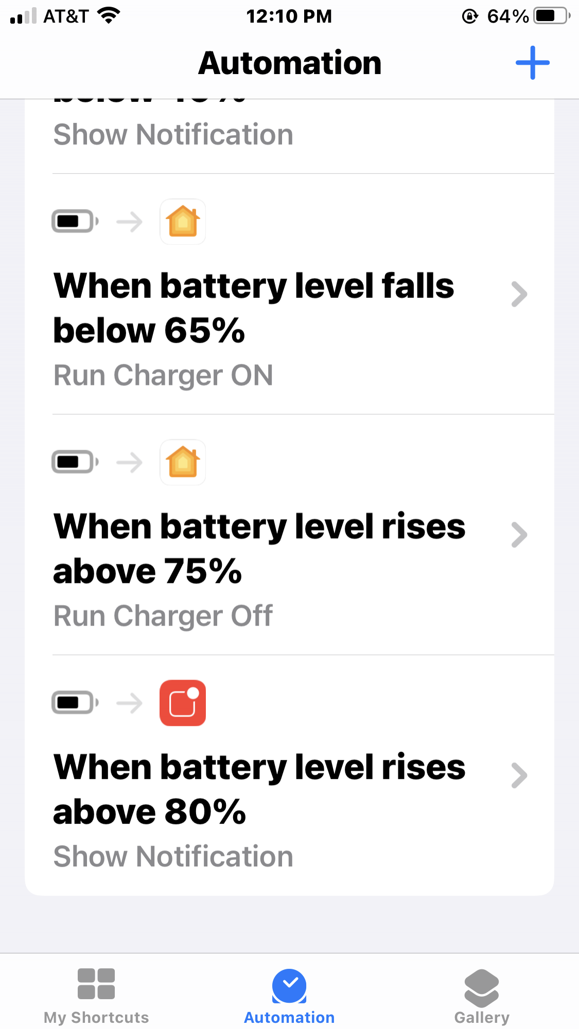

By far - like really really far, the best way to optimize your battery charging is to do as you suggest and get a HomeKit compatible power socket and set up a battery charging shortcut automation.
You can set the cut off level and turn on level to any value you want.
Tip: use the argument “when battery level rises above” instead of “Equals”.
“Equal” can be missed in the background and the charger will keep on charging, while “Above” wakes it up eventually and turns off the charging maybe a few percentage points higher- but at least it turns off.

I use a smart plug with automations also. Optimized battery charging works inconsistency even if a strict schedule is followed. I've turned it off on my iPhone and AirPod Pro's and haven't missed it a bit

I have 2 automation scripts, one that traps for equal to 80, and the other traps for rise above 80. Most of the time the charging stops at 80%.

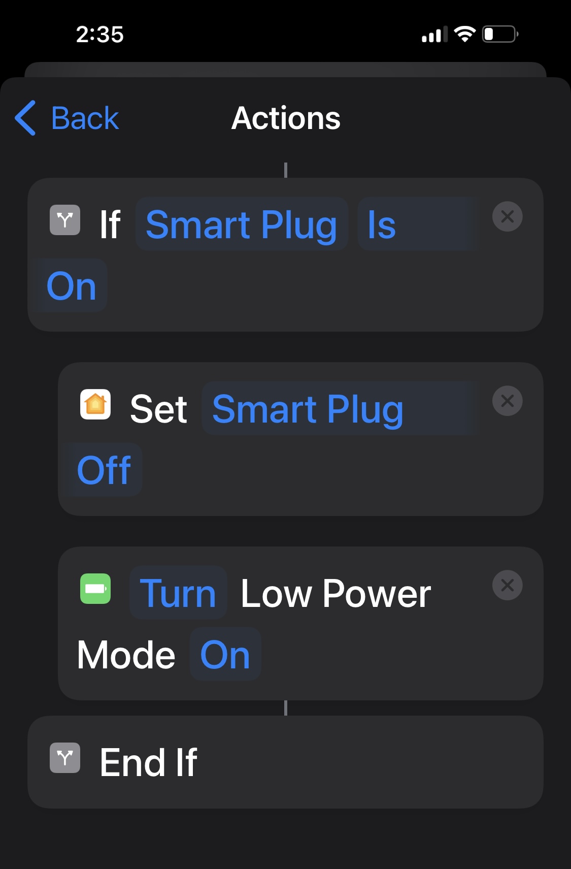

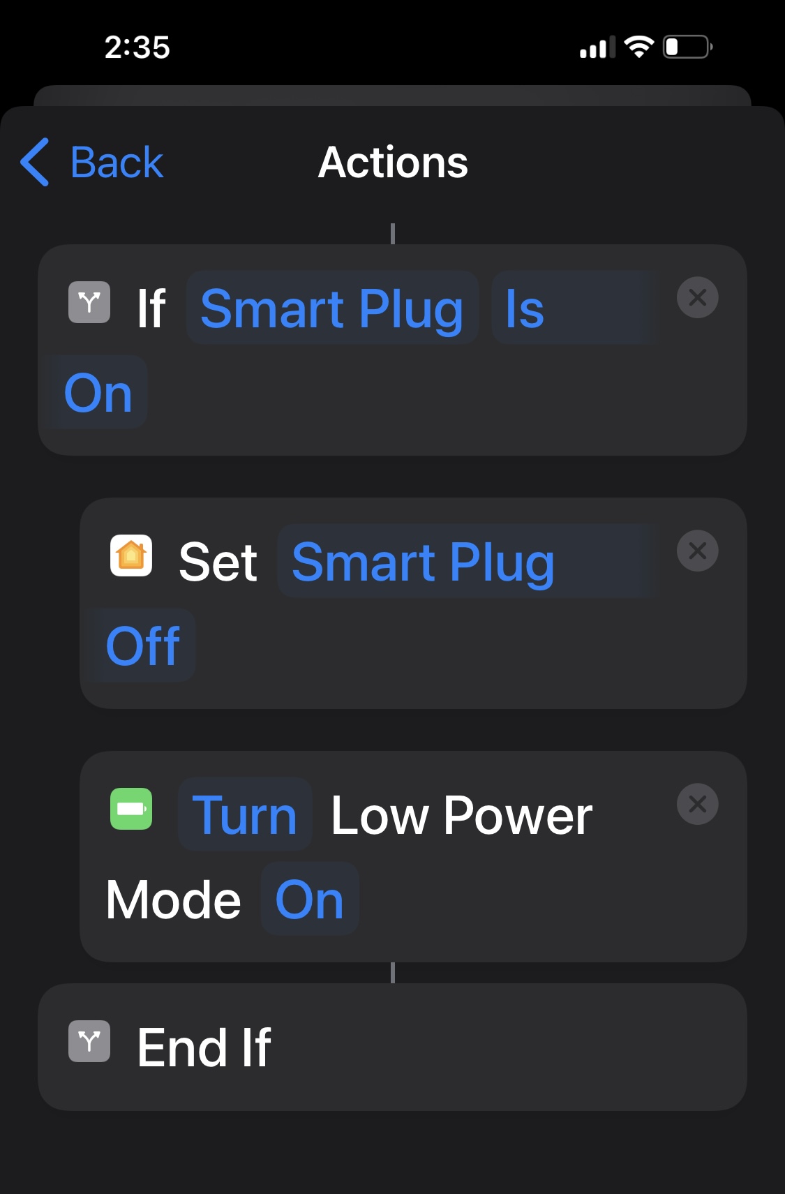

I use a HomeKit smart plug and Shortcut Automation scripts. When I go to bed and I need to charge, I plug in my phone to the charger, turn on the smart plug and when the battery reaches 80% the automation script cuts power to the charger. My phone never sits on a powered charging when the battery is charged to 80%. I even have Low Power Mode automatically turned on after the phone finishes charging. And in most cases, in the morning, the phone’s battery is pretty much still at or near 80%. I use a 12 watt charger. I follow the 80/20 rule.

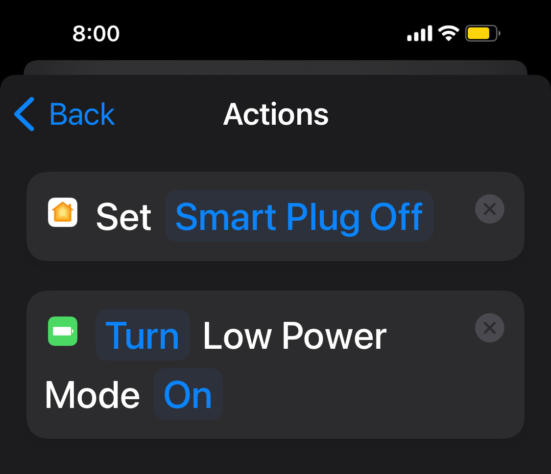

Just have the automation turn on Low Power Mode at the end of charging, your phone will be still be at 80% or very close 80% when you retrieve your phone in the morning.

I have several ways to turn on the smart plug. 1) Manually press the power button 2) Turn on the smart plug using a Shortcuts script 3) Use Siri to turn on the smart plug. I turn on the smart plug when I need it and is off other times.

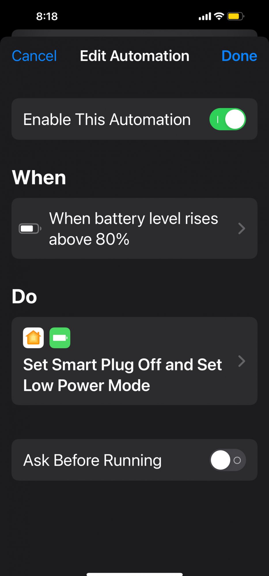

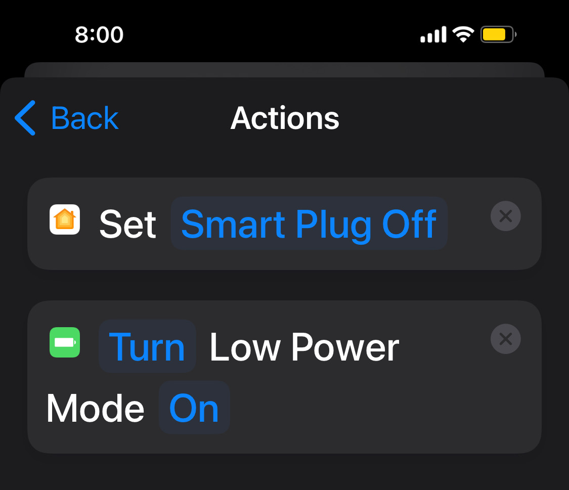

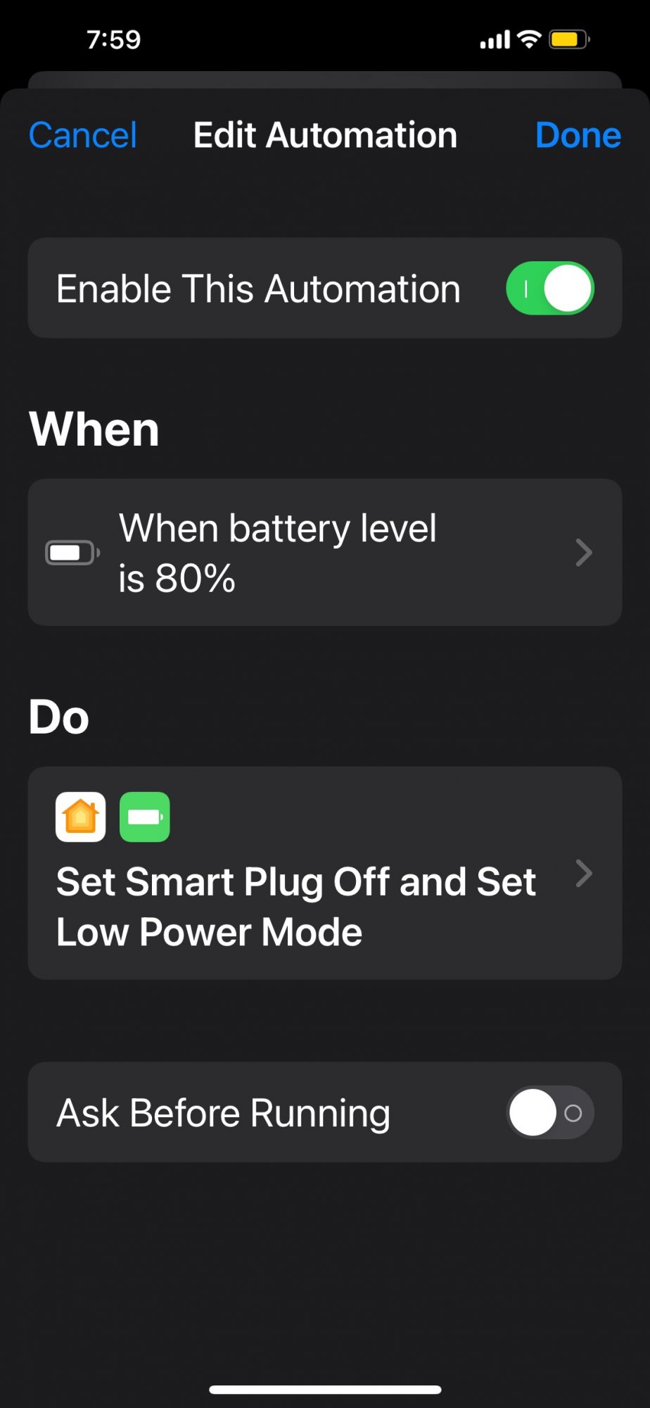

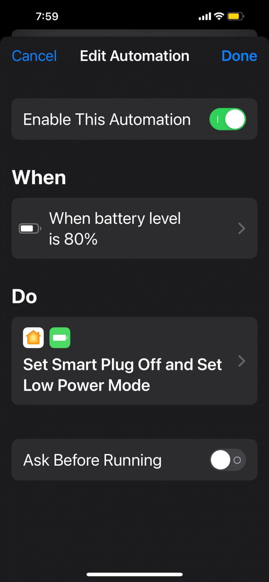

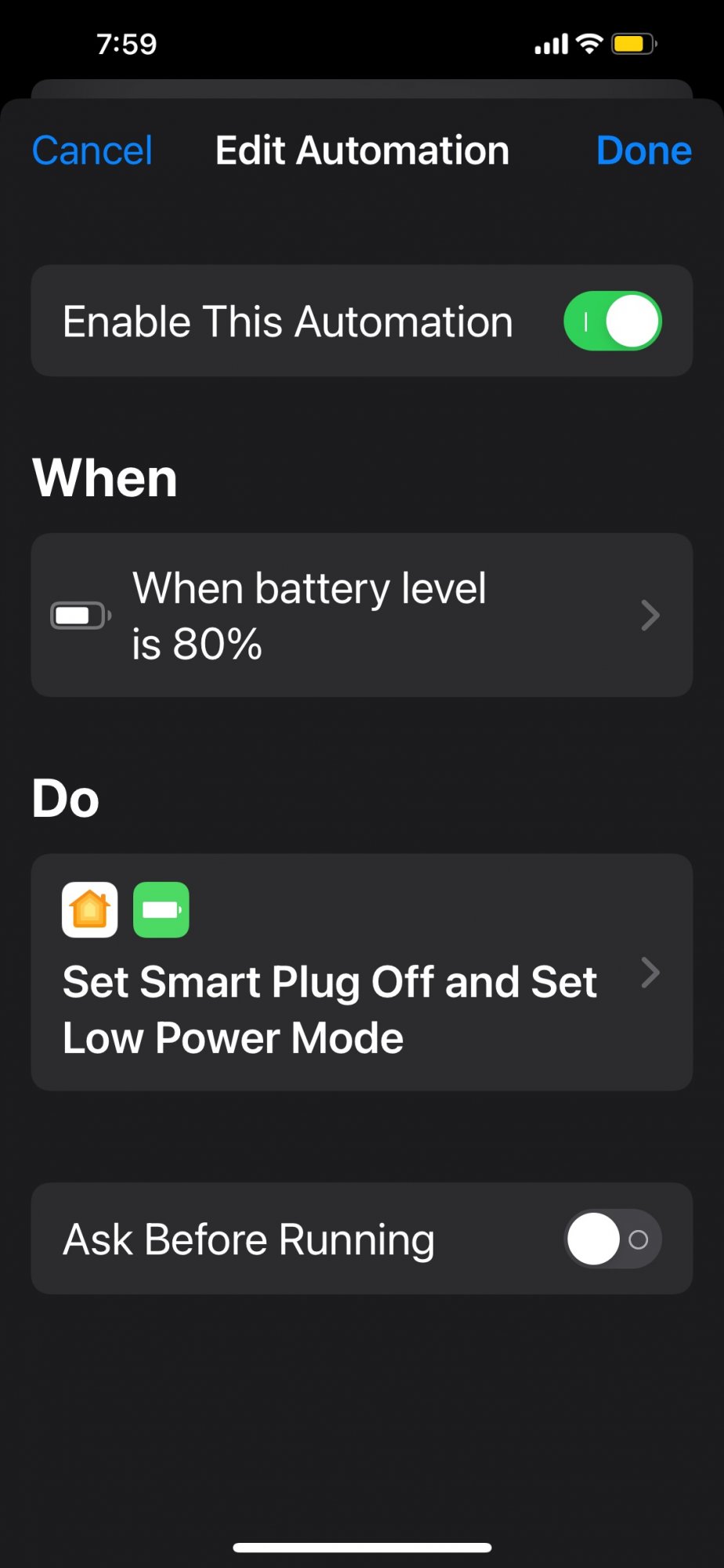

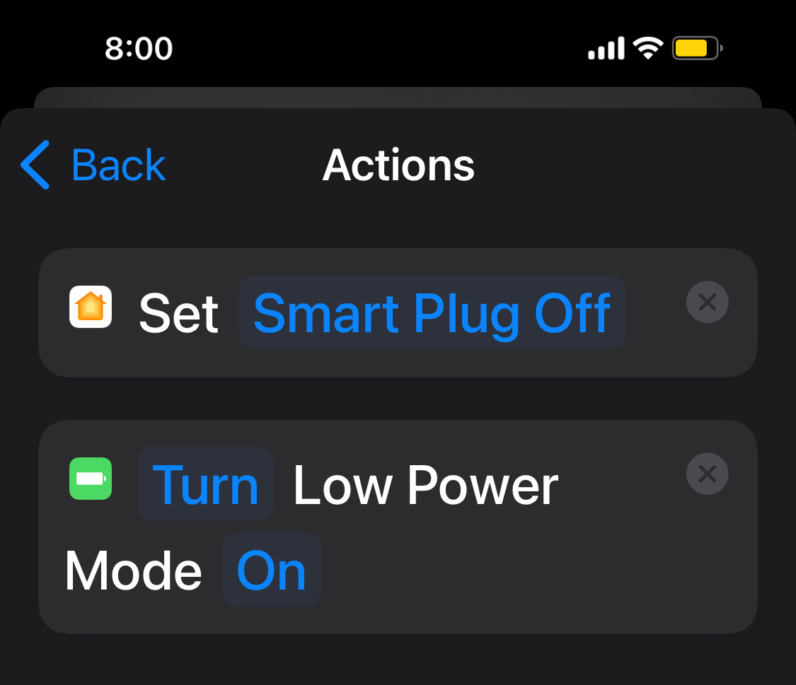

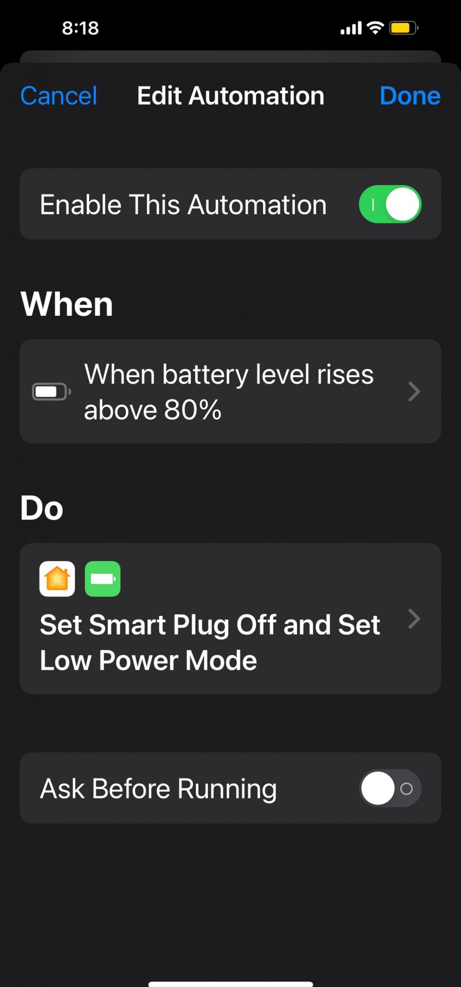

This is my Shortcuts Automation to turn off the smart plug when the battery charges to 80%. I also created another Shortcuts Automation for the case were the battery charge rises about 80%. Not very often, in my case, iOS will not trigger when the battery reaches 80%. In that case, the other automation script catches that case.
As you can see, the automation scripts are very simple.
Reactions: fp99 and Jutah

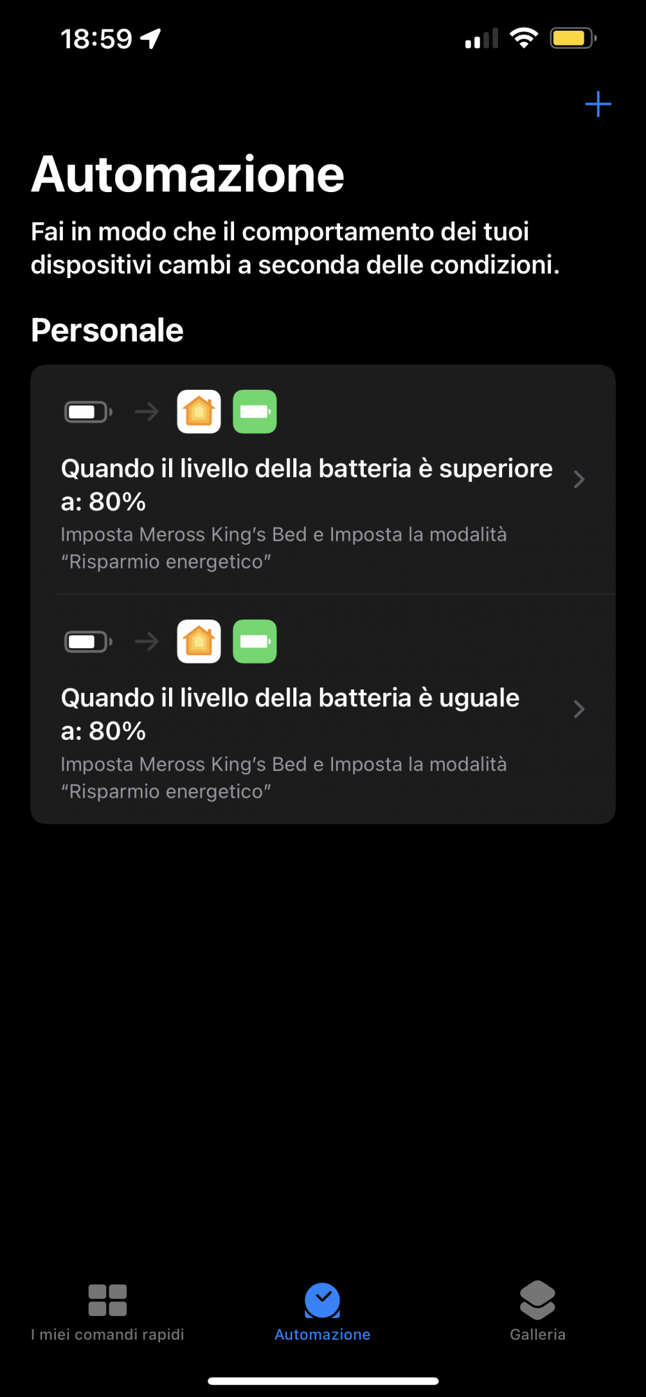

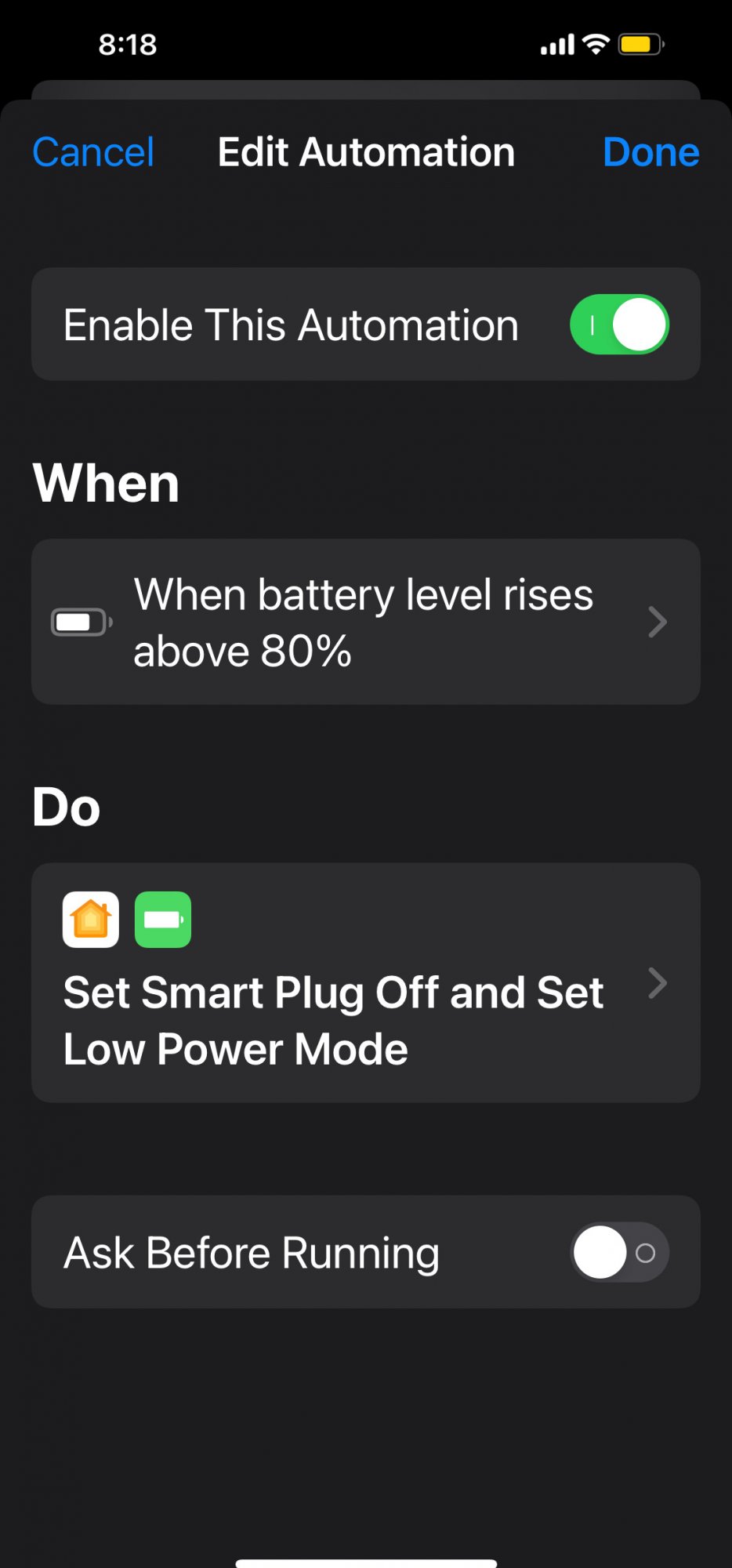

Hi Guys, thanks for the support.
I received the smart plug, added it to the home app and set the automation.
If I set just one automation it works, if I set both as suggested it works but it return me an error.. it seems that the automation trigger when the level rise up the 80% and then the second automation can’t work because the plug is already off.
Or so I suppose.
What do you think?

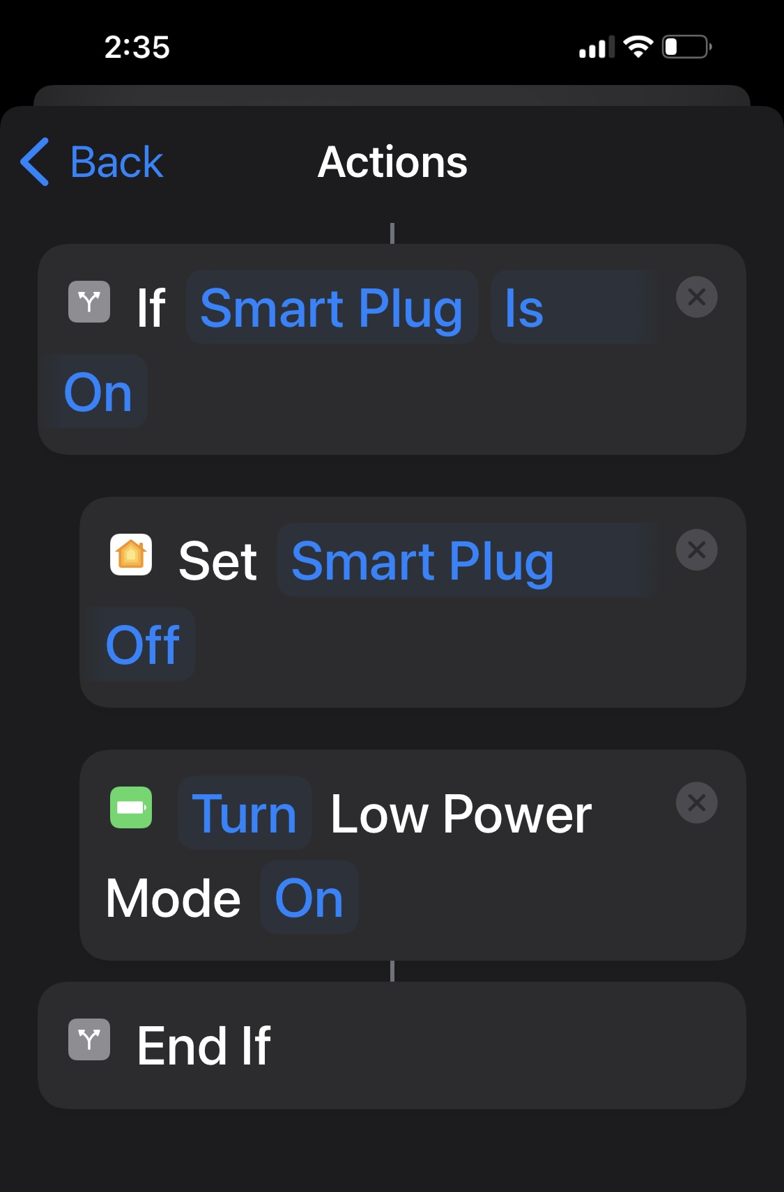

Your two arguments are asking the smart plug to do two different things at the same state of charge (80%).
Set one action to turn it off at 80% and another action to turn it back ON at 40% (or whatever)
Reactions: BigMcGuire
Actually the automation are set on 2 different state of charge:
1) equal to 80
2) more than 80
Is it correct? There should be no conflict.
I lost the notification but I’ll try to make it happens again.
Could be a good idea if I use just one automation? If I set the plug to turn off when the level rises up to 80? It should be settle at 81%, that is ok to me.
The added if-statement should take care of it.

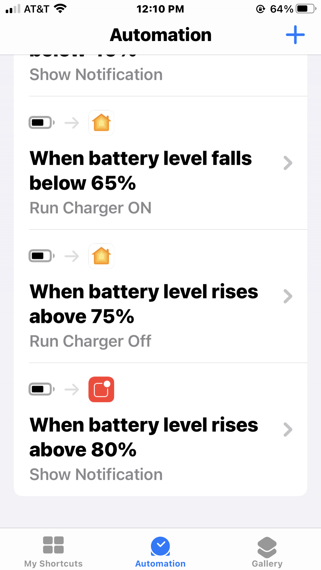

I think I know what the error message you got. If it says user does not have permission to run command. The way I fixed that is I executed the scene directly from Home app.
