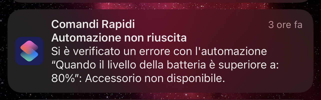

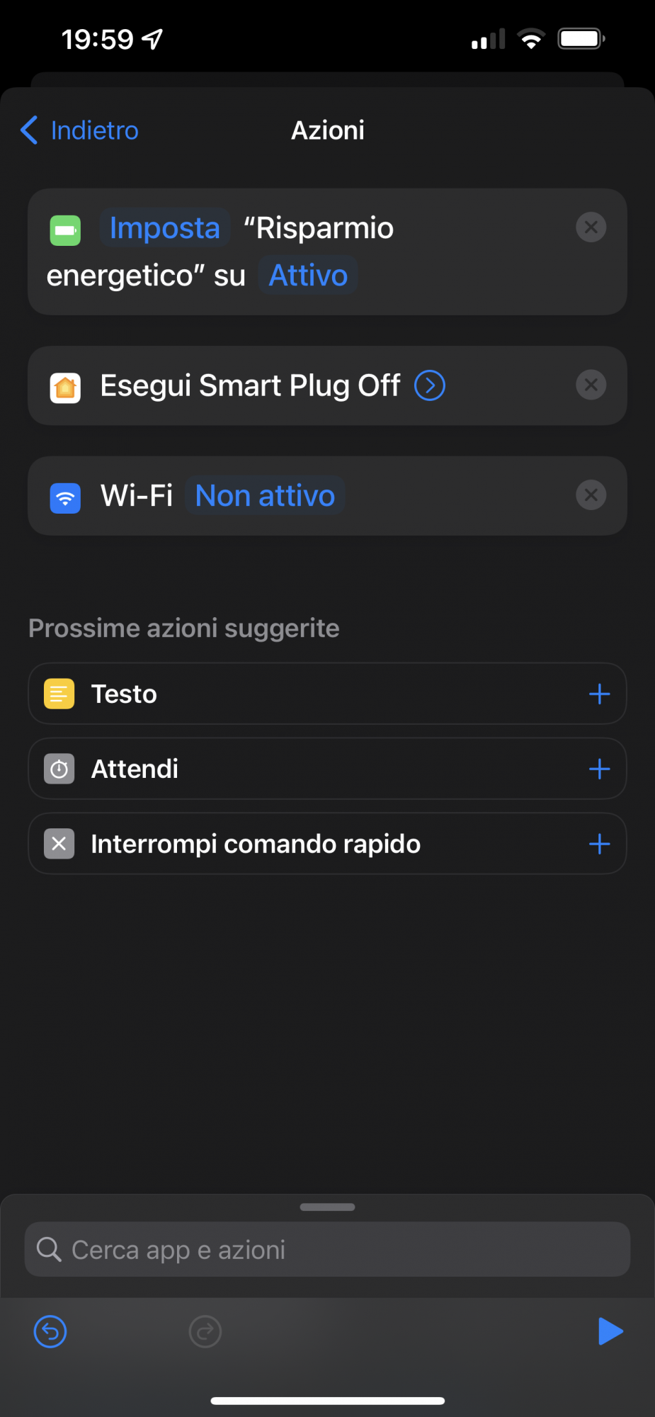

I can’t make it work.
The sequence starts correctly
.. but then

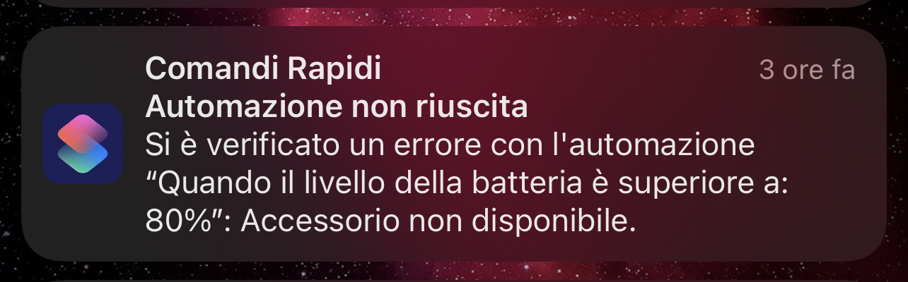

Translation:
(An error occurs with the automation “when the libel rises up to 80%”. Accessory not available).
It is not able to turn off the smart plug because it can’t find it.
I tried single automation to turn on / off the smart plug at a specific time and it works properly.
What can I do?

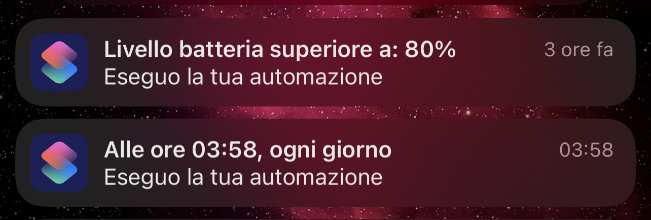

.. but then

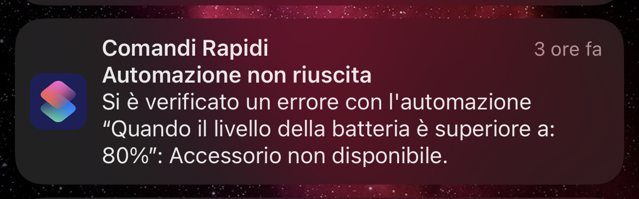

Translation:
What can I do?

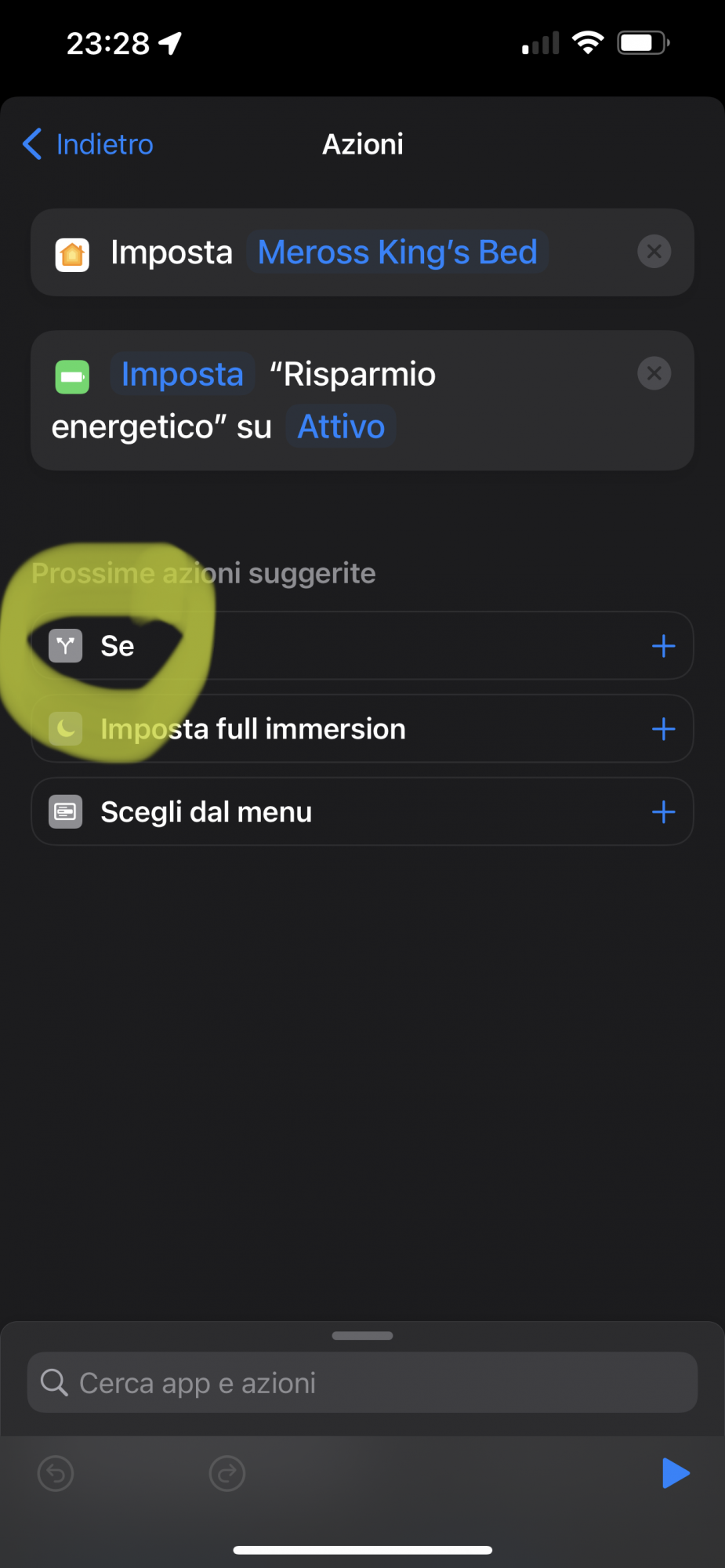

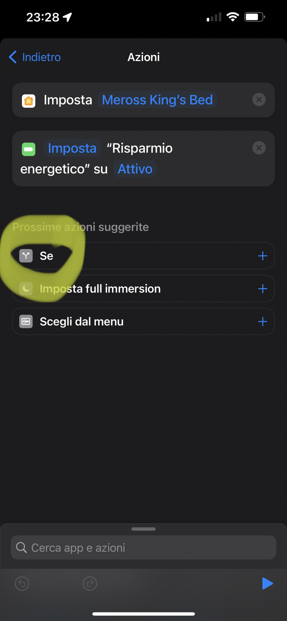

I use a Wemo smart plug. When I added the Wemo smart plug in the Home app, I renamed it to Smart Plug. You will need to use the name of your smart plug that was created in the Home app when you installed it. the easiest way to do this is:
  • In your Shortcuts Automation, select the if statement. You should see this:
if Input Condition
Otherwise​
End if​
  • Select Input.
  • In the Inout Anything menu, choose Select a Home Accessory.
  • Select the name your smart plug device.

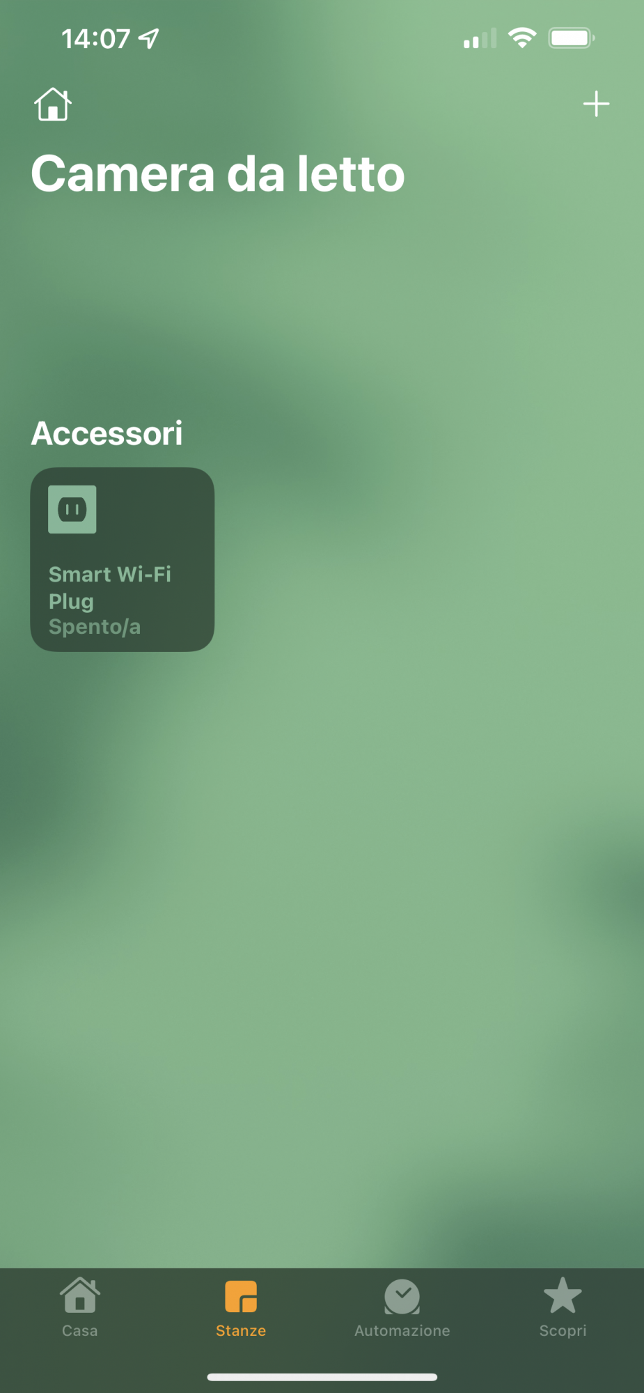

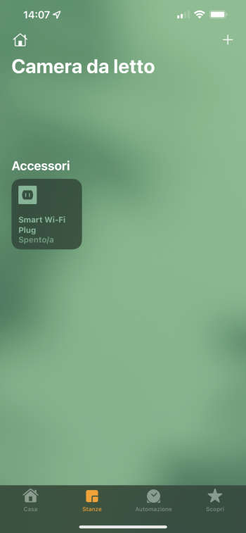

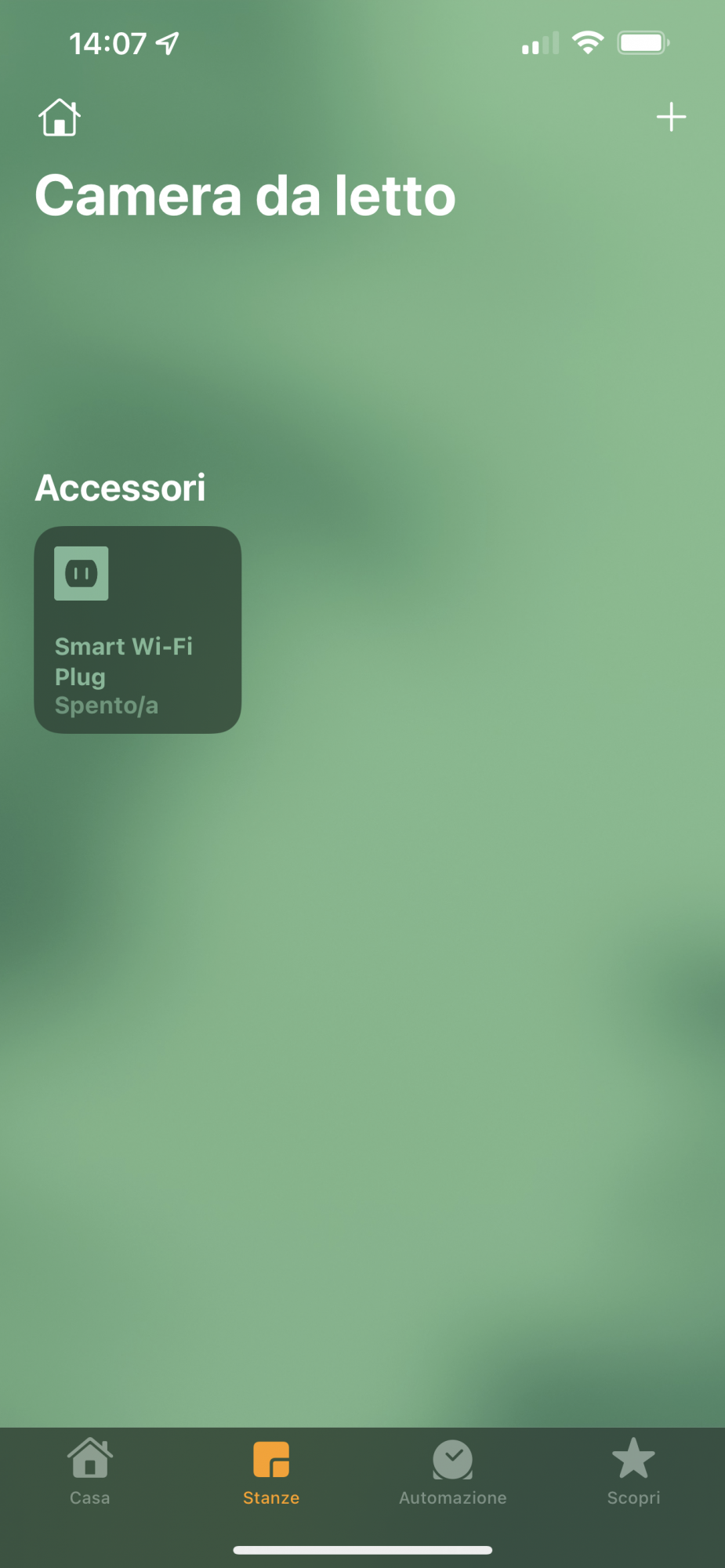

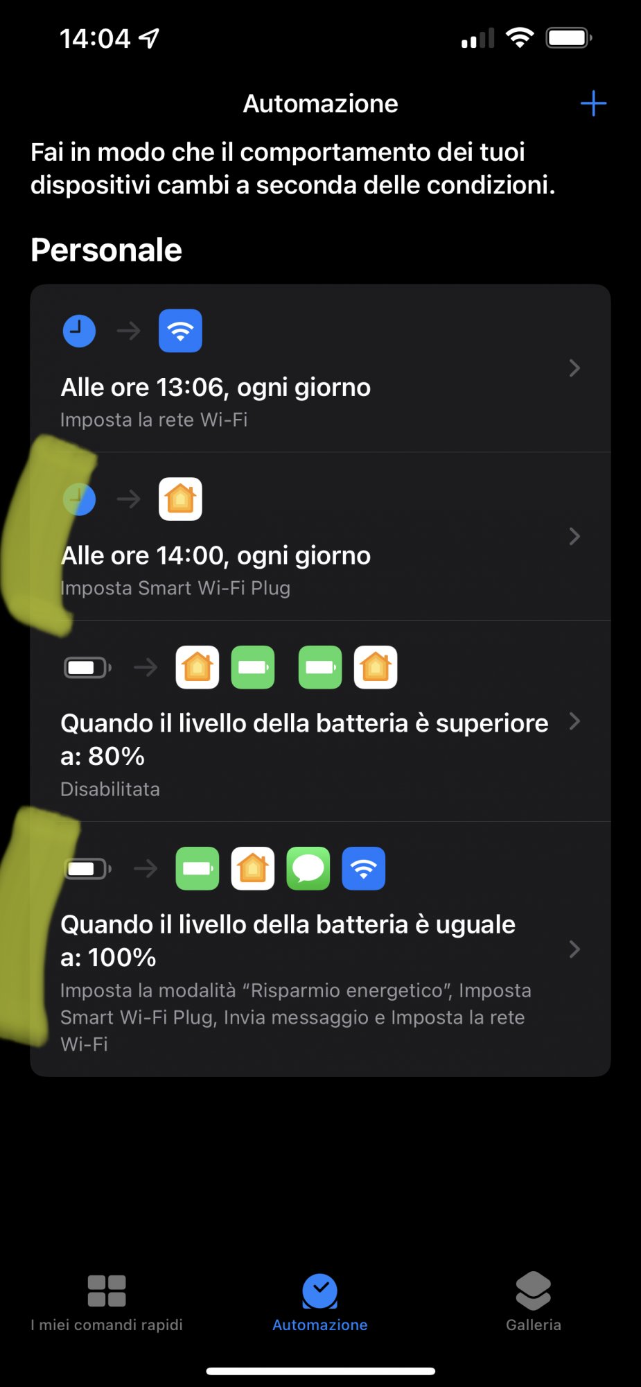

i have no scene in the home app: i turn the on the plug with an automation.

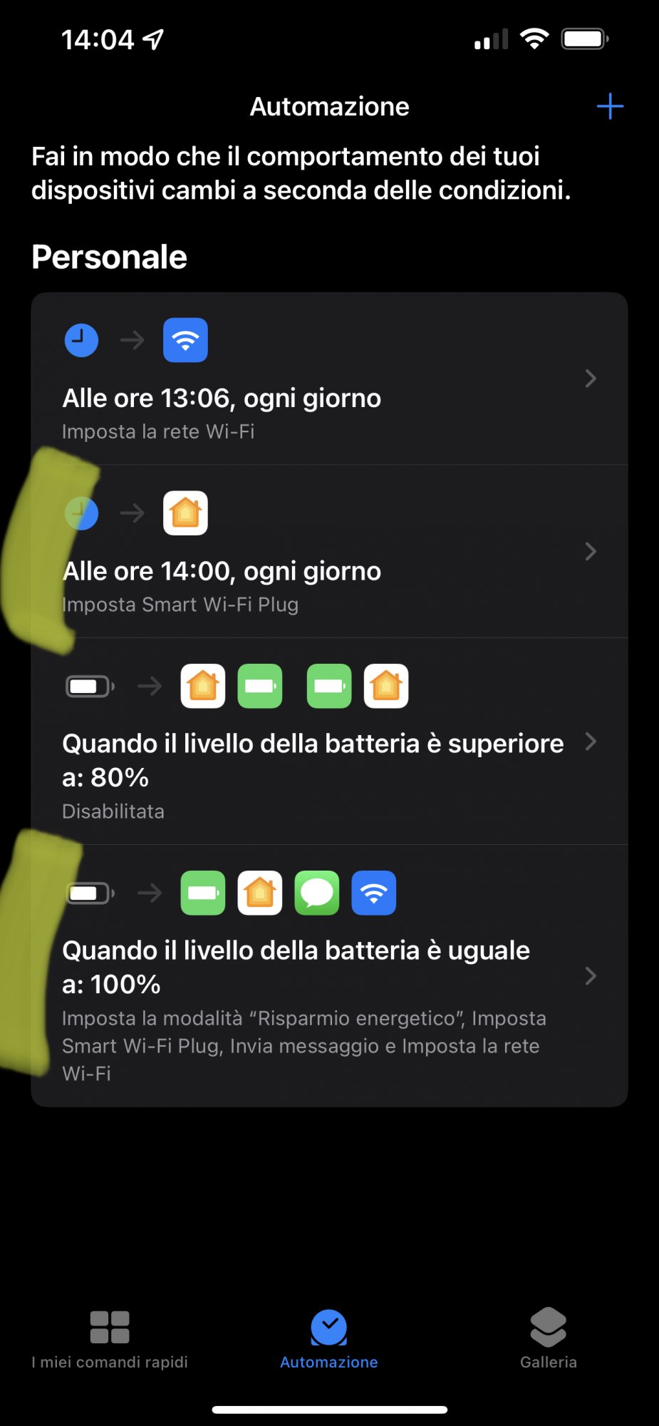

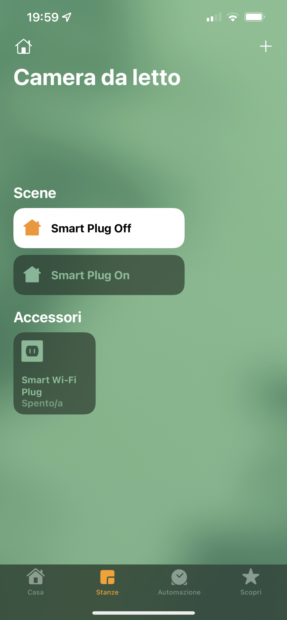

Here the screen of my home app and of the automation i am testing today.
Nice clue: i tested an automation to turn off the smart plug with the iphone plugged in (trigger; at a specific time) and it worked.2EB694AF-7513-478D-8AAE-8023791D19AC.jpeg

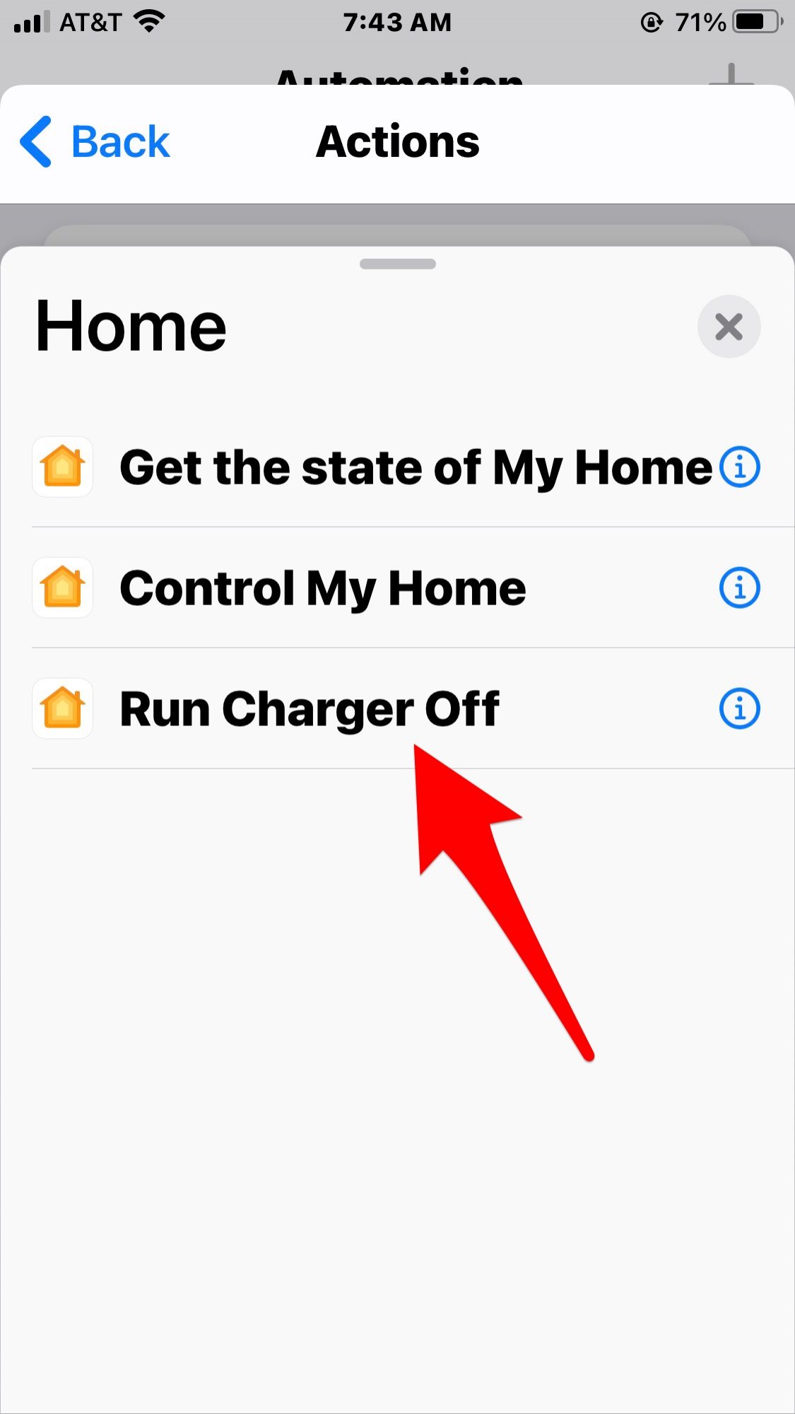

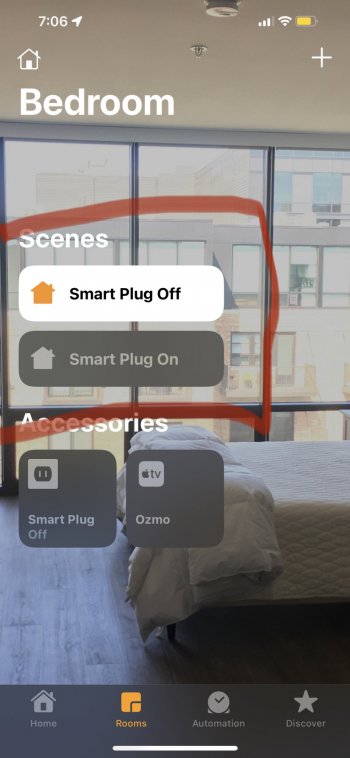

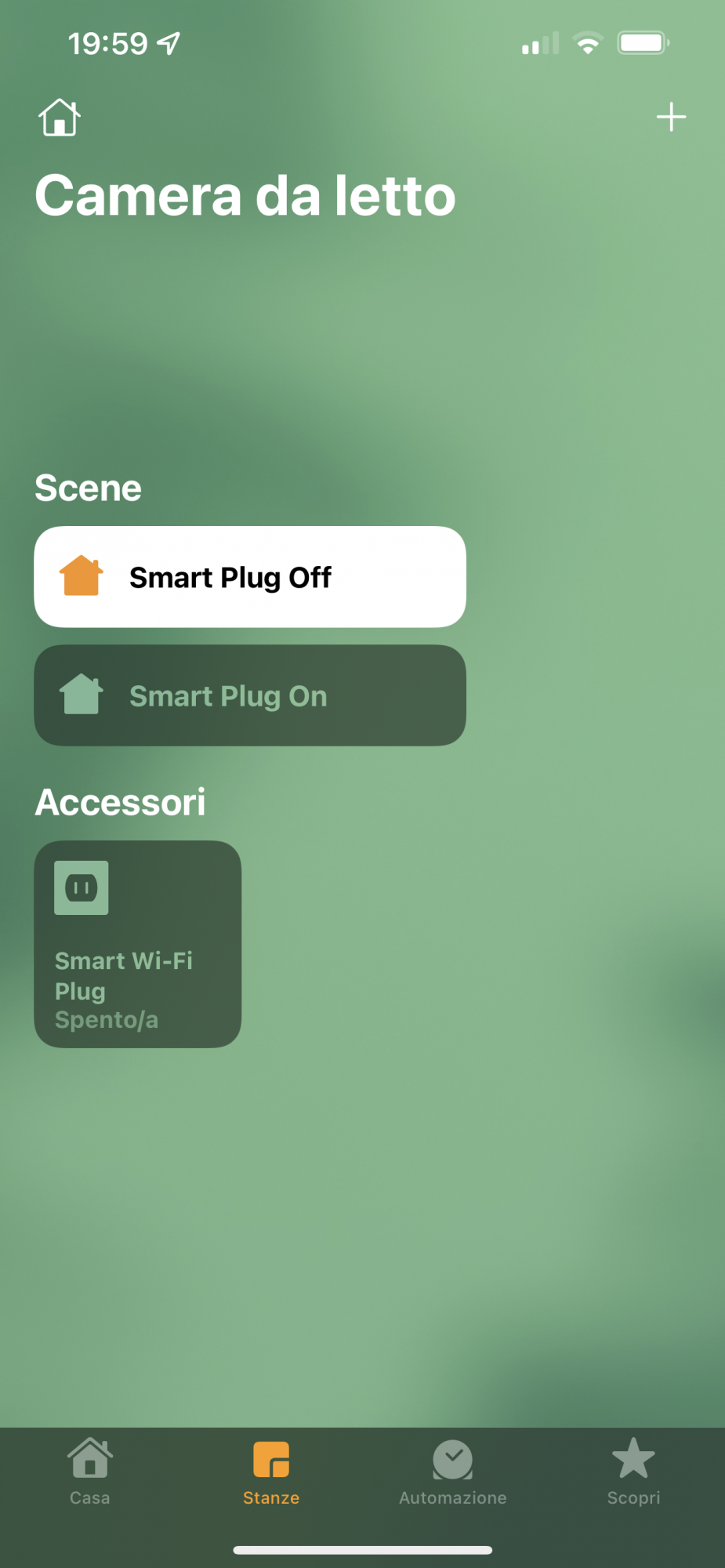

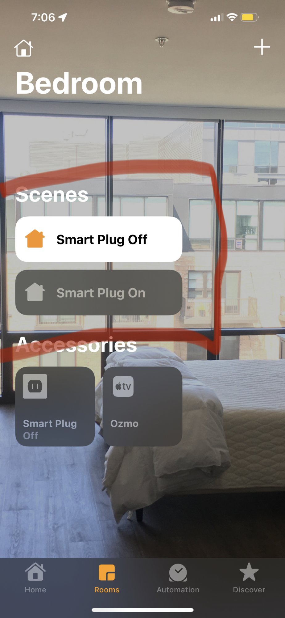

You need to create two scenes in the Home App first.
Then reference one of those scenes to turn the plug on and the other scene to turn it off.
I choose the scenes by choosing the Home App in “Apps” option then the on or off scene.
These are mine for my smart plug

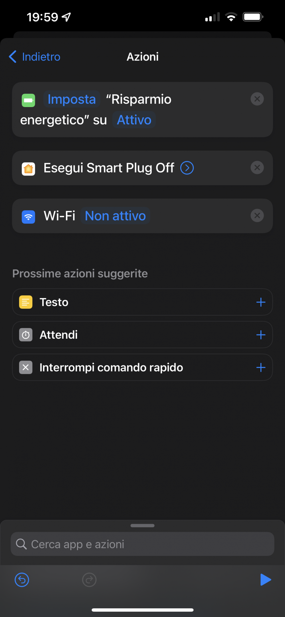

I created two scenes and put them into the automation as you can see in the screenshot.
Let’s hope it’ll work

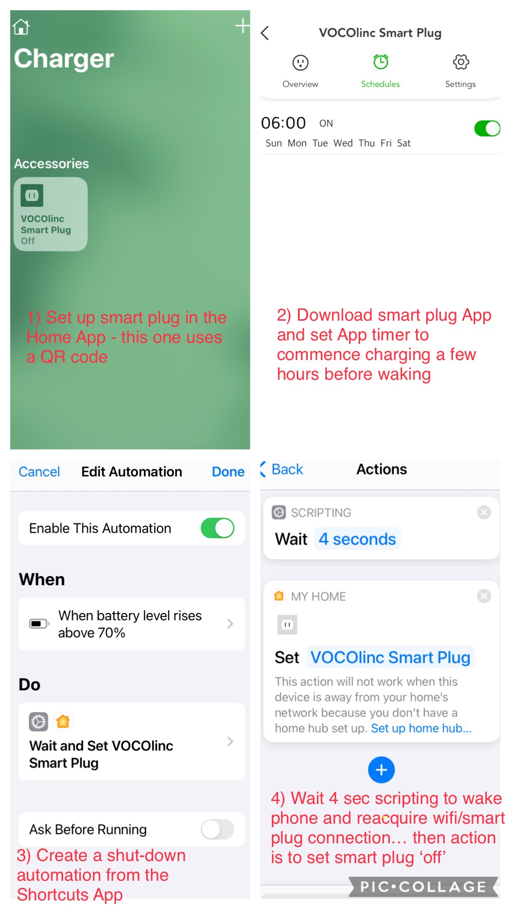

The key for this is to have a "wait" command to wake up your phone otherwise you're going to keep getting the accessory not found error. Spent months trying to figure out a fix then I found it on here, can't remember the OP but credit to them.
So in "search for apps and actions" just search for "wait" and set it to whatever, I got it at 5 seconds, then have your Homekit action.
Mine looks like this:
Wait 5 seconds
Set Smart Plug
Wait 5 seconds
Set Smart Plug
I have an extra set of redundancy just because I struggled with the "accessory not found" error for a very long time lol.
Found it. Credit to @reppans You can ignore step 2 if you would like. Really what you want out of this is just the "wait" script in step 4.

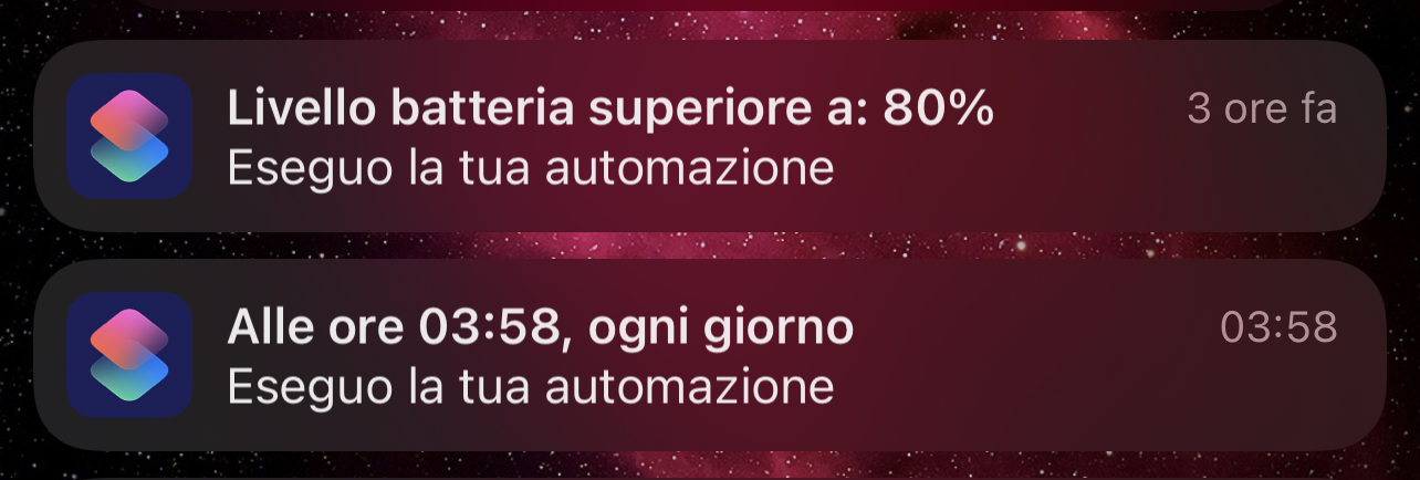

Unbelievable.

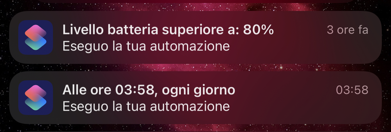

Even this night the automation failed.
It wasn't able to turn on the plug.
I added the "wait" option just in the main action on the level rises up to 80, but probably i have to add the "wait" option in EVERY automation before the main one.
Now this my #15 revision set 😀
action 1
at 4 a.m, > wait 4 sec + turn on wifi on
action 2
at 4 a.m, > wait 4 sec + run charger on
action 3
at >80% > wait 4 sec + power saving + run charger off + turn off wifi
This thing is driving me nuts!!
If this works ok, otherwise i'll retun the plug and roll back to optmize charge on iphone i think 🙁
