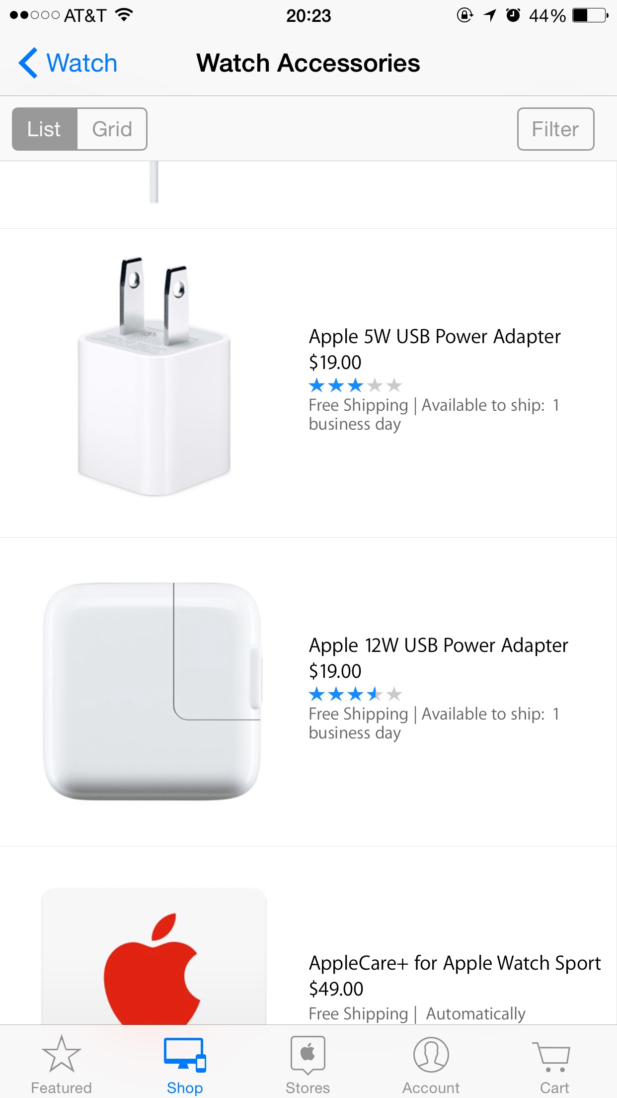

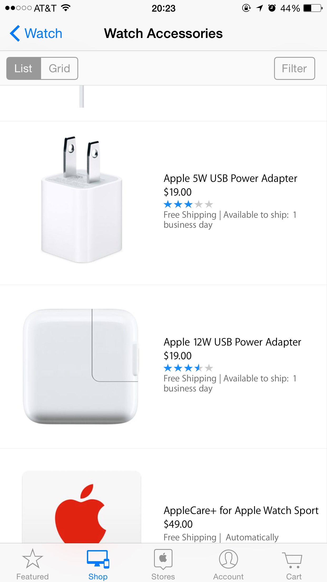

Well Apple is selling both the chargers in their accessories section for Apple watch. I'm pretty sure it won't impact your battery life and give you a quicker charge option like in case of iPhones
Pretty sure you can charge with either brick but the charge time will be the same.
