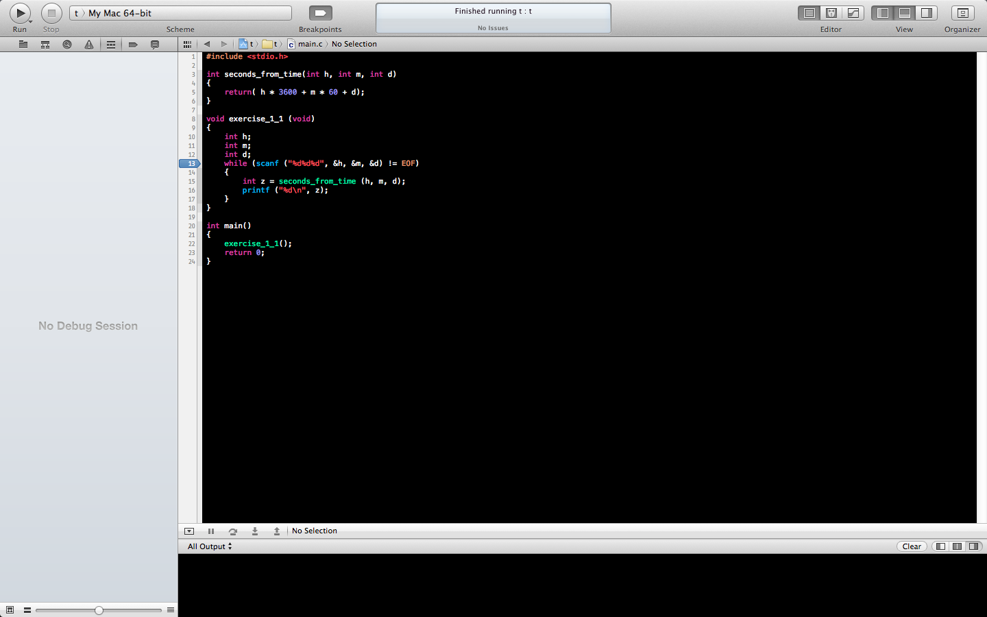

i am not an expert in xcode because i start using it maybe 1 month ago, but until this problem everything is ok, anyone can talk with me by skype? it will resolve the problem in 1 minute because i can show you some pictures....

this image is not mine, i said if i have this image it will be easy to find the values of variables in the stack strace, but i dont have this.
I posted a simple code above, and i want to share a simple image to show you, what i have in my xcode.
Can i send you a image via email, or other way?

The picture helps.
In the "debug pane" you're only displaying the "console".
See the "clear" button in the "debug pane"? Their's a group of three buttons next to it. Press the center button and your variables sub pane will display what you're wanting to see.
